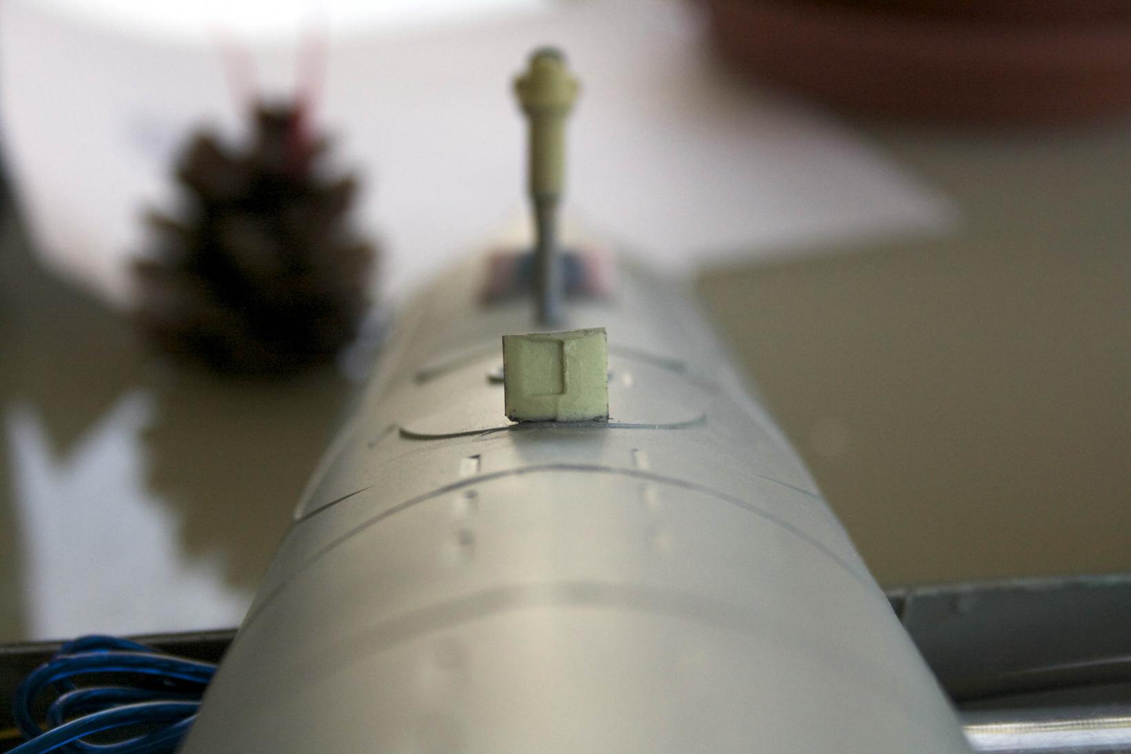

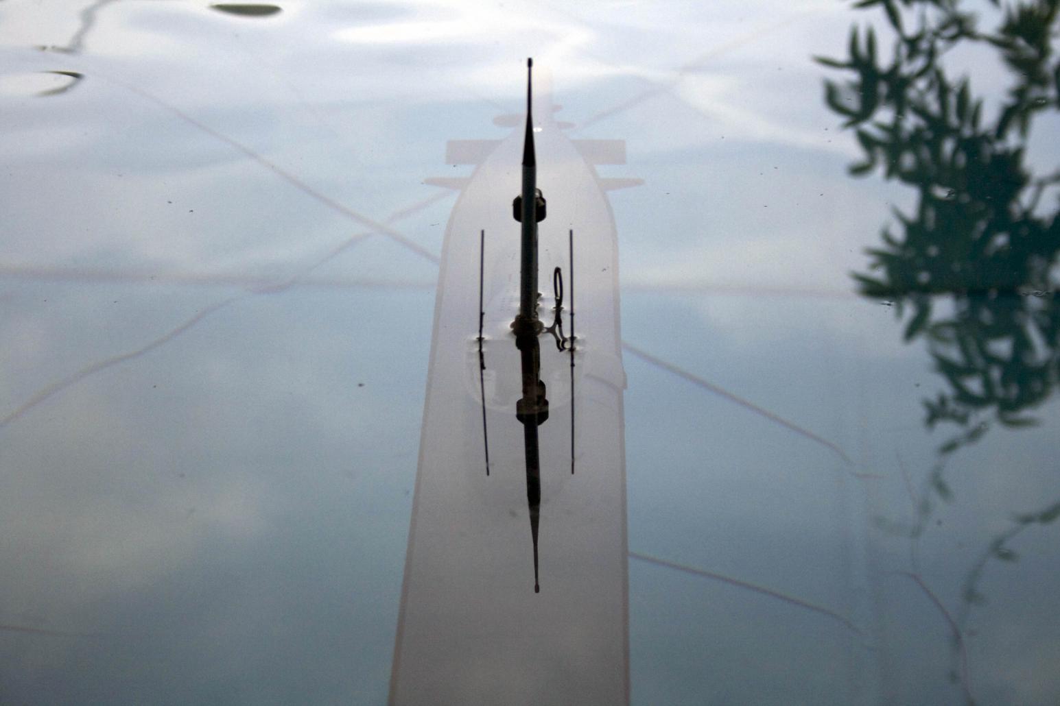

    I went ahead and replaced the receiver with another Wfly one, one the antenna is not cut and using the external antenna.
    The sub is a little heavy in the aft and would not empty that last bubble in the bow.
Name:	Bronco Type 23_318.jpg
    Here is is submerged after I got the bubble out. It was still a little bow light. Just a smidgin.
Name:	Bronco Type 23_319.jpg
    I like the height of the tower out of the water.
Name:	Bronco Type 23_320.jpg
    There was a list to port side. Placing the weight on the starboard side, the hll was level. The tower was still tilted. I need to redo the mounting block.
Name:	Bronco Type 23_321.jpg
    A little tug and the block came away cleanly. Butting it back on was not as easy and I opened a hole to apply CA to affix the mount.
Name:	Bronco Type 23_322.jpg
    Once everything dried, I set it in to test it. The tower is upright and the hull is level.

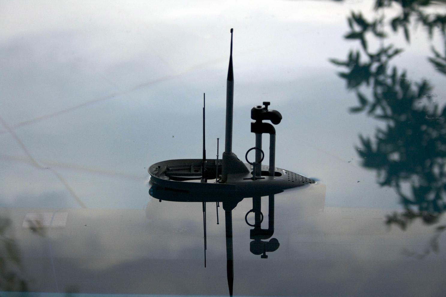

    Sitting this low it is one bubble from sinking of going negative buoyancy. So a slice of foam is added to bring up the tower a bit.
Name:	Bronco Type 23_326.jpg
Name:	Bronco Type 23_327.jpg
    There is a little room. Not sure if it is enough, but for now I will test it and see.
Name:	Bronco Type 23_328.jpg
    On the surface, it sits were I like it.
Name:	Bronco Type 23_329.jpg
    Once the foam is set. Another test and then the pond.
