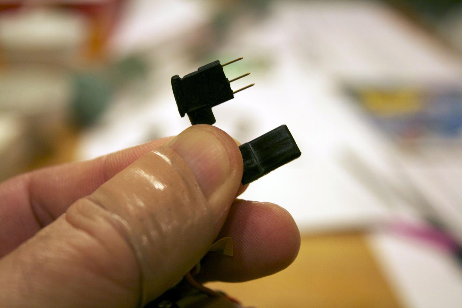

          Jay, Your build coming along great! Thank you for the encouragement on the search for foam. I will keep looking for the pink stuff. So far it looks like around here, everything is the fiber insulation. Yes, I have begun playing with the radio. Do you know what I learned? Things change (can you believe it?). My receiver (Futaba) has G type plugs.
          G to the left, J to the right. The radio works great with the modifications I did. My old batteries were long gone, but I modified my TX to hold a newer battery pack (with AA rechargeable batteries) and the RX (for testing purposes) is using a battery pack with rechargeable AA batteries.
          The new servos and receivers use J type or JR plugs. So I have choices. I can buy J pins and connectors and cut the cables on my old servos to use the J plug portion (cheapest, but time consuming) or buy pre made cables to convert the new G servos to J receiver (most expensive, but not time consuming) or a combination of buying G plug pigtails and J plug ends. All have pluses and minuses. BUT wait, David or Mike, will the SL-8 work with my old Futaba?

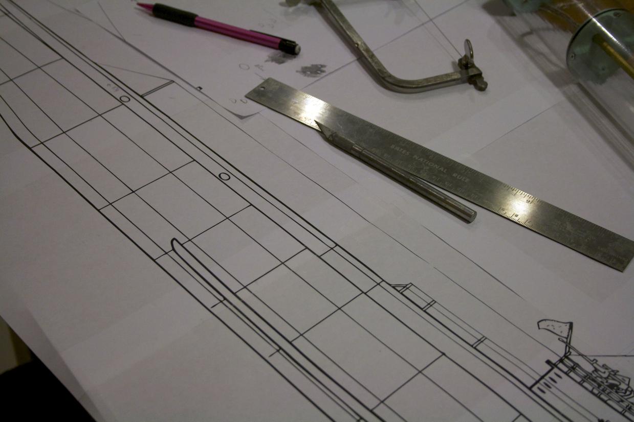

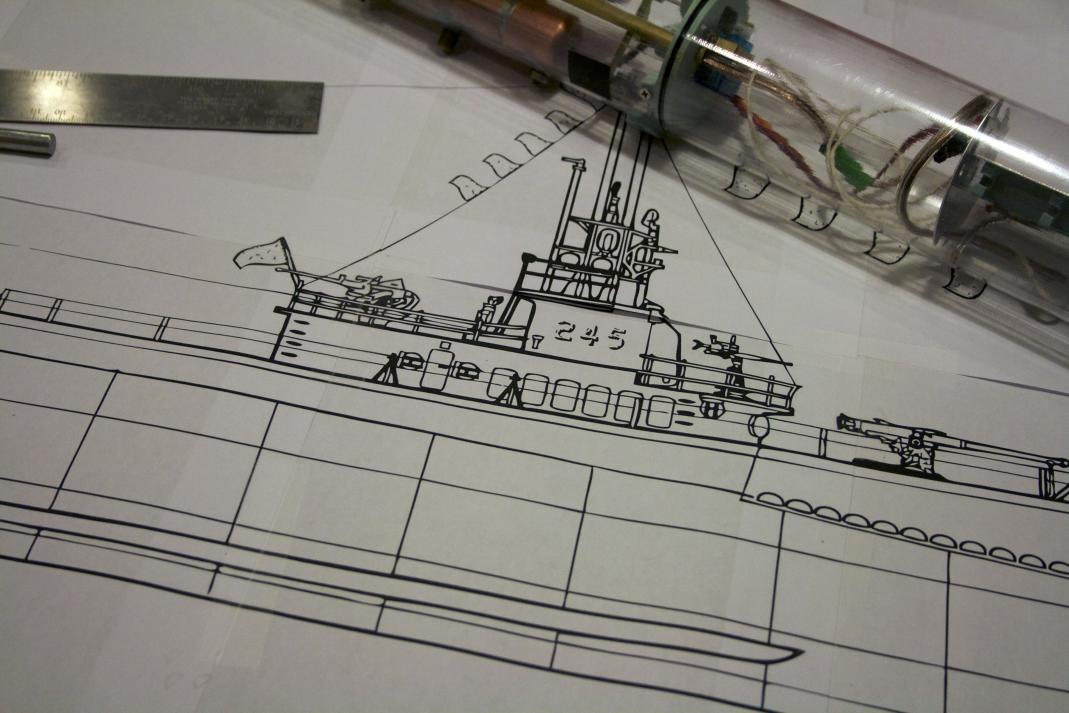

          Not wanting to let the build be stagnant, began some details on the hull (I will post at a later date). I did rescan the line drawing in the Revell instructions to a higher resolution, and cleaned it up.

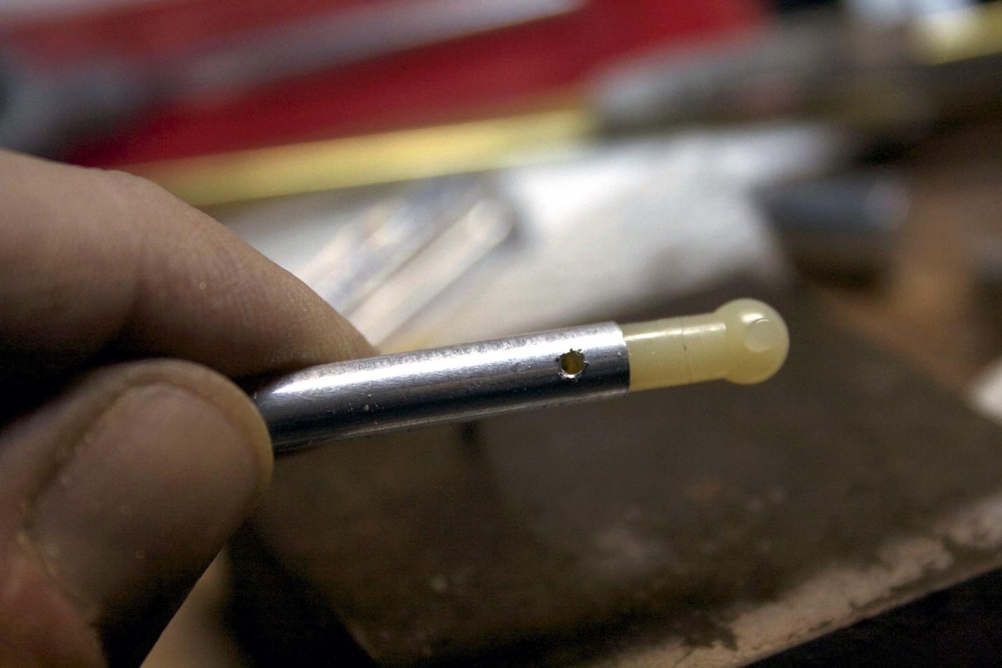

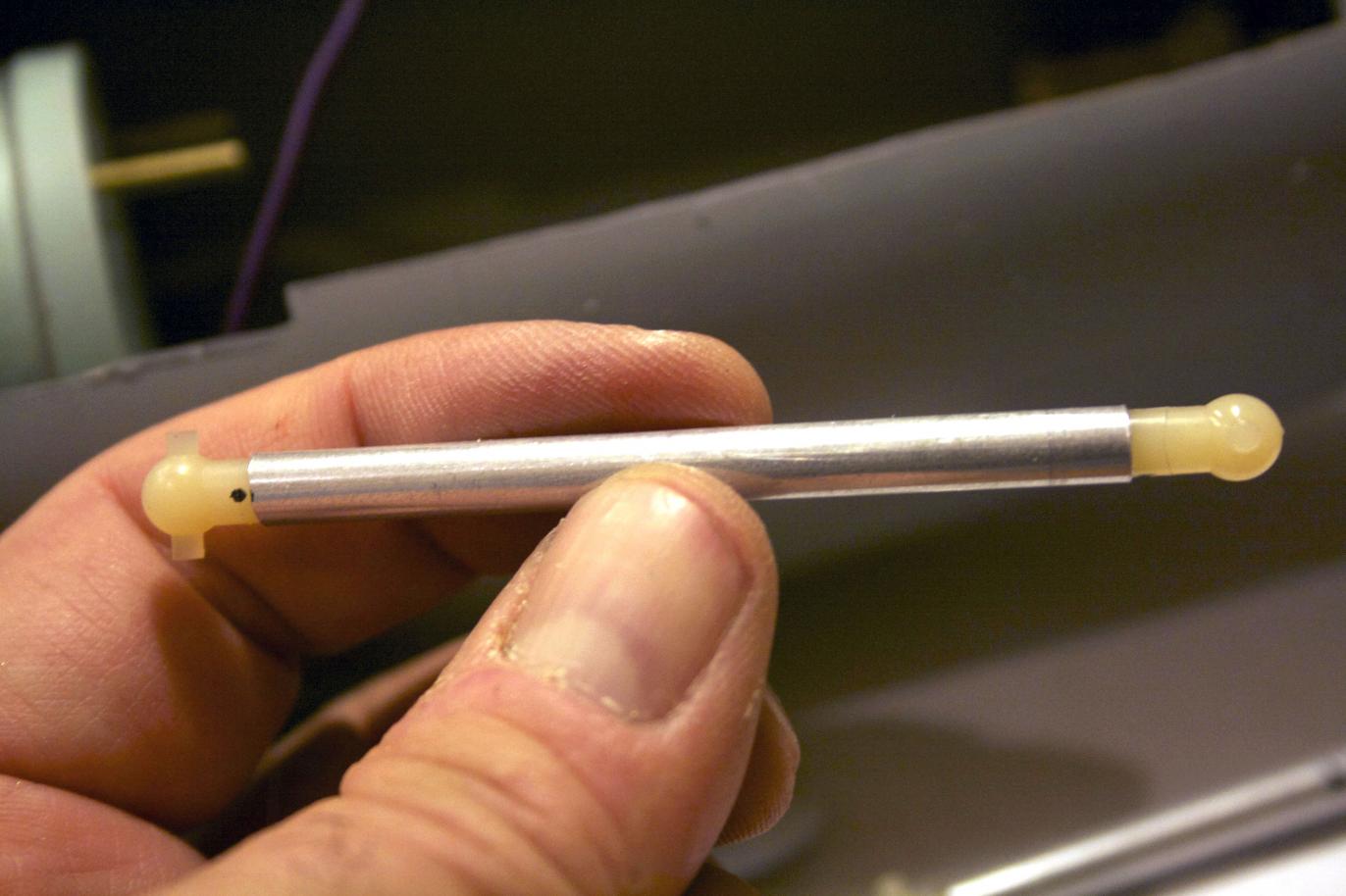

                    There is a feeling, I cannot express adequately, when I came to this point. The connecting of the Propellor shaft to the WTC. I hope this feeling happens with every sub I build. I will AGAIN mention get the DVD by David. He goes through this step so well! I am doing it only because of what he teaches.

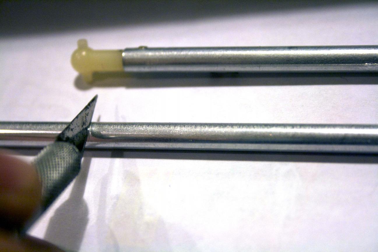

                    Take a measurement between the end of the propellor shaft’s Dumas coupler and the WTC Dumas coupler. Cutting the aluminum tube is so simple. Who knew? Yes, I know you did. All I had to do is roll the edge of my x-acto along at the point I wanted my cut, and bend. It snaps at the place it is scored.
Name:	Propellor Shaft_001a.jpg
                    Cut the nylon Dumas coupler in half, insert one half in each end, and test the fit. It will look something like this.

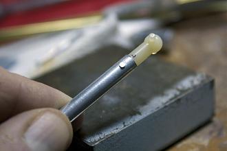

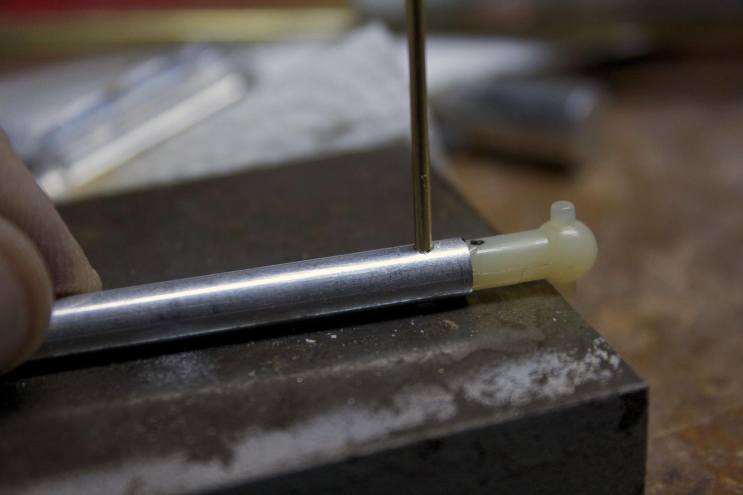

                    Next using 1/16” bit, drill through the tube and nylon coupler.
Name:	Propellor Shaft_003a.jpg

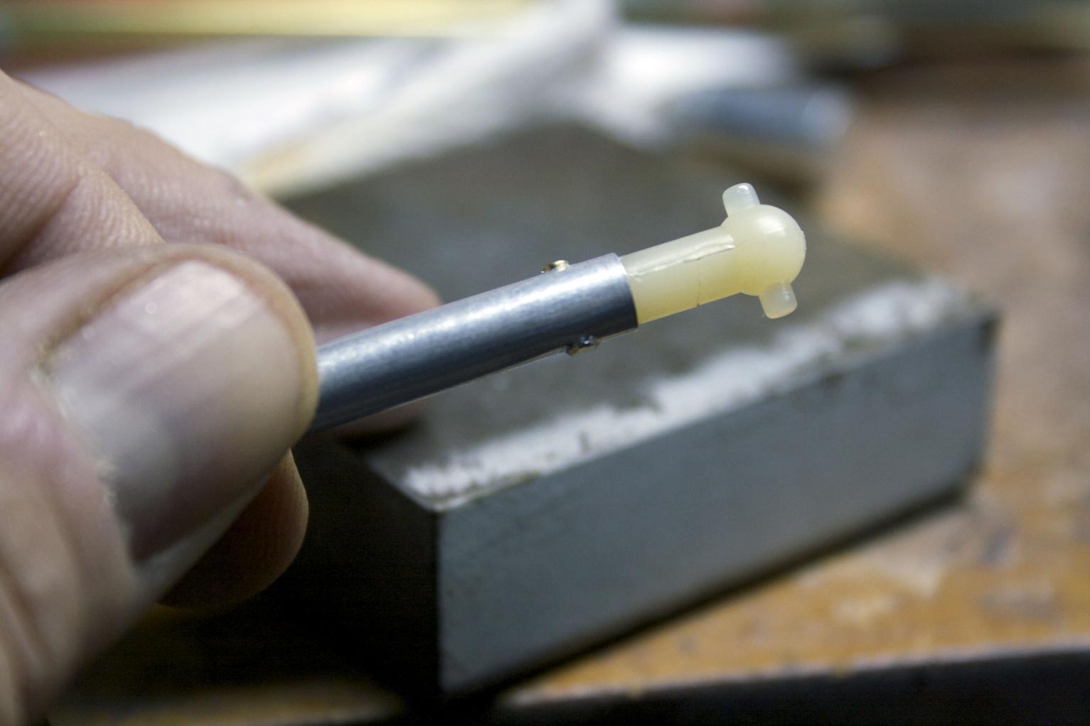

                    Tap a piece of 1/16” brass rod through your newly created hole.
Name:	Propellor Shaft_004a.jpg

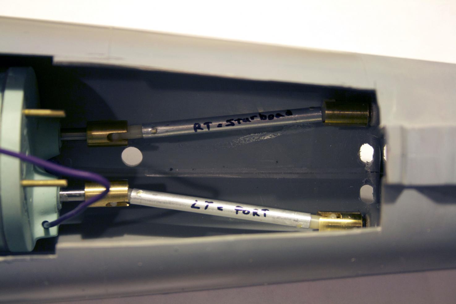

                    I trimmed the ends close and hammered it down using a jeweler's hammer. The black marking was used to make sure the end did not shift prior to being drilled.
Name:	Propellor Shaft_005.jpg
ID:	65524Click image for larger version
Name:	Propellor Shaft_006.jpg

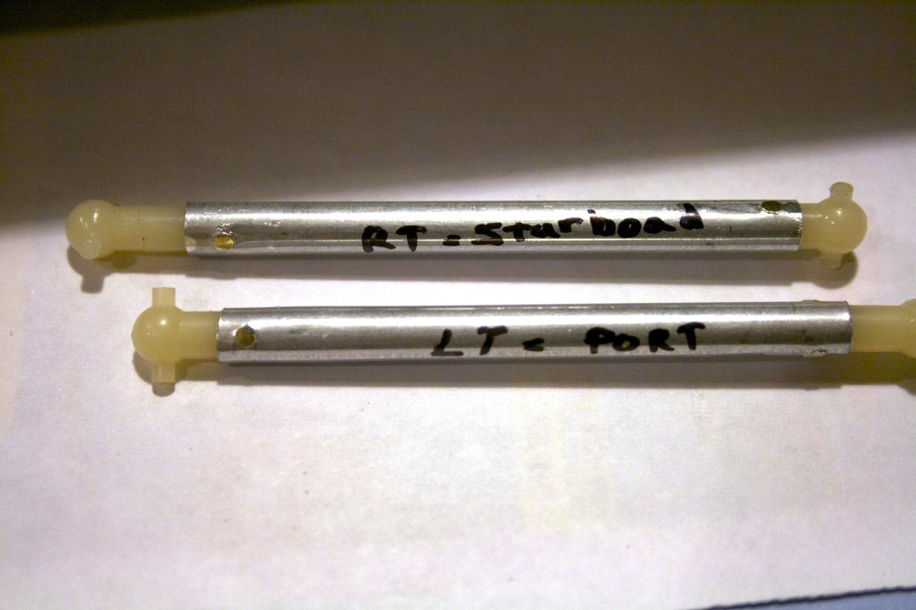

                    Two shafts ready for install.

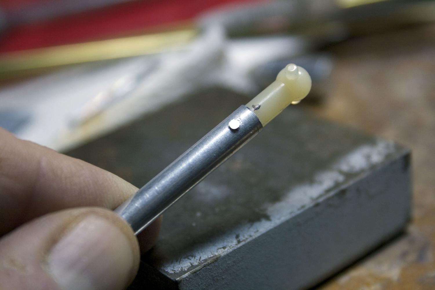

                    And of course, here they are installed.
Name:	Propellor Shaft_008.jpg
