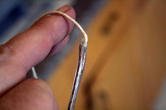

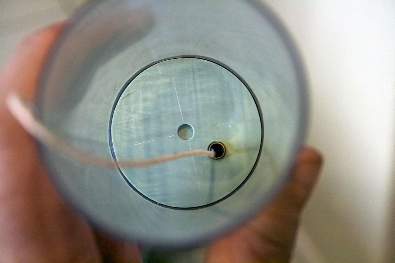

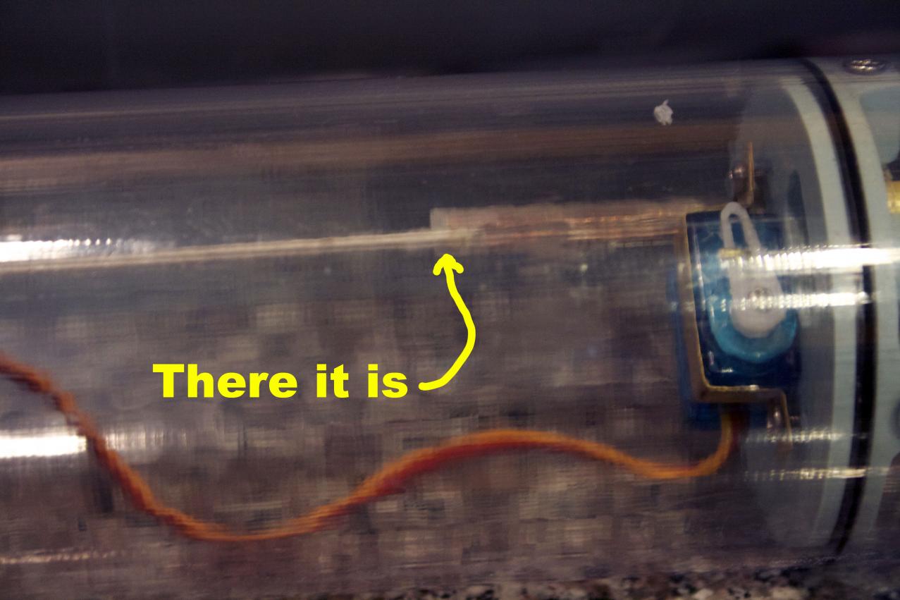

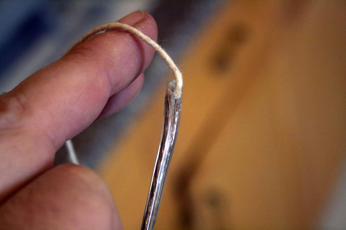

                Beeryboats, I am sorry, I should have posted this awhile ago. Here is how I strung the main power wire through the WTC. I may re-do this and use a different wire because I may want to run a servo or a secondary mini SNORT from the battery compartment and there is not much room once the wire supplied is installed.
                It was Thanksgiving and my wife left the string out for tying up the turkey. I took that opportunity to snag a length of it. I tried to tie the string to the wire and pull it through, but that would not work. So I CA'd the string to the wire to keep the diameter as small as possible.

                Since the string is much smaller, it went through with a little shaking, twisting, and jiggling.

                Then using the string to pull and some long nose pliers to push the wire came through.
