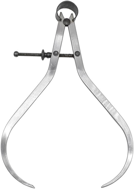

      An outside caliper will get in the groove for an accurate measurement. https://www.amazon.com/Big-Horn-1905...015YHDUU&psc=1
