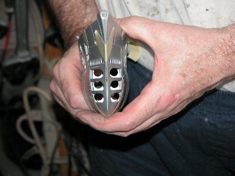

    Just received the notice on the torpedo firing system. I haven't started my Gato yet but I thought I would start a discussion. There is a modeler on the RCGroups Gato build that has done a great job on articulating the shutters. If the David Merriman torpedo system will work with the articulated doors it will be a spectacular addition to the model. If anyone is going to implement the torpedo system please add your ideas to the discussion. When I start mine I will be adding the torpedo launch system. It seems it would be a good idea to get some of the mechanics in while the nose section is still off the model.

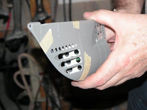

      This is the link to a very nice Gato build. He has the details of the torpedo shutters in the thread.

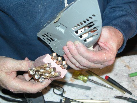

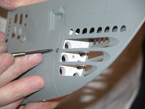

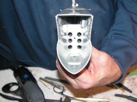

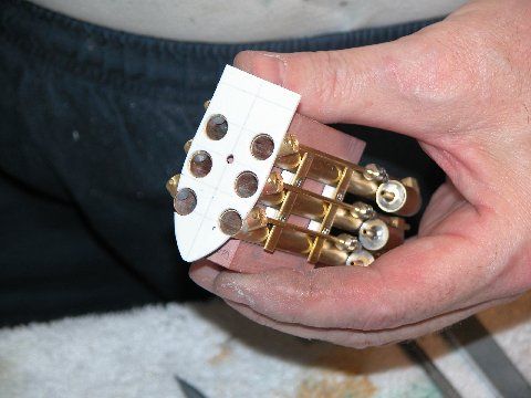

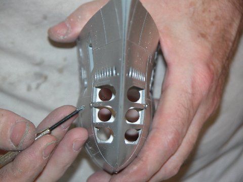

        Attached are pics of Davids Torpedo tube installation in the Gato.

                      No. Beta testing of some launchers in the field has been completed and there are going to be some changes to the launcher sub-system -- just as soon as those fixes are incorporated into the tooling and manufacturing process we'll publish the material in the catalog. Hang in there, we want to get this right, not fast.
                      The forward and after torpedo tube installations for both the 1/72 Revell GATO and Type-7 can be performed with the entire hull sections assembled, so go ahead with your work, and when the torpedo launcher fittings kits become available, you'll be able to drop the tubes in there without the need to tear anything up.
