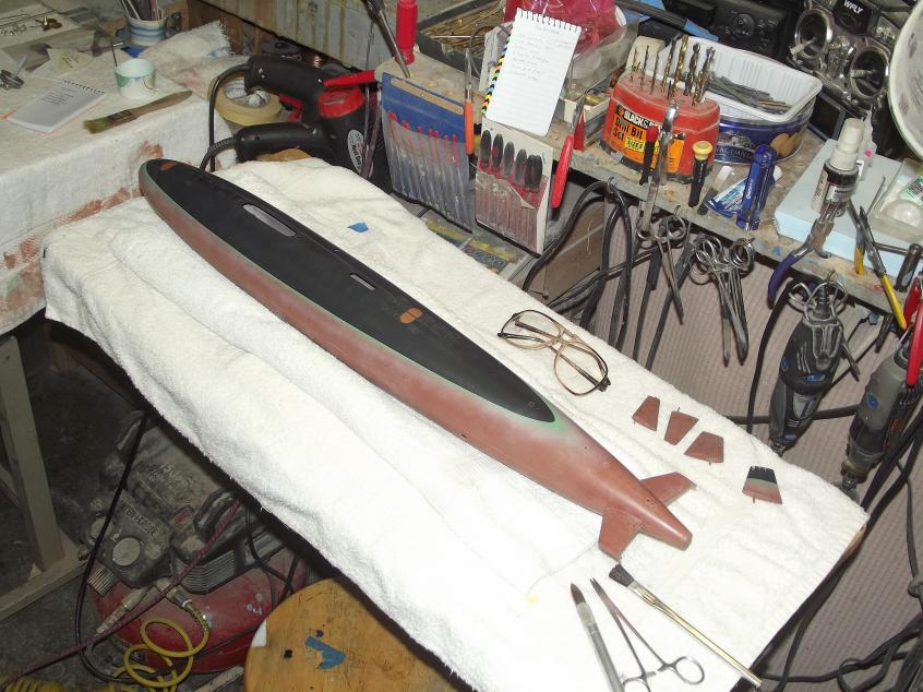

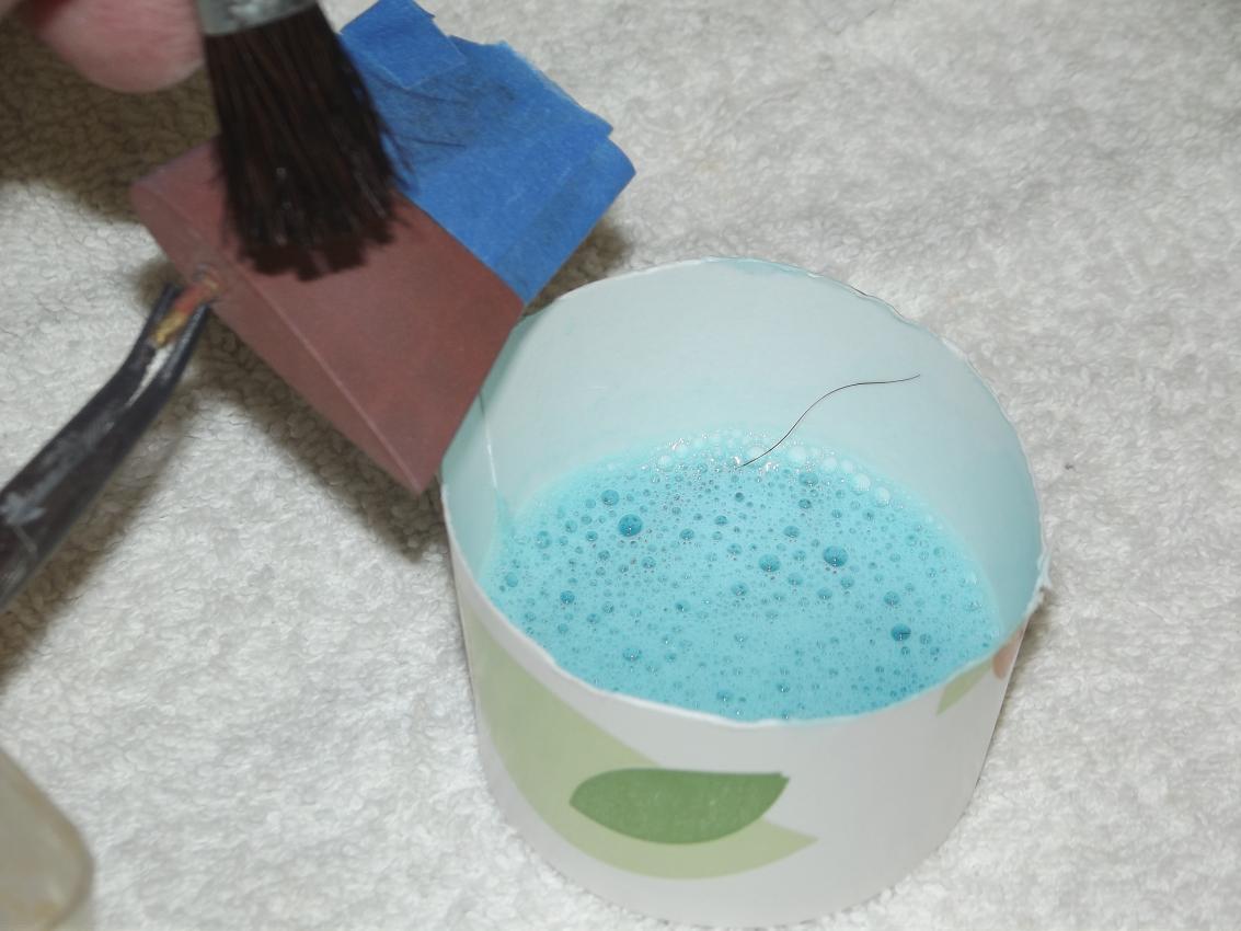

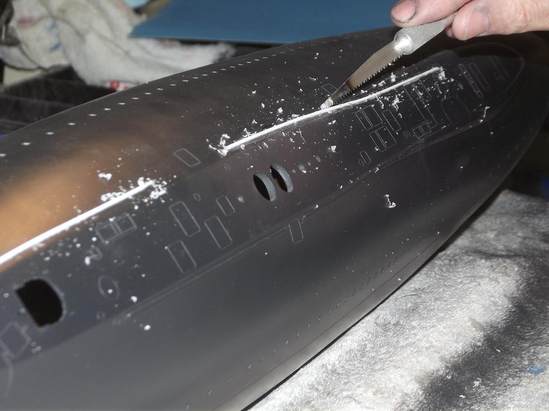

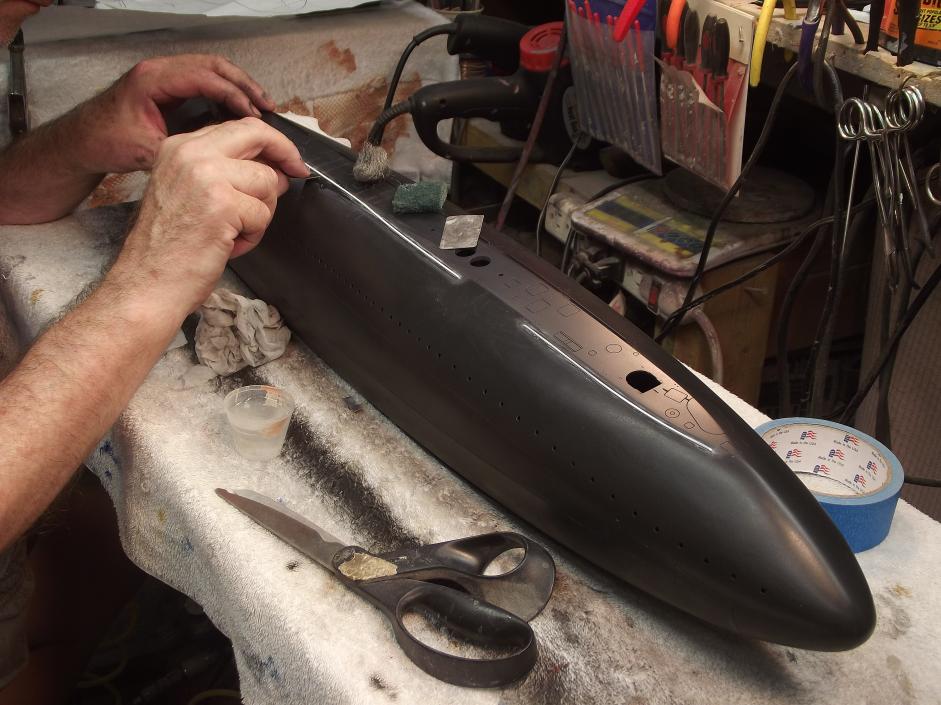

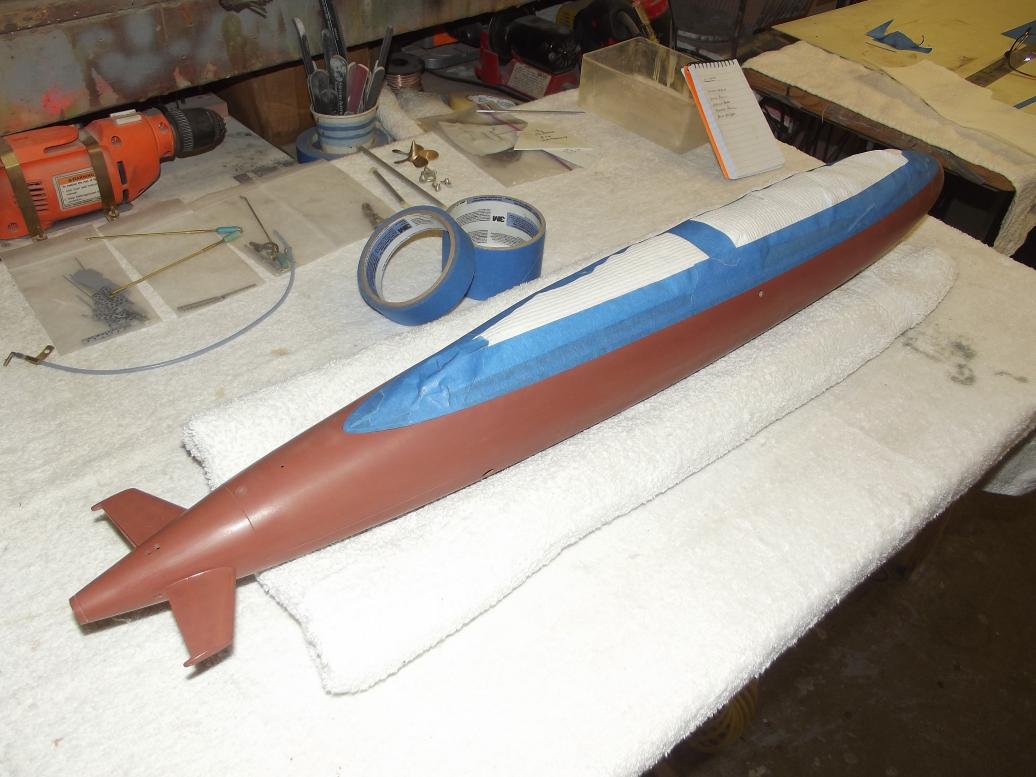

    Using tooth-paste as a masking agent to achieve the look of mottled bleaching below the waterline:
ID:	91302Click image for larger version
ID:	91303Click image for larger version
ID:	91304Click image for larger version

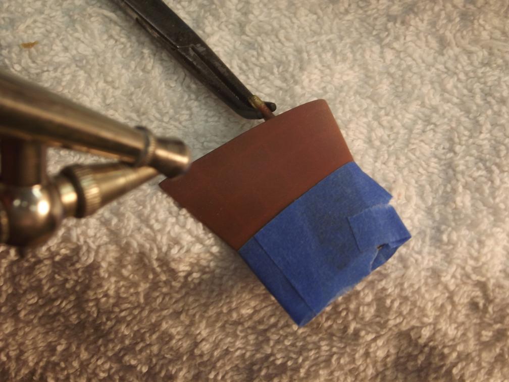

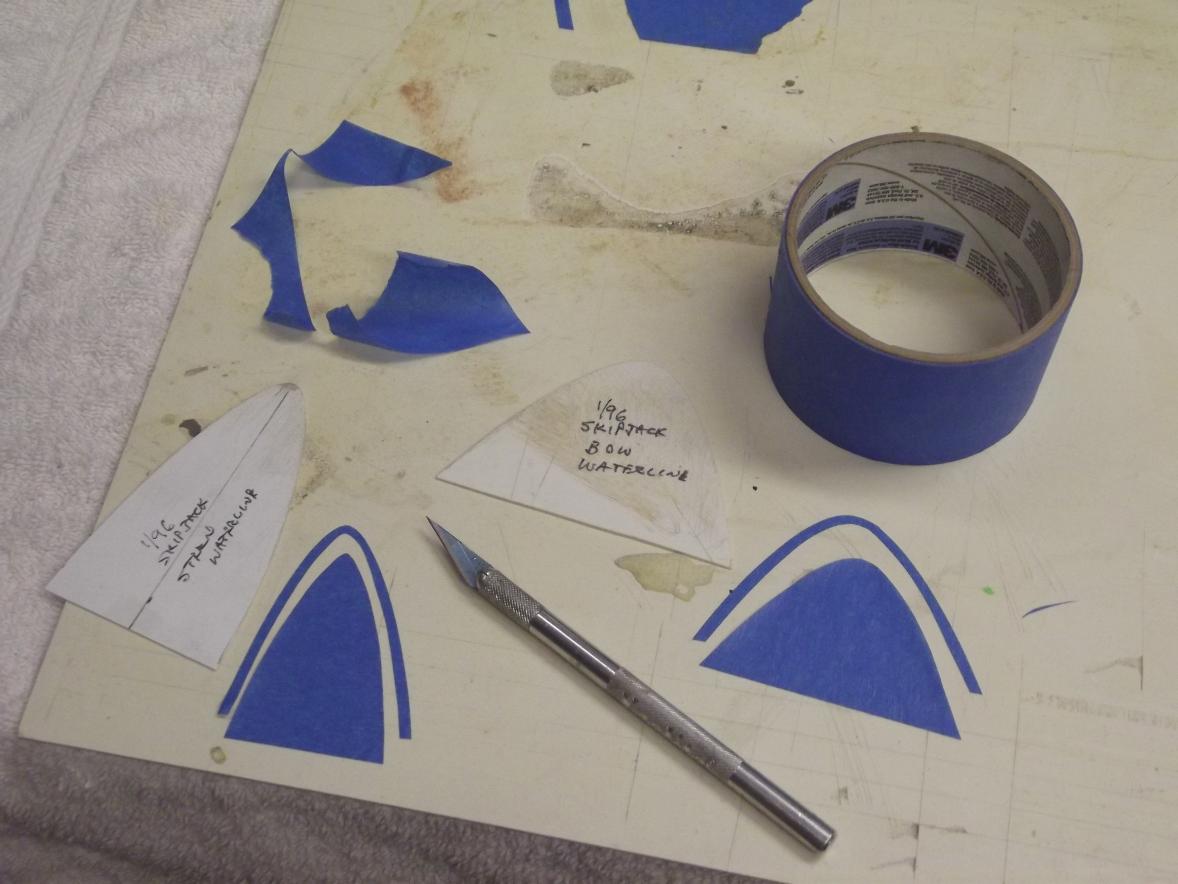

    First task was to take my ready-made 1/96 SKIPJACK mask cutting stencils and use them to cut out some masking tape needed to protect the deck area. This was backed up with paper towels and more masking tape. Now I can lay down the tooth-paste mask and mist on some white to represent some ragged looking bleaching of the lower hull and all appendages beneath the designed waterline. The upper rudder gets the same treatment.

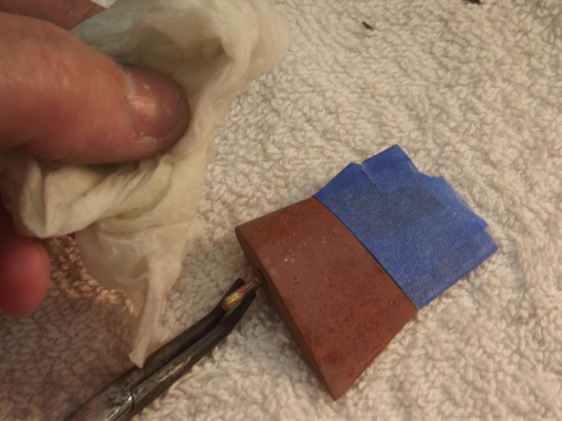

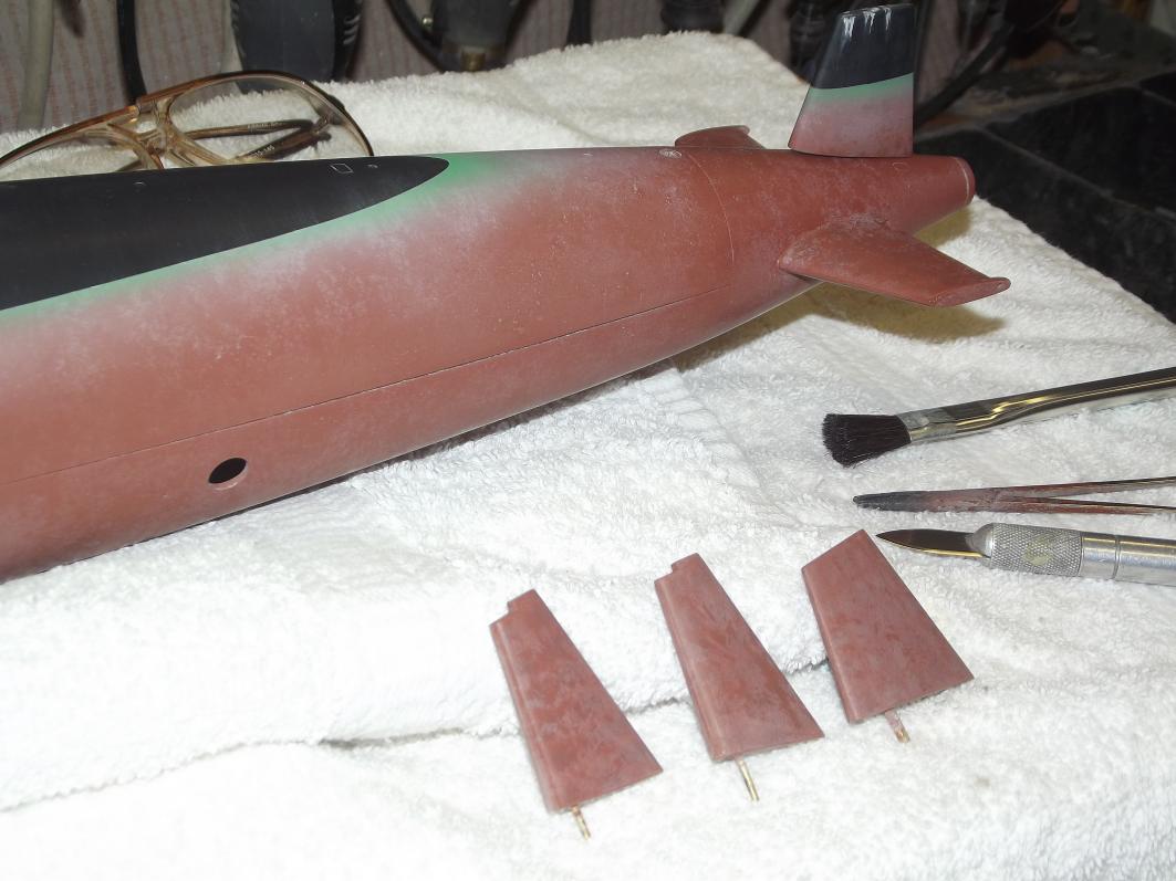

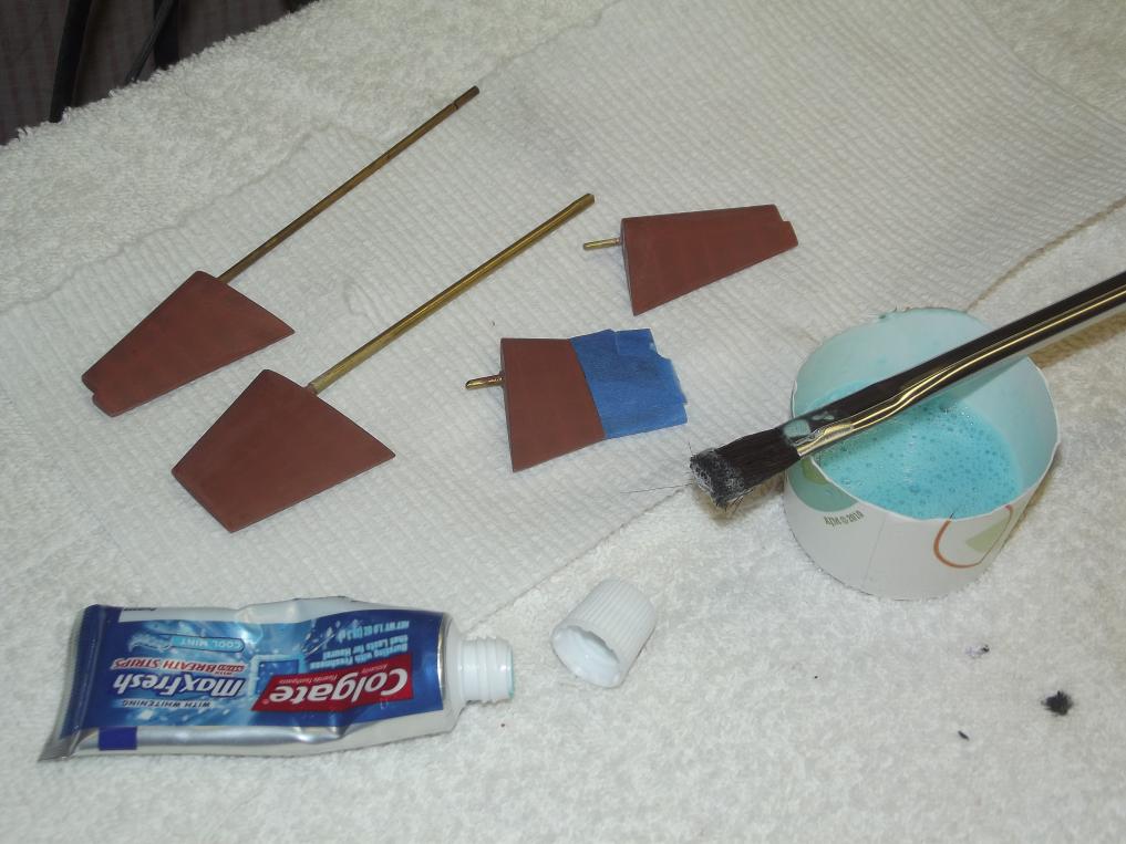

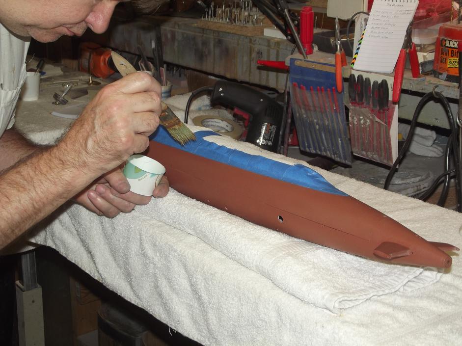

    I take some tooth-past, cut it with water and, wa-la!, I got a brushable masking medium. The sugar based (water-soluble) mask is stippled onto the model surface, left to dry, then a mist of white is laid over the work. Once the white has dried, I wet the surface, the sugar vehicle of the mask melts, and the sticky goo is blotted off the model leaving the mottled look I'm after.
ID:	91311Click image for larger version
ID:	91312Click image for larger version

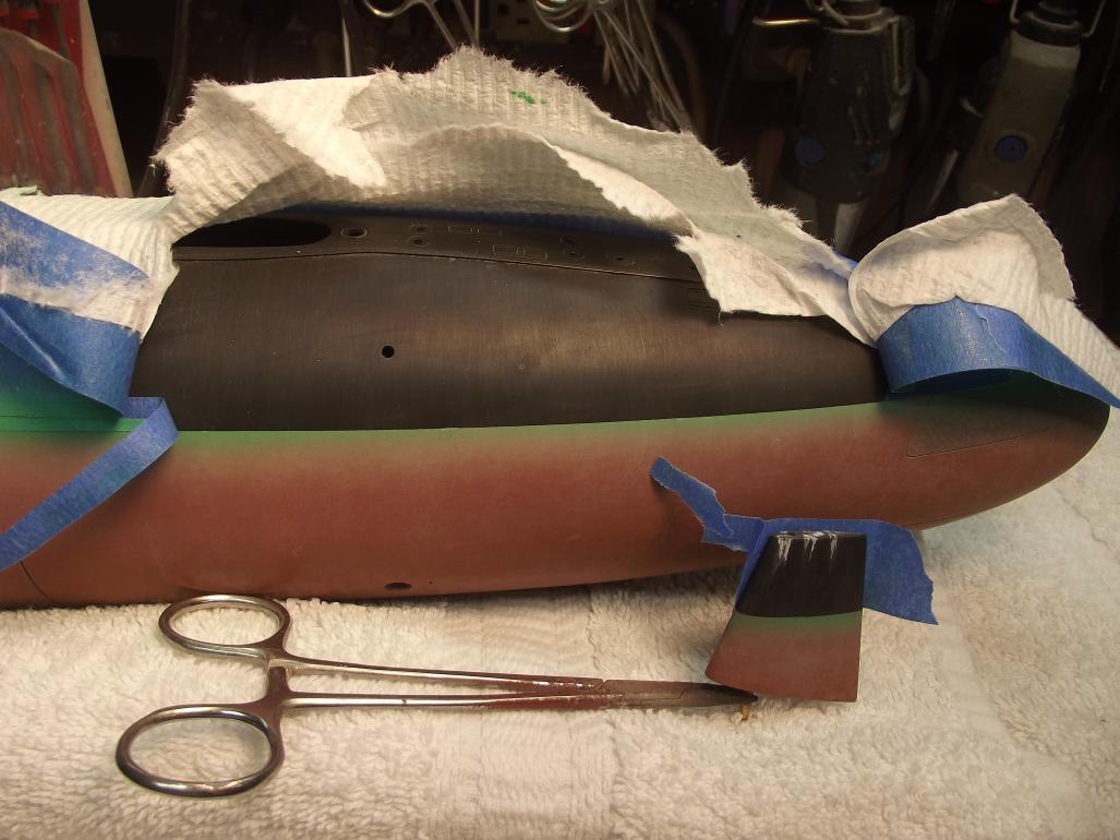

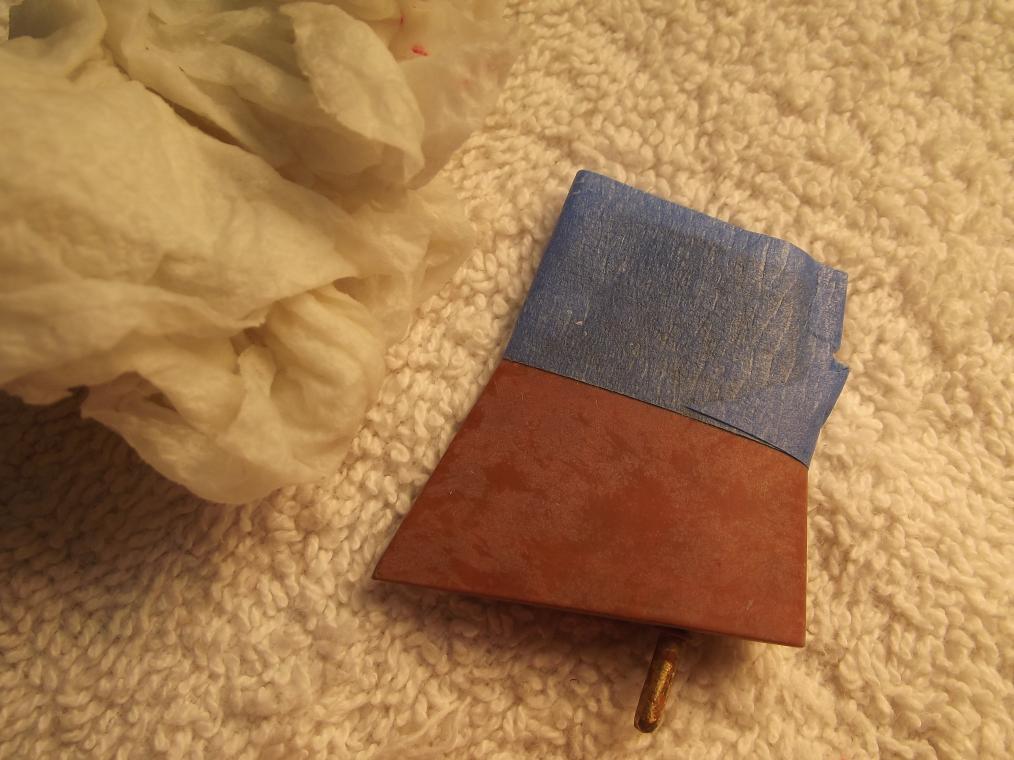

    Before removing the masking I laid down a band of white mist and over that, at the demarcation line below the waterline I painted some green to represent 'grass'. The masking was then removed. Tomorrow, when things have dried hard I will use a white pencil, steel wool, some chalk and any other do-dads I can think up to make the scum-line a bit more believable.

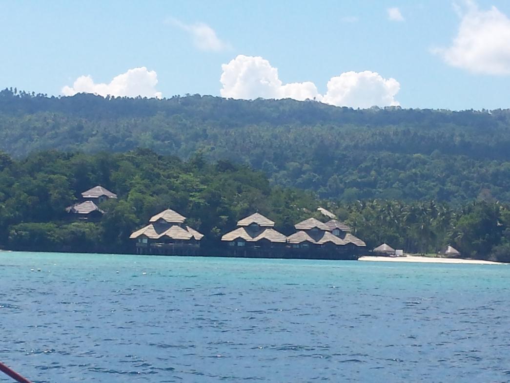

                      May I recommend
                      PEARL FARM BEACH RESORT | Davao, Philippines | Private retreat unlike any other | Was once home to a pearl farm | Reserve online and get instant confirmation

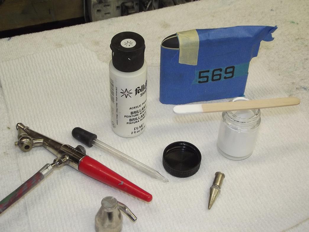

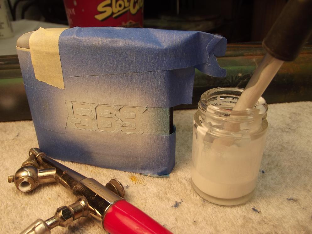

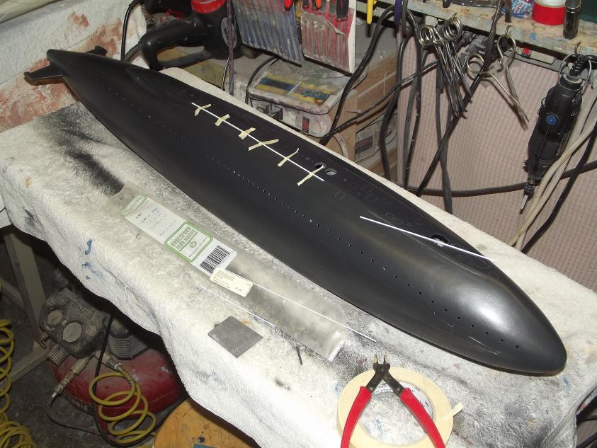

                                In the home stretch on this thing. I've already trimmed the 1/60 ALBACORE out in the local dive shop pool -- that done while in primer gray. Now, for the 'making pretty' stuff:

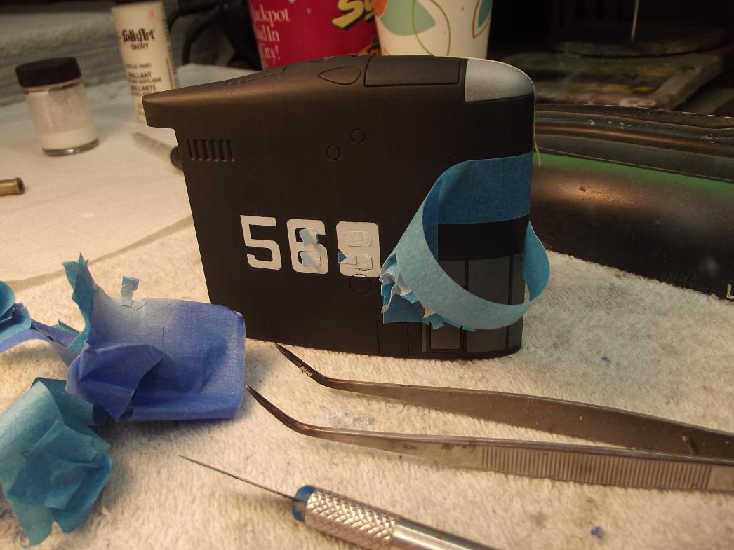

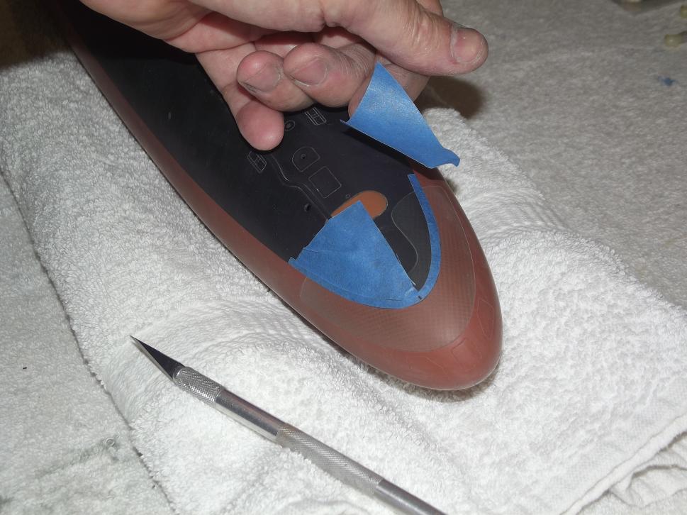

ID:	93380 For hull numbers, ships name and draft markings I usually employ the Woodland Scenic line of dry-transfers. However, I did not have a font size large enough for the hull numbers that go on the sail. Nuts! Break out the proportional dividers and masking tape! I lofted the character outlines from the plan and laid them down on the sail with masking tape. Fortunately, 'Gothic' (block) letters and numbers are easy to do (no doubt one reason the navy has such an affinity for the style) this way. So, half a day invested in masking and I was ready for white paint.
ID:	93383 Click image for larger version

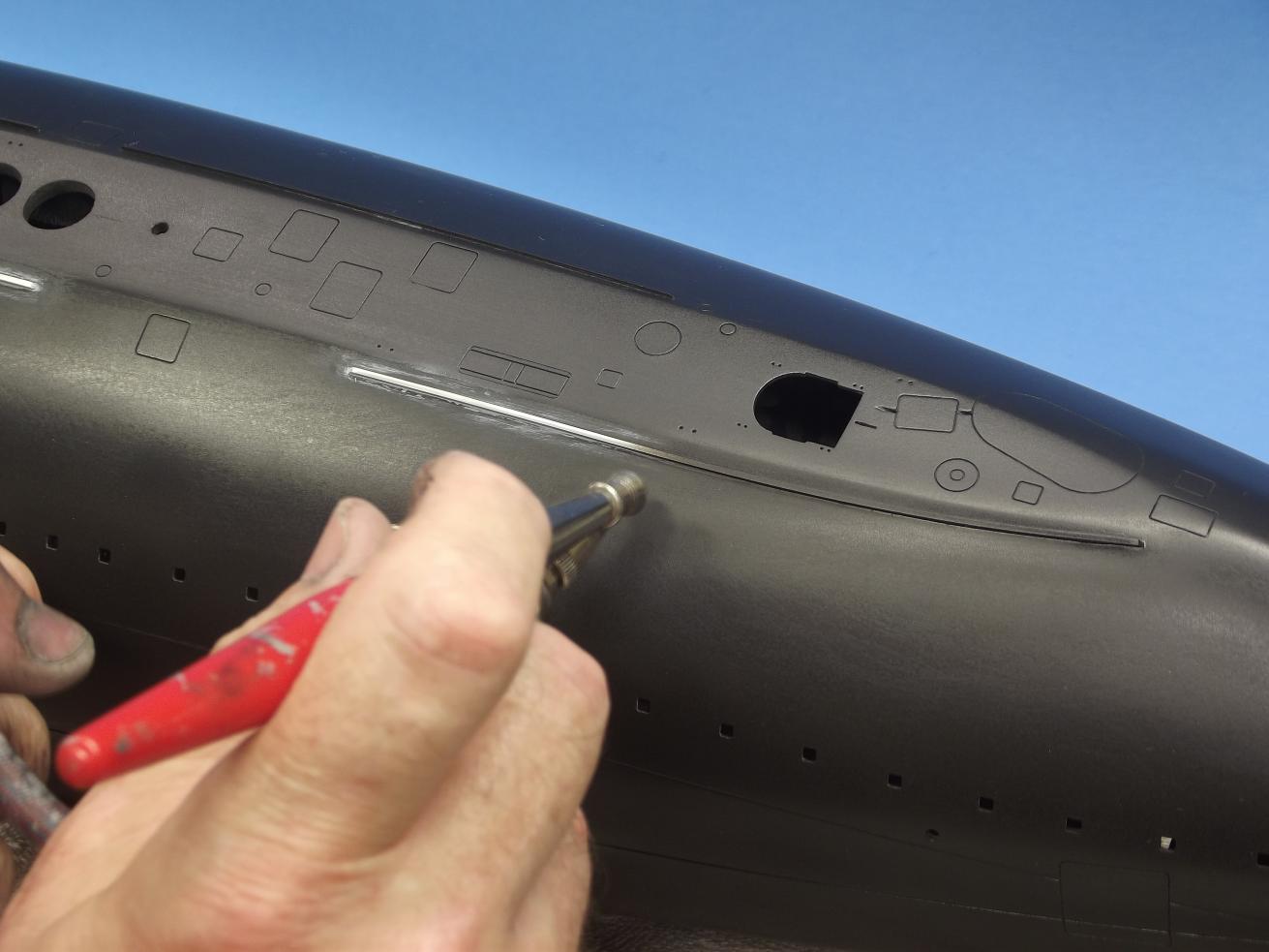

ID:	93381 I broke out my nasty old Paasche H-model spray-gun, outfitted it with a #1 tip, and started blasting away with some thinned down water-soluble acrylic white. I first applied a bunch of over-spray protecting masking on the sail. While at it I painted the 'clear' dead-light atop the sail white to make it appear transparent. Looked like hell, I later polished it off for another try later with silver and some black streaking.
ID:	93382 Yanking off the masking and, wa-la, hull numbers.
