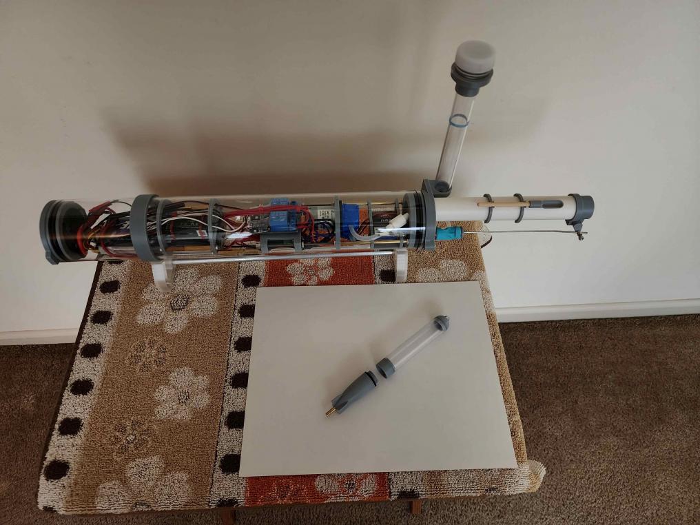

            I probably should have posted this version first. This first attempt was without the launch lock and check valve. I also had to fix all the torpedo leaks. An O-Ring replaced tape, JB Weld replaced CA glue and threads replaced a press fit.

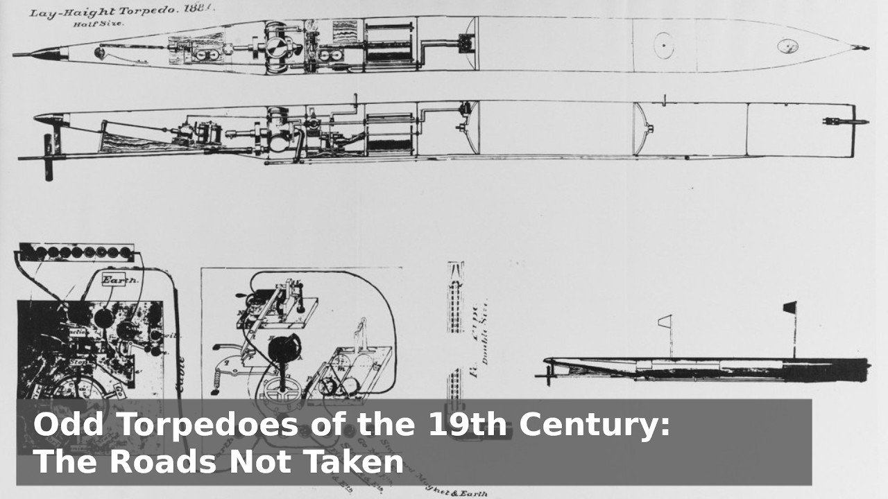

                      Funny and timely. Drachinfel just posted a video article on 19th century early torpedo inventors.
                      'Experimental Torpedoes of the 19th Century - The Roads Not Taken' Just posted yesterday. Yes attempts with Vinegar and baking soda too. lol

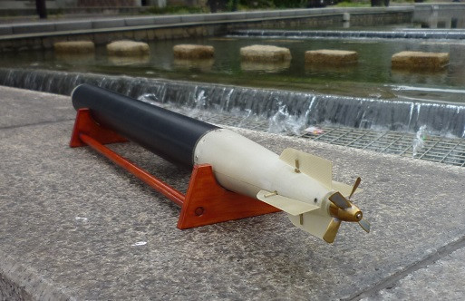

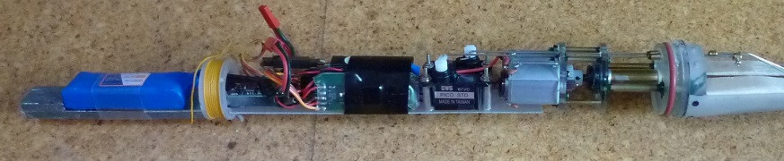

                            Here's a 1/12 rc torpedo from Japan
                            540mm length, 40mm diameter
ID:	193593 Click image for larger version
ID:	193594 Corona receiver
                            550 lipo battery
                            2 FA 130 motors
                            PICO X2 Servos
                            MS10 ESC
                            PS10 automatic pitch controller
