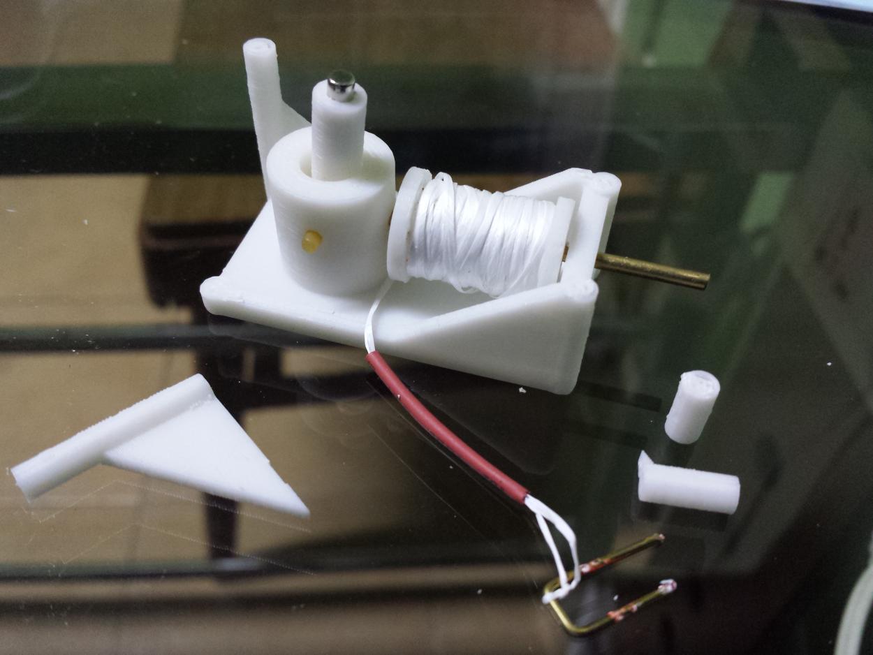

            Went to our local post office today to pick up the rescue bouy reel.
            Three of the post were broken but they look fixable. A little CA and they'll look good as new. Thank you.
              Bollocks. I thought that the padded bag would be OK. Some ******* must have jumped on it!! If it CA doesn't work I'll send you another one. Apologies.
                Broken or not, it's a slick looking little unit.
                  BTW, thanks for including some water-soluble pins aka sphagetti. Lol!
                    My pleasure. Didn't know who reliable local noodles might be!
