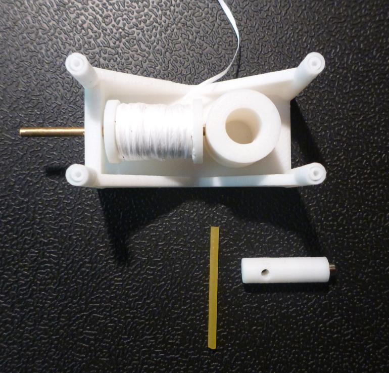

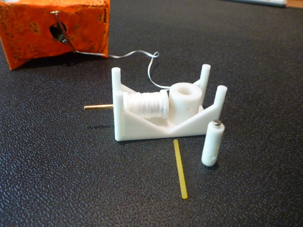

            Electrometronics and sparky things are not my forte but simple mechanics I'm OK with. I've been thinking about the rescue buoy thing for a while and looking for an absolutely fool proof way of releasing a rescue buoy. Turns out that there isn't one but this comes close. This is a test rig for a rescue buoy held in place with a water soluble rod. It takes around four hours for the rod to weaken to the point that it shears off and allows the retaining plunger to float free. The reel holds 15 metres of flat, waxed nylon with a test strength of over 30 Lbs. More than enough to safely pull your precious (and inert) submarine from the bottom of some muddy lake.
            The frame and spool are made for a simple CAD drawing (because I couldn't find a ready made spool of the right size) and printed on a 3D printer. The float is plastic covered foam with a magnet to attach it to the retaining plunger.
            The reel is mounted on a 2mm brass rod which can be extended to lock the retaining plunger in place to deactivate the system. Handy if you are running in a place where you know you can locate and recover a sunken boat easily.

            The key to this is the water soluble retaining rod (or WSRR). It is guaranteed to function each time, every time.
              What's the composition of your WSRR?
              Hmmm. Looking at the photo more closely it seems your WSRR is an uncooked piece of sphagetti.
                Its a complex composition of Globulin (2%), Isopropanol (40%), lactic acid (3.85%) and Albumin. I'll be offering pre trimmed 2MM WSRRs in packs of ten for $30.00. Or, you could just go to the kitchen cupboard and take out some uncooked sphagetti! Your choice.

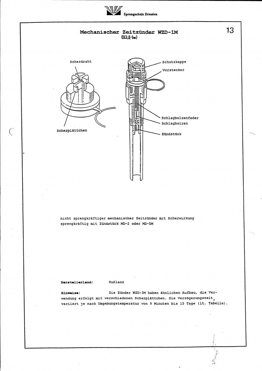

                    No. Its just spaghetti. The idea came for a system that the Russians use in underwater demolition. They have some very sophisticated timer fuzes but they almost always back them up with an acoustic fuze and a simple mechanical fuze that uses a small lead strip inserted under a wire under tension. Over a given time the wire pushes through the lead and when it does the charge is initiated. Simple, fool proof and cheap - like spaghetti!
                      Russian Timer
                      This is the time fuze that they use. "Scherdraht" is wire and "Scherplattchen" translates loosely as sheer platelet. Each fuze comes with a small cloth bag containing a number of different pieces of lead sheer platelet which provide different times.
