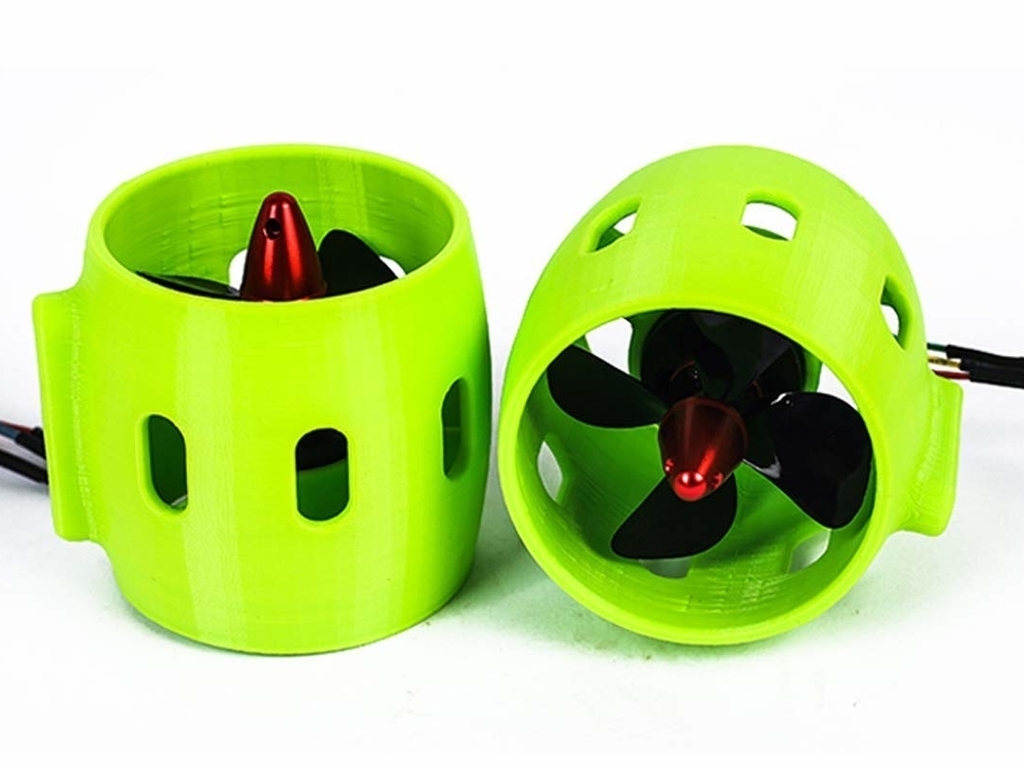

    • QuarterMaster
      • Sep 2015
      • 1244
      Reserving these for the SSRN SEAVIEW.
      Wait till we drop THAT in your pool! the 1 hour three point turn!!
      Yuenhoang Brushless Motor Underwater Thruster 12V-24V CW CCW 4-Blade Nylon Propeller for DIY Underwater Robot RC Bait Tug Boats (1pair CW&CCW)
      v/r "Sub" Ed
      • ffr2608
        • Oct 2009
        • 343
        I like this thruster methodology. Plastic bushings and sealed windings to resist corrosion.
        This T200 comes with a slightly shorter cable and a pre-installed cable penetrator and is a drop-in replacement for the thrusters on the BlueROV2.
        • Bob Gato
          • 882
          A little pricey...and I prefer to be able to spray a couple of shots of Corrosion X or WD 40 into it easily after use ...I could be making a mistake but an under $20 dollar motor and a quick change mount would be my choice. (especially if all you run is clear fresh water)
