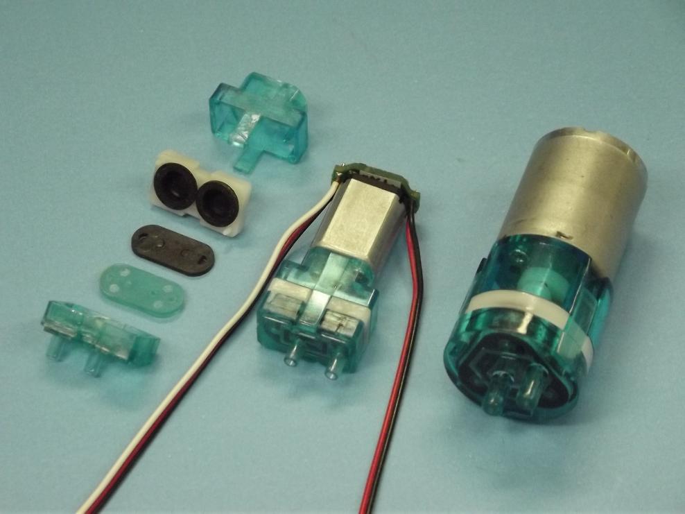

          Ended up replacing the Polk Seeker 6 receiver as it started acting really wonky. Programmed up a Sombra SL-8 and it works like a champ! One problem; the LP Blower quit working!! I know signals are moving around, 'cos I troubleshot the harness and get good movement at the blow/vent servo. So, how do I get a new LPB for the 2.5" Sub Driver? I could go straight gas like in the old days and use a SubTech Subsafe as the failsafe (or the receiver feature!), but I'd like to keep her true to how it was purchased.

            Is the problem traced to the BLM or the LPB? Clarify, you Weld-Grinding/wrench-jockey... CLARIFY!
            And no, the BLM board should never get much over room-temperature.
            Is the LPB motor seized? Check it!

              Problem seems to be the LPB Controller (a VERY small board mounted on the motor of this tiny blue plastic air pump). Removed the BLM from circuit, jumpered power/signal leads as appropriate, and still get nothing when a blow is commanded. I could check the pump rotation after I destroy the casing, as someone has glued on 0.010" slabs of white styrene on the sides to make it non-openable. Once I get those off, I guess there are 2 tabs to squeeze while lifting case slabs off the pump innards. Or, do I do something with the hole that's in line with the motor/pump eccentric drive thingie?

                There's a small 'weep' hole in the blue pump housing. Poke a small screw-driver up in there, and push the round disc that forms a fit to the motor drive shaft and see if you can swing the armature around. If not, the motor is the bad-guy. If so, likely the electronic motor controller is toast. Let me know -- I have spares, you nasty old Auxiliaryman, you.

                  I did try poking a toothpick up in the hole and got a small arc of movement, then no more. Tried from the opposite side, got nothing. Looks like the motor and controller combo. Could you throw one or two of these things in with my Skipjack cylinder? Let me know what you consider fair compensation and I will make that happen. Meantime, more painting and other detaily stuff shall happen!! :)
