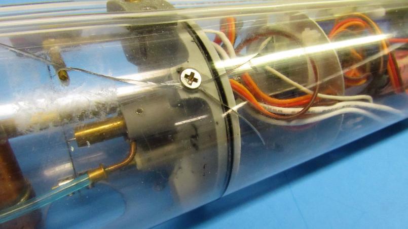

    I am getting close on getting my 1/72 Skipjack trimmed. Standard process; submerge, try stuff, pull apart, glue in foam/weight, repeat. Each session, I have about 1/3 cup of water in the battery compartment and a good 1/2 cup in the engineroom. The last one had a drop of water on top of the safety float valve, and all sessions have shown droplets inside the clear PVC tubing. Stuck valve? How to fix? Blowing into the submerged cylinder does not show any other leaks, although the MBT vent pushrod could be in cahoots!

      That's major-league flooding.
      Look at the LPB pump housing -- is there any water in there that should not be there? Anywho... bring it along this weekend and I'll give the entire system the hairy-eyeball, Bill.

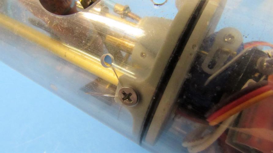

      One more thing: any cracks from bulkhead retaining screws that have migrated over the internal bulkhead O-rings?

              An old crack reawakens! There's an existing crack across the bottom bulkhead bolt hole, running from the MBT flood port and extending aft into the engineroom a distance of perhaps 1 1/4". It had been mitigated years ago, but seems to have tried an end-around with 3 branches of about 1/4" total. I drilled, filled and used catalyzed CA and solvent for acrylics, covered with a healthy dose of RTV and capped with good, old fashioned electrical tape. Todays water intrusion was: Fwd- 1/3 thimble, Aft- 1/3 cup. I'm skeptical on that one, as the o-ring the crack transverses still appears to have a nice squish band at that location. We'll see what tomorrow brings

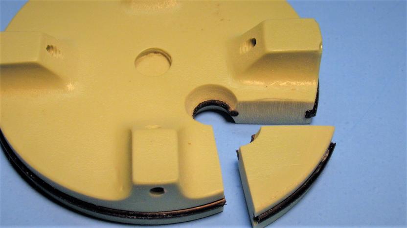

                Enough. I'll take it back home with me, work up a new cylinder and populate it with the gear from the cracked unit. You've ****ed that old dog enough, Bill.

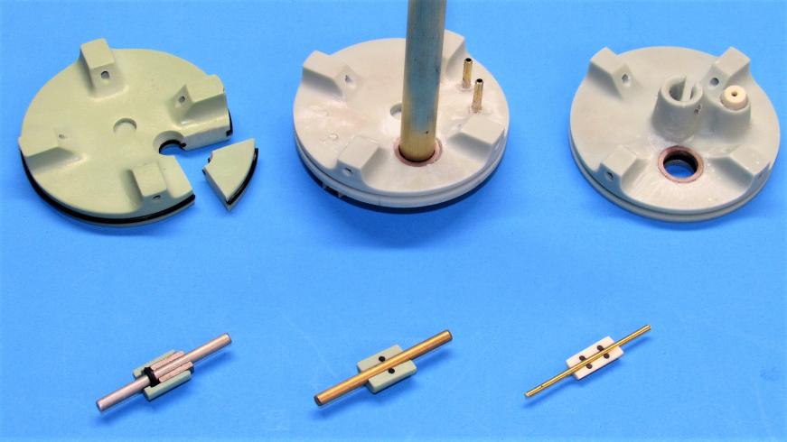

                      I can't give you a straight answer, Bill, as I custom size the O-ring to the cylinder.
                      This owing to the fact that all extruded cylinders are of inconsistent I.D. dimension's. This coupled with variance's in bulkhead O-ring groove depth and width means each situation demands a specific diameter O-ring to achieve a tight seating between O-ring-bulkhead-cylinder. It varies from bulkhead-cylinder to bulkhead-cylinder.
                      Click image for larger version  Name:	IMG_5569.jpg Views:	0 Size:	36.5 KB ID:	190663
                      Click image for larger version  Name:	IMG_5561.jpg Views:	0 Size:	39.6 KB ID:	190664
                      Click image for larger version  Name:	IMG_5568.jpg Views:	0 Size:	31.1 KB ID:	190665
                      Get one of those large-size O-ring kits (you're looking for 1/16" wall O-rings) and mix and match as required.
