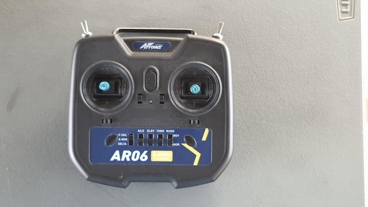

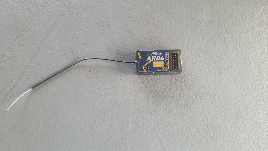

    I acquired this 6ch 2.4ghz set from a local hobbyshop ( owner was giving it away due to range problems, unfit for aircraft use) Click image for larger version
ID:	168647Click image for larger version

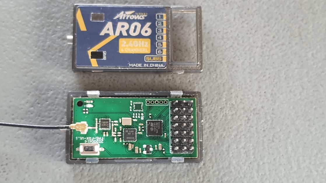

    I opened up the receiver to look how the antennae was attached. Click image for larger version

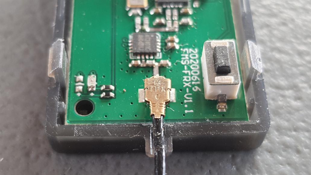

    close up of connector Click image for larger version

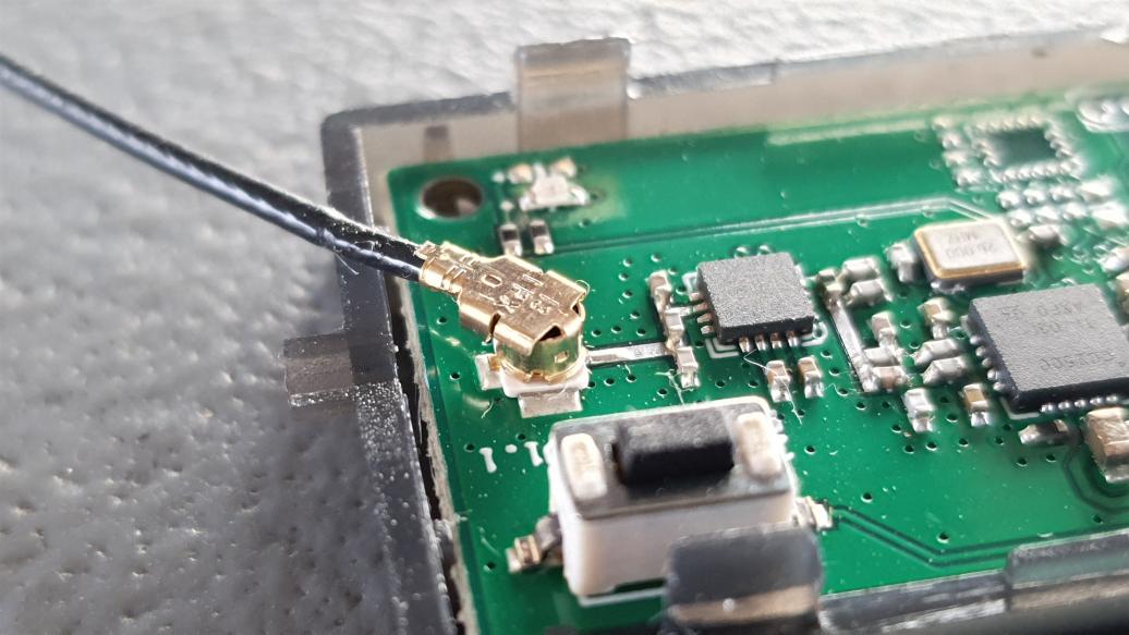

    It's movable
    Did some prelimenary searches, it's called IPX conector
    https://www.everythingrf.com/communi...hf-connectors1
    Any tips on what specific cable/ attachment I need to purchase extend the antennae?
  • Bob Gato
    • 898
    Romel, Google IPX connector-there are a lot of choices...different diameter sizes but also try to find pre-wired. I see them in 150cm lengths...if that would work for you it would save you from any micro soldering. (of course the end without connector gets stripped and becomes the antenna.)
      Looks similar to what you see Ed's video but how to determine the size to order
      • QuarterMaster
        • Sep 2015
        • 1244
        Capt. Romel,
        Review this:
        2.4GHz for the RC Submariner….the next step.
        ​Capt. Martin has IN STOCK what you need:
        Antenna Extension for 2.4ghz Radio Receivers
        v/r "Sub" Ed
        • cheapsub
          • 193
          If you don't have space in the wtc, try this
          If you just needed one, pm me, I could spear one.
