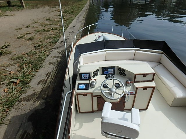

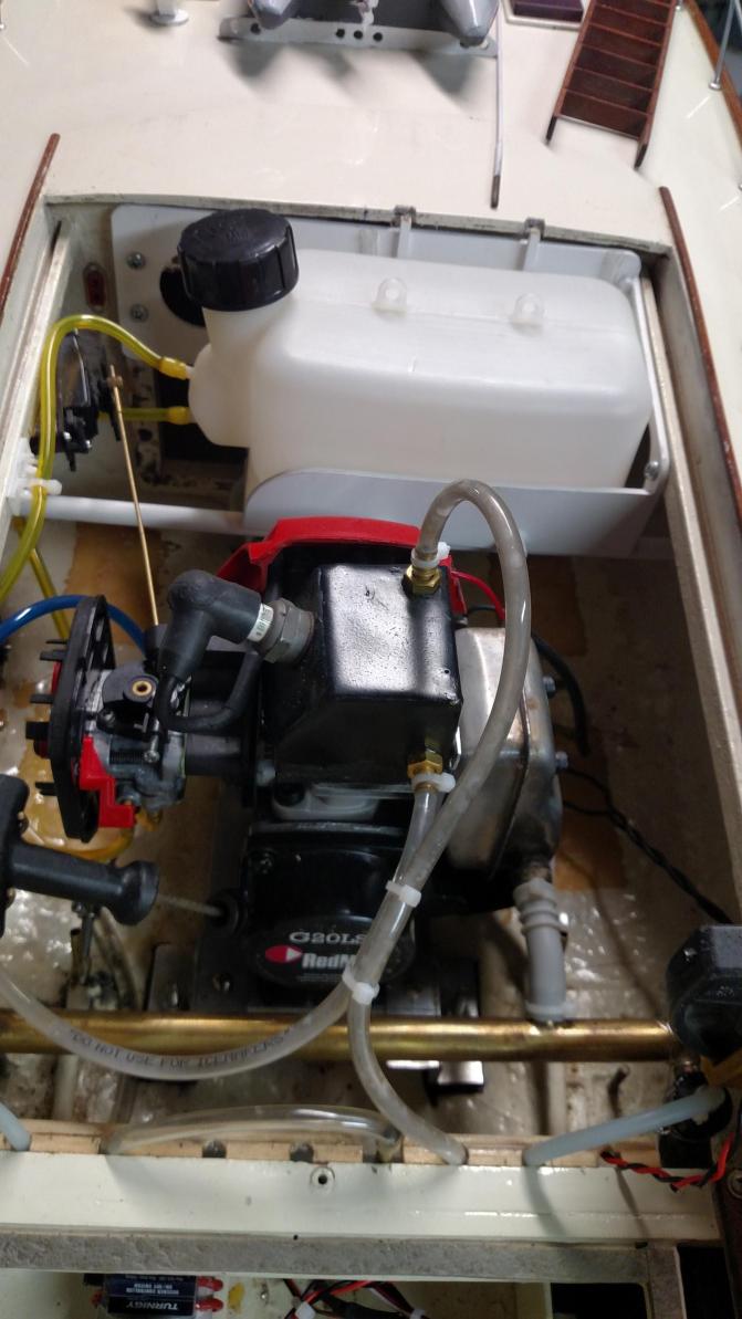

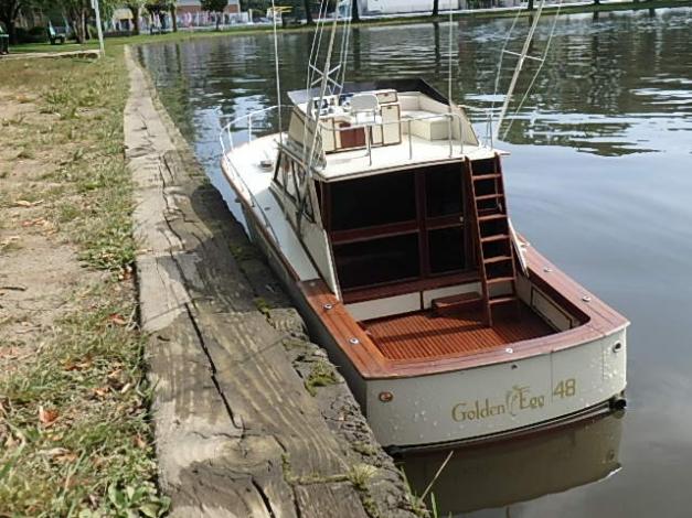

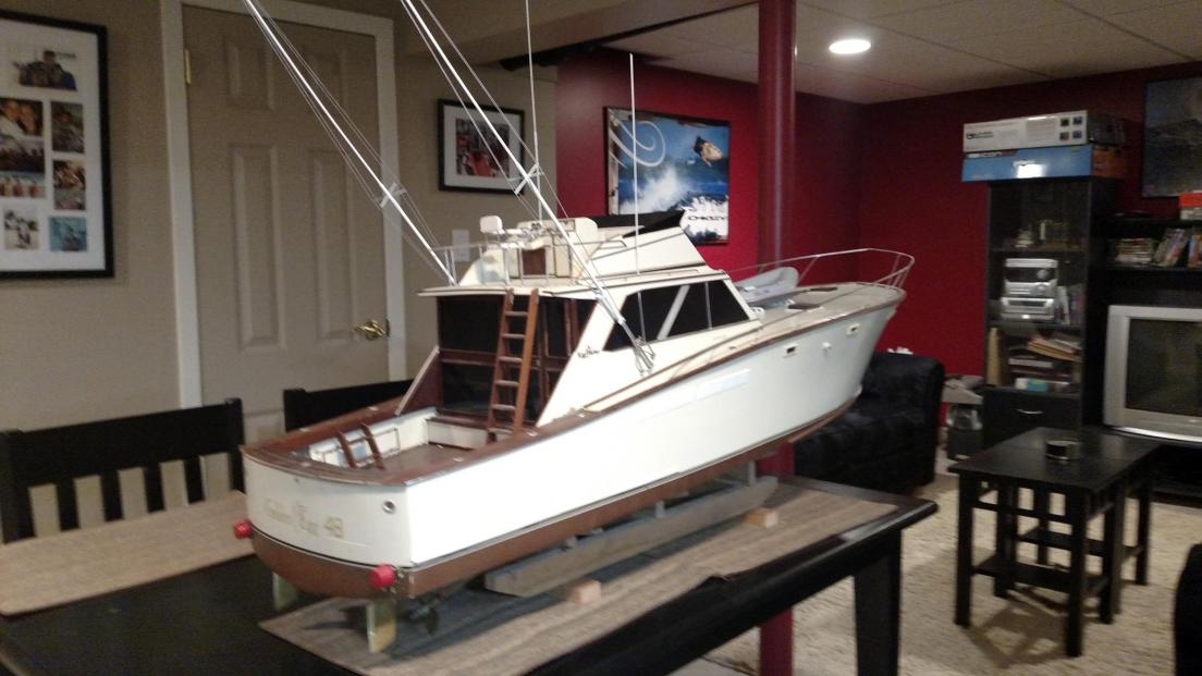

    This build started in 1975 and originally had two OS glow engines with two F-N-R gear boxes-as the years rolled by, I always wanted a pull cord, drop in the water weed whacker boat. A few years back I garbage -picked a motor...
    The model is of the brochure boat for Egg Harbor in 1972. I drew up plans from many photos and measurements of the full size boat in the marina. It has a redmax weed eater motor which I converted to water cooling (very hard to do because the spark plug is angled) and the output goes through a gearbox and on to two prop shafts(also homemade). The pilot station has a working compass (fabricated from a cut light bulb) The only items purchased were the props and the radio gear

    Love the attention to details.

      26 LBs ...runs quiet and smooth
      If you watched the video above take note of the water cooled exhausts bubbling and spitting as they roll under when she turned and stopped and the spinning radar...too bad that video didn't have the RIB on deck with the 15 hp outboard
      Features: real teak, hand painted logo and name (not decals).,fully operational and setable outriggers, wheel, Danforth anchor, rudders, motor design and conversion, gearbox, working Ritchie compass, vinyl covered foam cushions, all scratch built...
