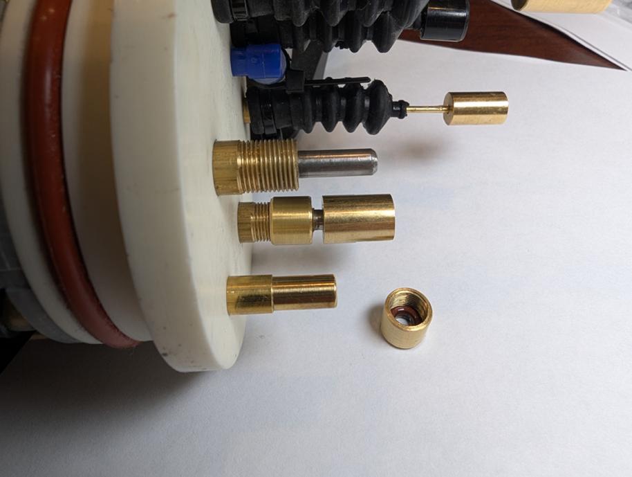

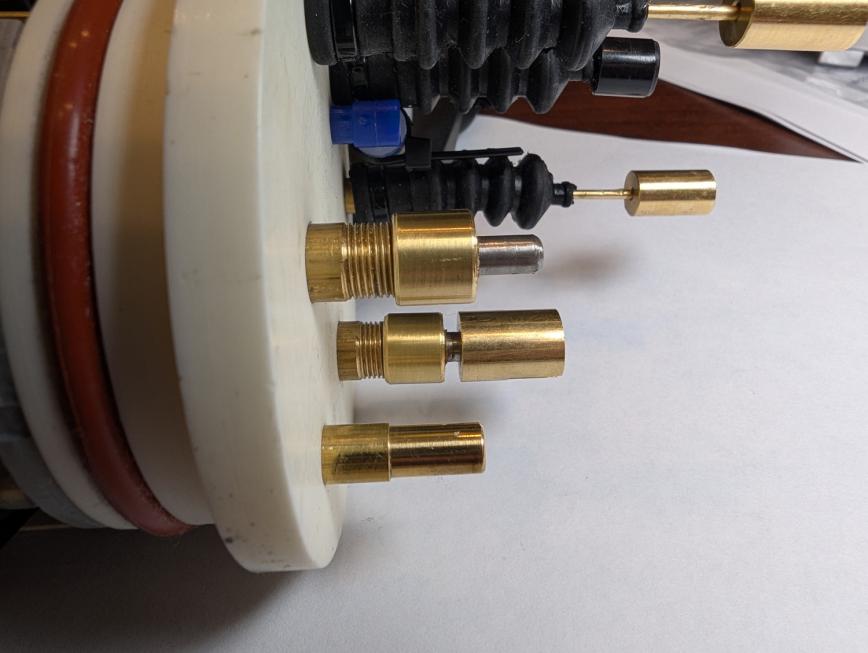

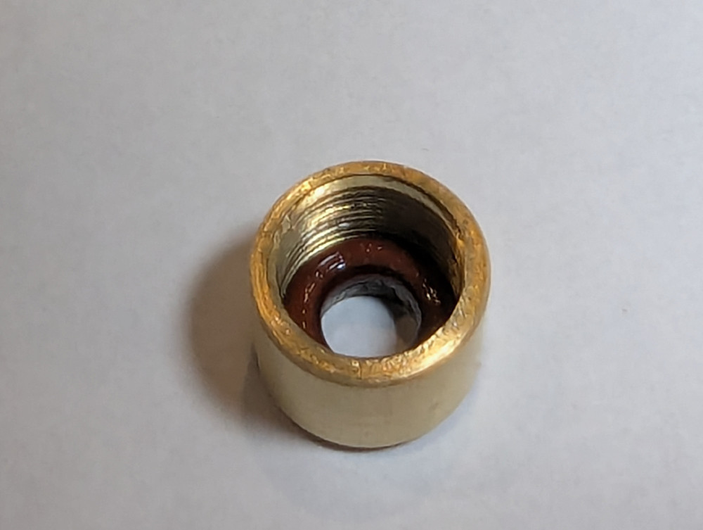

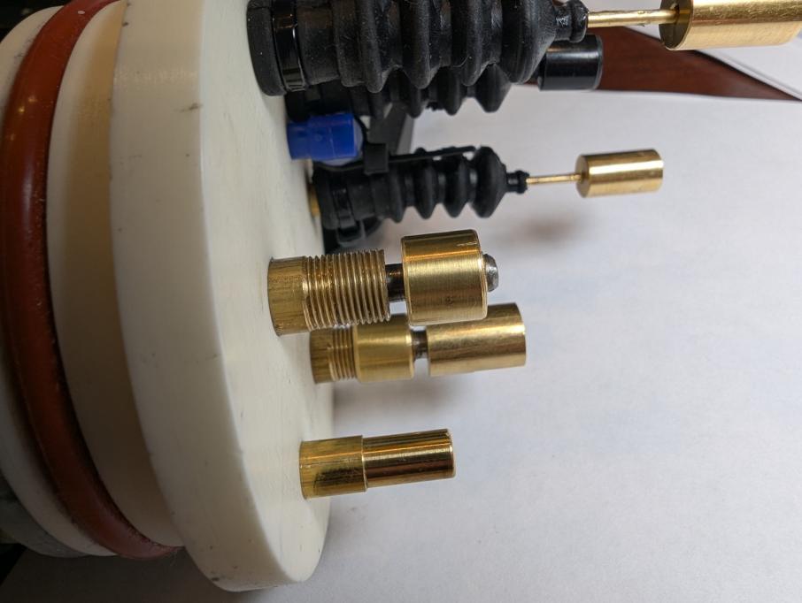

    Hi guys. I’m prepping a 70mm R&R WTC equipped with dual motors for Subfest 2026. I’m not coming up with a way to retain the 4mm driveshaft’s screw-on endcaps used as a water-seal.
    The endcaps hold a 4mm I.D. silicone O-ring inside (see photo). When I run the motors the driveshafts grip the O-ring/endcap assembly and spin the endcaps off or, on depending on whether the motors are running forward or reverse. Tightening the endcap is not an option. If I screw the endcaps on fully, the O-rings get squashed and bind up the driveshaft/motor. Also, the endcap gets hot quickly.
    Anyone familiar with R&R WTC’s come up with a fix for this problem?

    threadlock?
    Bore out the endcap hole slightly larger than 4mm
      Are you running the shafts in the dry? They're designed to run solely in the wet which cools the assembly and the water lubricates the seal.

        threadlock?
        Thanks for the reply. Threadlock may be good. Do you know if thread-lock is waterproof? Bob suggested using super-glue on the threads to lock the endcap. Why do you recommend the over-bore on the endcap? What is your experience?
          I am testing the WTC/driveshafts on my workbench at the moment. The endcaps spin on tight or spin completely loose when I run the motors. I did not intend to attempt imersion of the WTC in water until I had the driveshaft water seals (endcaps) secured.

            Shaft might be catching on endcap causing it to turn.
