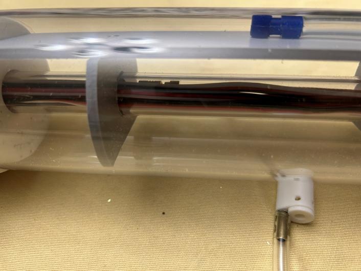

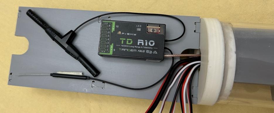

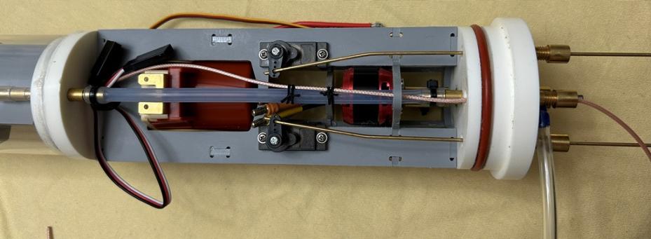

            My water tight cylinder is a work in progress, but to help anyone else with this question, I have attached some photographs.
            I installed the FrSky TD R10 receiver in the battery compartment with the 2.4 GHz short extension installed. I then attached the long extension and routed it through the center conduit as Bob mentioned. I wasn't sure if the brass coupler would also fit with the servo extensions and power wires, but it slid in without too much issue- see the attached picture for where it appears in the conduit (battery compartment to the left).

            I temporarily taped the receiver, the second original 2.4 GHz antenna, and the 900 MHz antenna where I believe it will work the best- see the attached picture. I may need to move them slightly once I hook up the servo cables to the receiver. If someone has a better suggestion, please let me know. I will also need to make sure the AD2 and mission switch will fit- I do not believe that will be a problem.

            I then have a picture of how I routed the antenna extension out the rear endcap. I removed the R&R On/Off switch and pushrod, and routed the antenna through the bulkhead gland. The o-rings are a tight fit, but I may still need to seal the outside of the brass ferrule (not sure yet). As a side note- in this picture I am using waxed lacing cord around the antenna and vent tubing like we traditionally used on aircraft wire harnesses before zip ties. I feel they work better, and do not have sharp edges to cut you or other objects. The original vent tube zip ties are there, but for wiring or antennas it is another method to consider for someone looking for a clean installation. As Bob mentioned, the antenna does reach the sail, and will have just enough length to be fed up a periscope mast on the Victoria model I am installing this in.
