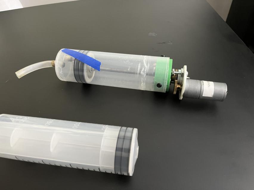

                  At one point I designed a syringe type ballast system for my Alfa boat, and set about designing my own WTC.
                  Video link
                  I scratched built the WTC and installed the syringe type system. It became a little bit complicated for me, and I never got it working for my Alfa.
                  Click image for larger version  Name:	VEDIO 2.jpg Views:	0 Size:	31.8 KB ID:	188334
                  This the remnant of that system and I am thinking about giving it another go around in another boat!?

                  This whole project was based on a total experimentation. I had no idea if it was sized properly for the Alfa At the time after building the WTC and adding this syringe contraption I discovered I did not the enough room for the drive motor. Might be now I could use a brushless motor and updated electronics on the ballast system and make it work. Again It would be another experiment.
