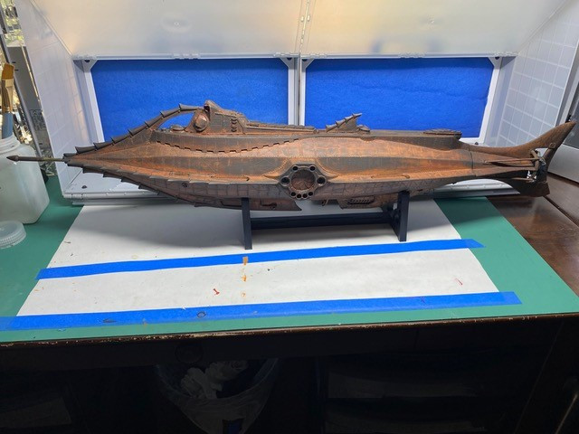

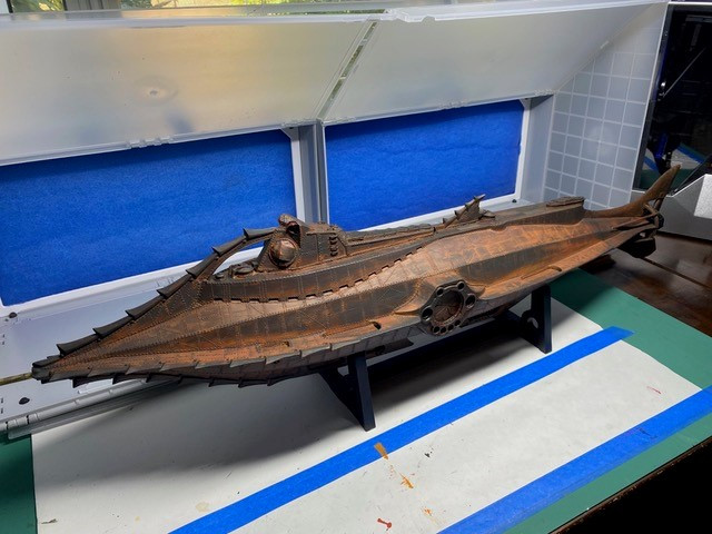

      My Nautilus was completely done with water base acrylics. David walked me through on how to use them not only airbrushing, but using paint brushes and a sponge. (thank you again David)
