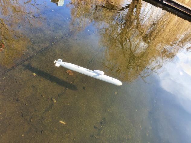

ID:	187079 STL Files:
                  https://www.thingiverse.com/thing:3825032
                  Video
                  You could forego the RCABS and just make it a dynamic diver.
                    Video
                    I like that little one, thanks! Know of any more free ones out there?
