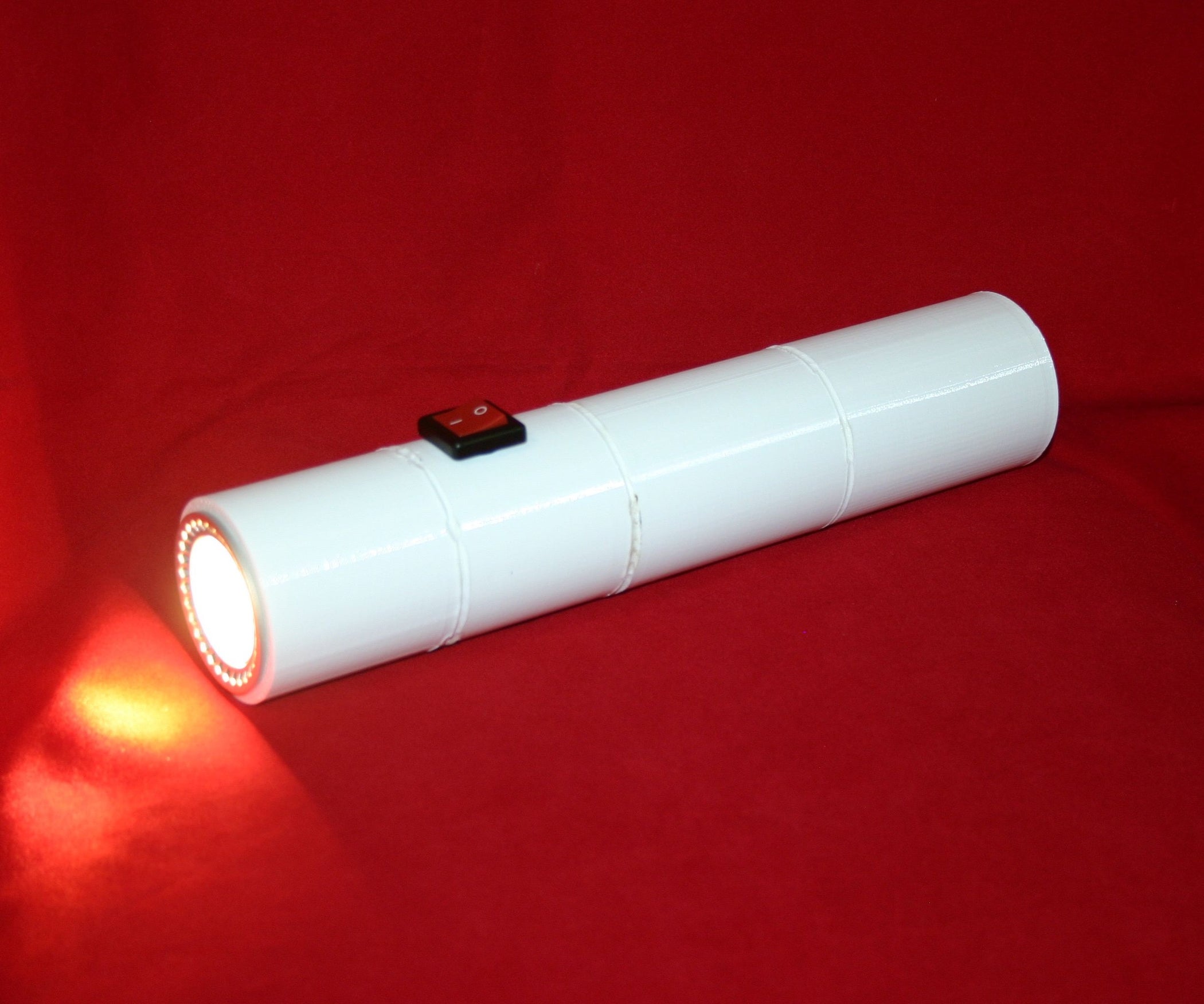

                            Supercapacitor Flashlight: Using a 5 watt MR16 led light, this (50 watt equivalent) flashlight (weighs less than one pound) really puts light in dark places. The capacitors can be recharged hundreds of thousands of times--so there's no worry about wearing them out. Using a 5 …
                            15 minutes of light, recharges in 45 seconds.

                              There's a boatload of LEDs on that board in that 5 Watt light and you get 15 minutes of runtime from two super capacitors? That's impressive I wonder how many minutes you would get for one red one green and one white micro LED. I think you would get all day at the pond without having to recharge and recharge takes 30 to 45 seconds.
