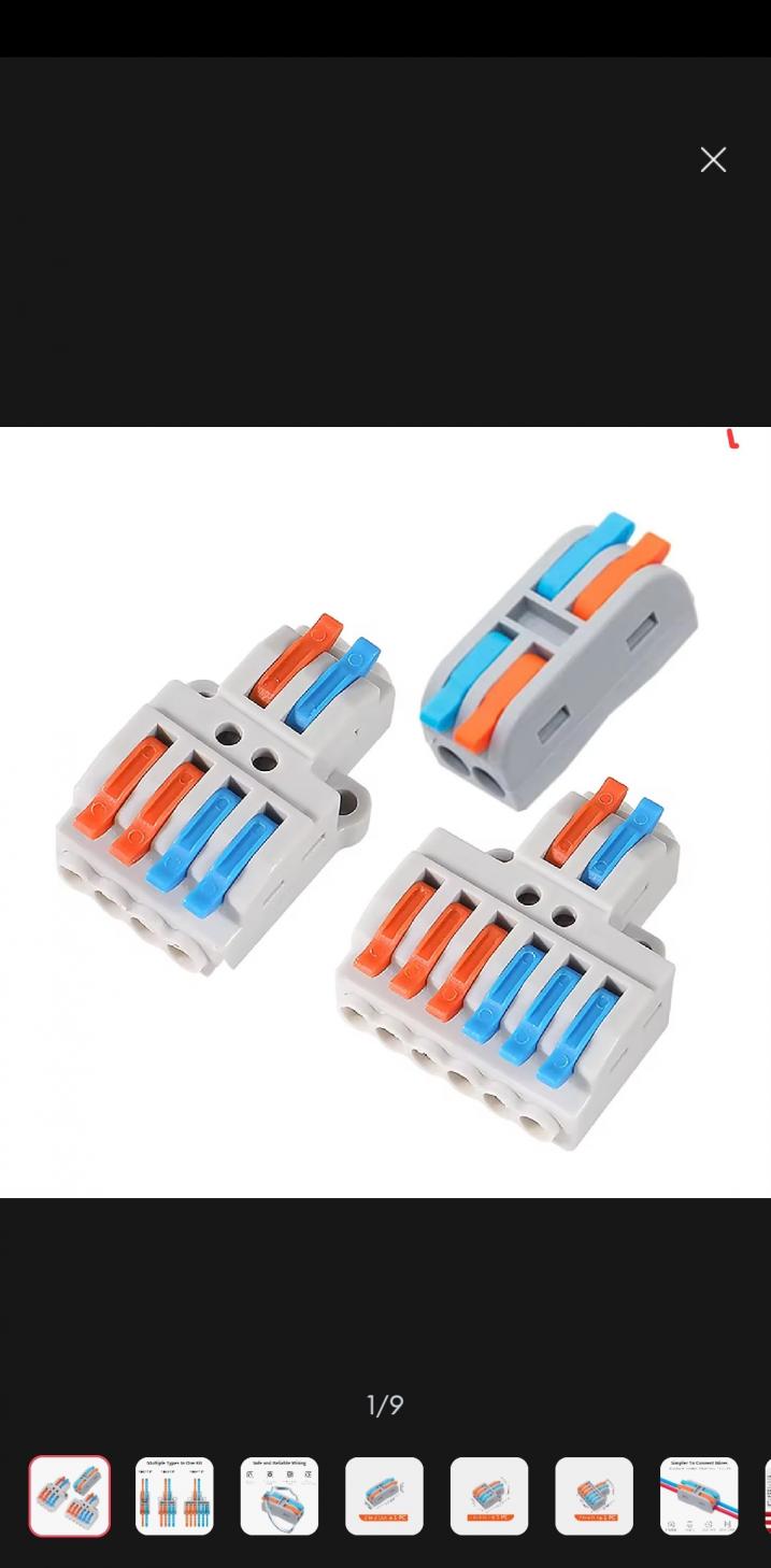

Bob & Jason include these type of connectors with the sub drivers. They come in many variations. You just have to search for the one that fits your application. Scroll thru the 'Related products' in any of the links for other types. For one to one connections the first link should do.
https://www.amazon.com/XHF2018-Lever-nuts5-Conductor-Splicing-Connectors/dp/B07Z5YD4P7/ref=sr_1_17_sspa?crid=27K5R1PW86V54&dib=eyJ2IjoiMS J9.3f3CUDF4eNNkmazgmN7amAuWZ78my1pGzFK7s5wk0l6Ah_z _cEpRsdZ_xtY1E0UYlzLduCrZkpbJlPn1Xez89frHpND4c5g7e Kv4yh53NEZr6kyWaUnw9MHnfoalGV1uGaUHyqZ_Mm1mcZxaBiq N_DSfPS9AGctsaQHEA5XrLlpsQ0MshJrlY9yoNkOxY9n7-JuStSrdEwwmkPvBmNkydUiLhgqa_qLwLSdcYUJ-l6c.Tlrt3nH2CY3pEBJFLBNUNiXArOEak4466mKdudIKy2A&di b_tag=se&keywords=wire%2Bconnectors&qid=1729329453 &sprefix=wire%2Bco%2Caps%2C112&sr=8-17-spons&sp_csd=d2lkZ2V0TmFtZT1zcF9tdGY&th=1
MTUERANC Wire Connectors, Compact Lever Wire Nuts Connectors Wire Terminals 3 Into 3 Out Splicing Wire Connector, Color Valve in-Line Connector for Quick Connect 28-12 AWG (SPL-3 10Pcs): Amazon.com: Industrial & Scientific

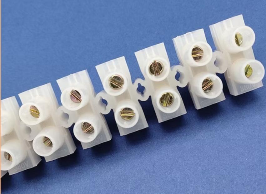

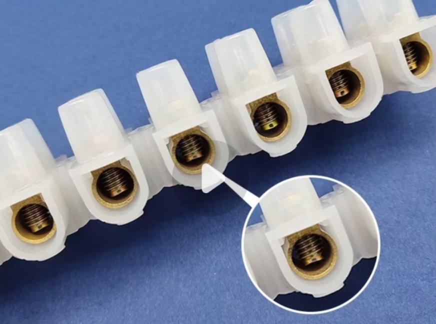

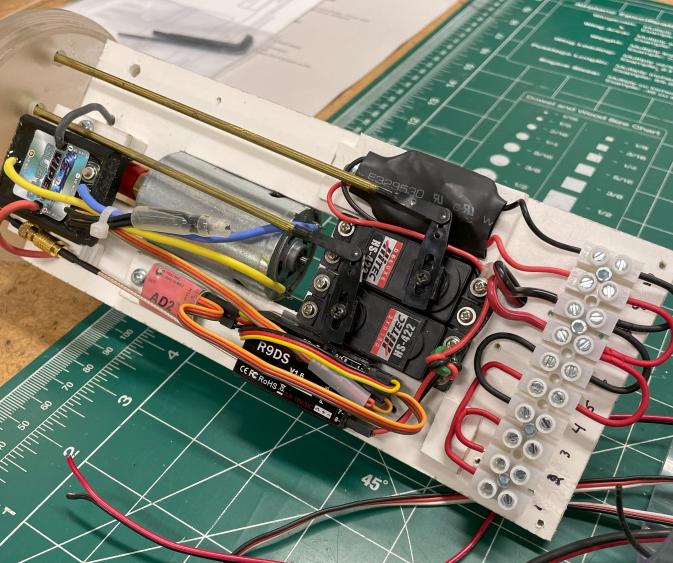

I’ve used these and had very good luck. The only thing you have to watch out for is over tightening, or loose connections due to temperature variations or vibration.Of the approximately 40,000 men who served on U-boats in WWII, it is estimated that around 28,000 to 30,000 lost their lives.Comment
As seen in post 5-Those are commonly called wago connectors... They are now approved to be used to replace wire nuts as connectors in residential (and possibly commercial ) electrical work. I would suggest buying the brand name not necessarily a possible knock off from overseas. I found that they gang together side by side with a dab of JB weld very nicely. The Big box home stores all carry them. I started using them on my Regulator model no more problems with over tightening or expansion / contraction loosening, as with the European terminal blocks.Last edited by Bob Gato; 10-26-2024, 05:17 AM.Comment
