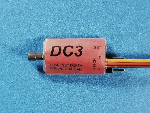

        Overview: The DC3 uses a very simple control algorithm to help keep your boat at a constant depth. Even when activated it is designed to not interfere with your ability to adjust your operating depth, but it must be controlled from a “spring return to center” stick on your transmitter. After activating the DC3 use the bow-planes drive your boat to a desired depth and once there let go of the control stick. While the DC3 sees a rise- or dive command on the bow-plane channel it passes that command along to the connected servo but also updates the stored “reference depth” that it should try to achieve. When the DC3 sees a neutral command on the bow-plane channel it will compare the current depth to the reference depth and drive the bow-plane servo asneeded to return to (or remain at) the reference depth. To the operator this means the DC3 does not get in your way when you want to change depth, and will simply hold the depth you left off at when you last released the control stick. InstallationThe DC3 can be mounted in any location that’s convenient, front or aft in your watertight compartment. (The point at which the depth/pressure is sensed will be within the pressure pick-up tube, not the location of the pressure sensor.) The DC3 is not affected by local pressure changes in the WTC so it does not need to be located in a separate compartment if you’re using an RCABS- or SAS-type ballast system. It is recommended that you choose a location that will allow easy access to the setup button should any tweaking be required and has a view of the LEDs as these can be helpful for diagnostic purposes. The pressure port on the DC3 should be connected to your pressure pick-up with a soft silicone tube. View installation and setup instructions here.
        Depth Controller DC1 - The DC1 allows stabilizing a model submarine at a desired depth. It is connected directly to and powered by the receiver. The module can be operated by a control stick as well a

            The DC3 is a depth-related device, but not a failsafe. Basically, you dive to where you want to cruise using your bow planes. When you reach the desired depth, you release the stick, the unit takes a pressure reading and then uses the planes to try and maintain a depth that provides an equivalent pressure value. Your stick overrides the DC unit when you use it, the DC listening for a return to a neutral value and then going about the process again.
