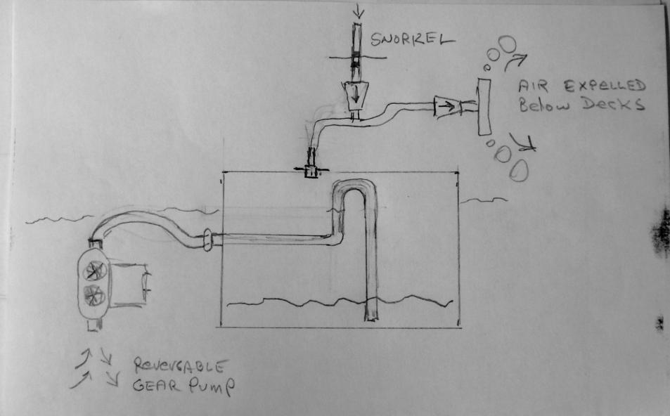

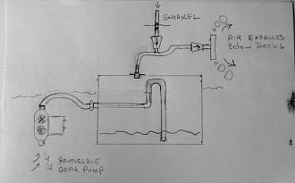

      Click image for larger version  Name:	image_40797 (2).jpg Views:	4 Size:	65.6 KB ID:	177521 Click image for larger version  Name:	P8150022.jpg Views:	4 Size:	41.1 KB ID:	177522
      ballast tank rom Bob Gaito's Gato class (top) and Atlantis tour sub ( bottom)
      RC Shipyard Vented Ballast tank using a solenoid valve

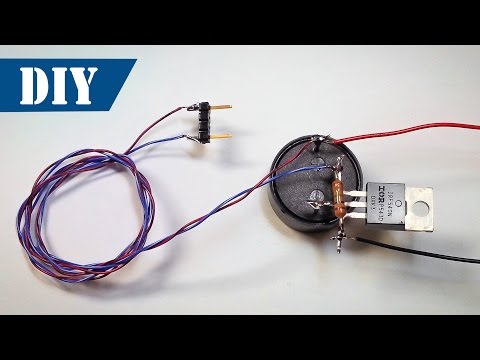

        • 3603

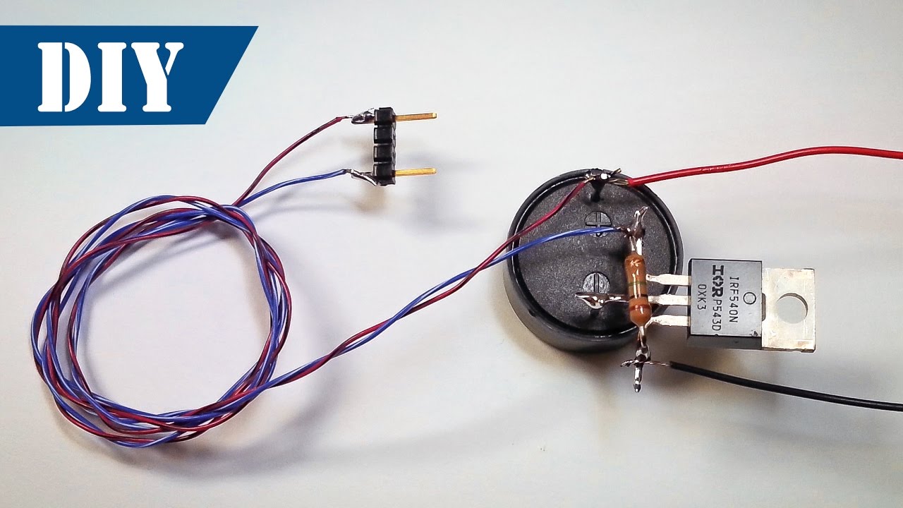

        Need to swap out the buzzer for a relay switch to stop the pump when tank is full.

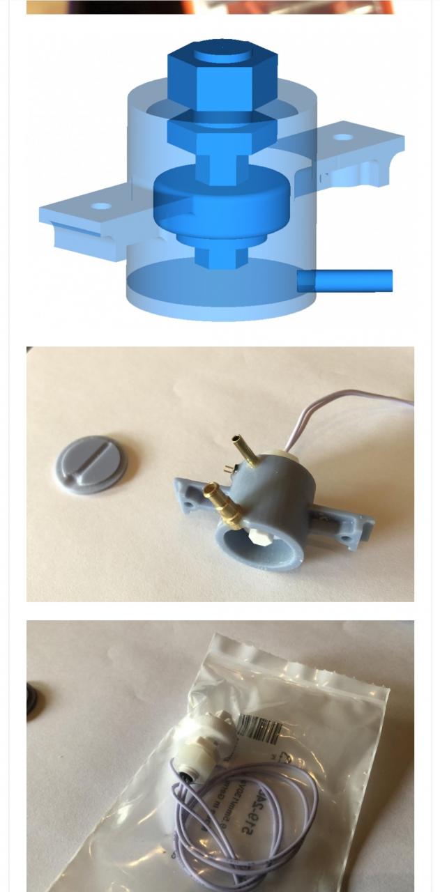

          Check out DrSchmidt's Fantasy Neptune
          Got a bit tired designing scale models on scarce info. So I took raw dimensions of a class 209 boat and got crazy with the rest. Those are the results:
          He used a tiny float switch to shut off the pump when the tank was full

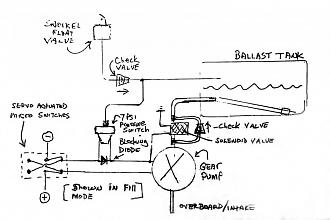

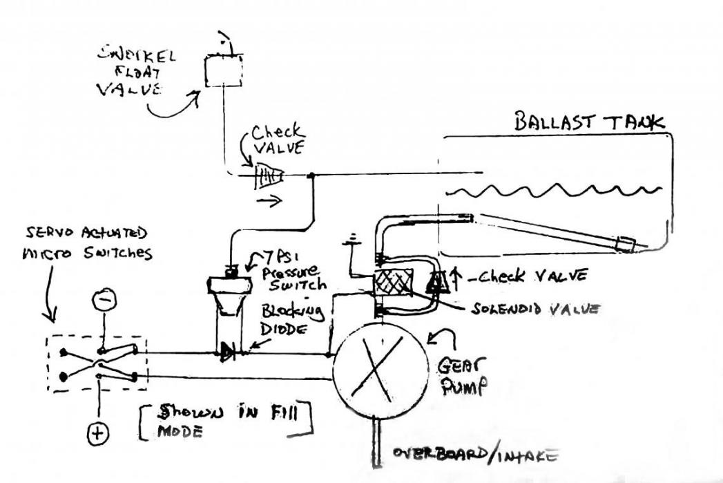

              https://youtu.be/RqnxuMlmhkA?si=p1wM5ERPM3xRyeDQ
              Thanks very much!
              The diagram calls for a float valve, a check valve, a pressure switch, and a solenoid valve. Are there specific ones that people commonly use in their subs?
                Excellent! This looks like exactly what I am looking for!
                Thank you very much!
