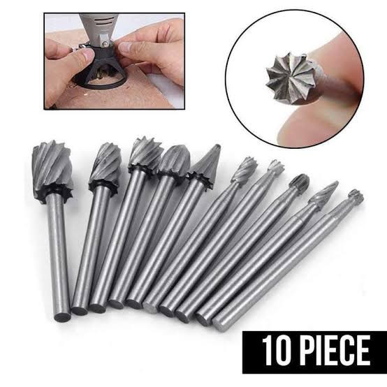

          would this work? Click image for larger version

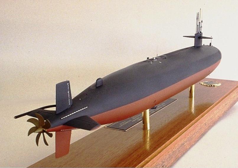

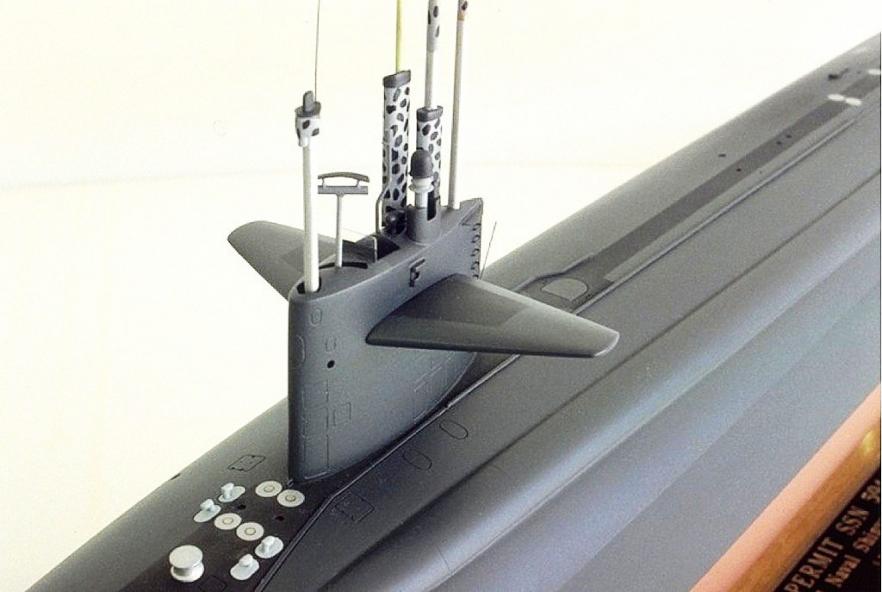

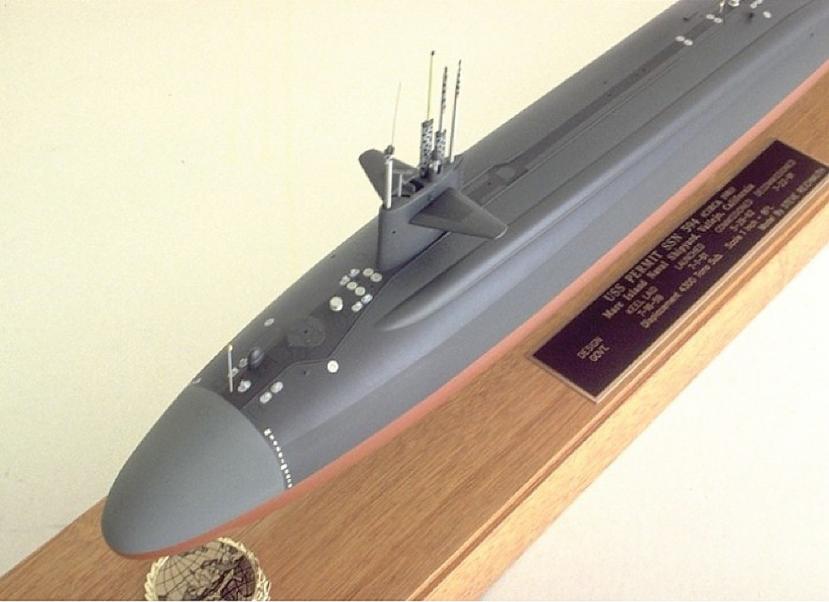

              (BELOW) Maybe this isn't what you had in mind. But I simply made my MBT vents as dry transfers. Silver aluminum and brass like center roundels. Simple, consistent looking. Model of the USS Permit SSN 594 1/96 scale static model I built for the Vallejo Naval & Historical museum of Mare Island build SSN's. She is displayed there nextmy 1/96 USS Scamp SSN - 588 in Vallejo California (near the former Mare Island NSY)
              SteveClick image for larger version  Name:	KNcjVjJ.jpg Views:	0 Size:	48.2 KB ID:	169096Click image for larger version  Name:	58cjmrf.jpg Views:	0 Size:	50.5 KB ID:	169097Click image for larger version  Name:	YXHWQrn.jpg Views:	0 Size:	51.8 KB ID:	169098

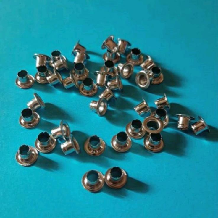

                Nickel plated grommets Click image for larger version
