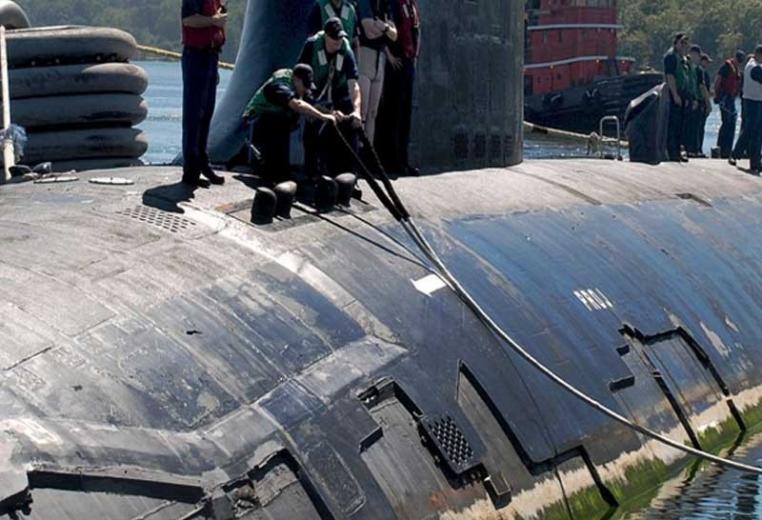

    How do you replicate such on a model? Click image for larger version

    Maybe YOU should find a simple, strong and reliably working solution for that and tell us all about it!

      You could use a template for airbrushing. Rectangular stencils. Thin abs-sheet applications.

        • wlambing
          • Nov 2020
          • 399
