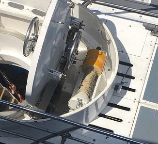

                  Luckily the Atlantis sub I am building could have a scale operational buoy -BG
                  Click image for larger version  Name:	Rescue Buoy.jpg Views:	0 Size:	35.7 KB ID:	156981

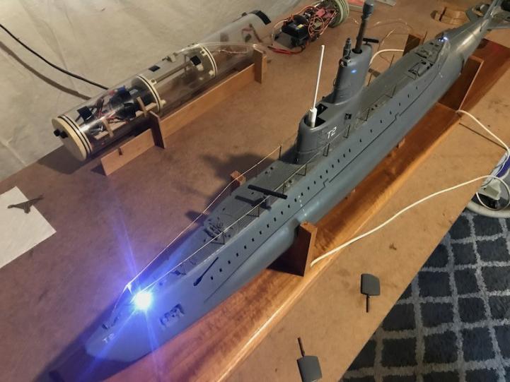

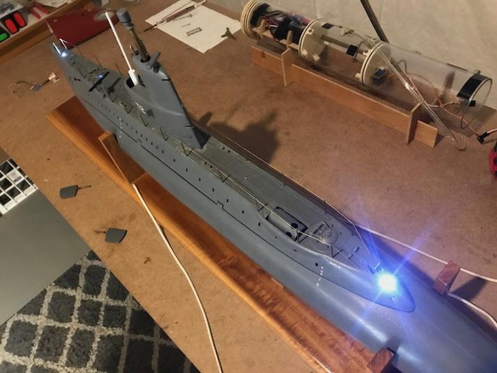

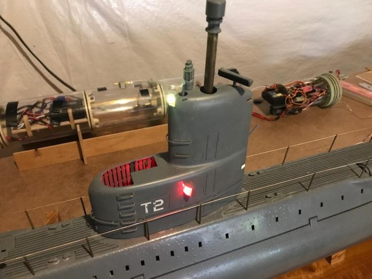

                    The real Marlin was used for practice by the sonar guys on ASW ships. The Marlin had two very bright lights they would switch on while underwater to show where they were to the surface ships.
                    On my Marlin, I have a float switch in the sail which activates the nav lights when the boat is surfaced. When the Marlin submerges, the float switch deactivates the nav lights and activates the two very bright LED's on the deck. They point upwards. So should I loose my Marlin again, I should have these LED's to help locate it. In the future I'll also be designing my own underwater audio device to assist in finding a lost sub, should that happen again.
                    Navigation lights on, bright deck lights off. BTW, that RADAR antennae also works.

                    Nav lights off. Bright deck lights on. That white stick on the open bridge has a magnet which allows me to test the float switch and lights.

                        Originally posted by Bob Gato
                        I experimented with this for surface craft and shakedown runs of subs-NOW please read with an open mind-as the post says the active ingredient is very predictable in 65 degree water and will release in about 1 hour in ph neutral water. Its not pretty-that's where I stopped thinking about it...like I said I only used it for shakedown dives...if I were to run for longer then 1 hour, I'd quick change the unit for a fresh one...On surface boats it would hopefully never need changing out and could be hidden in a lazerette box or under a cushion.
                        https://www.rcgroups.com/forums/show...61&postcount=1
                        No one can argue with you that the real Atlantis didn’t have a buoy!
