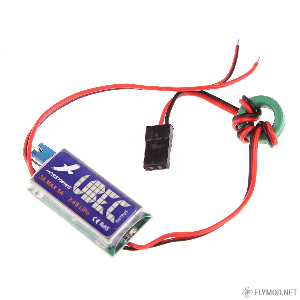

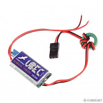

      Electromagnetic waves are everywhere, and there are two main ways of propagation: the first is conduction, and the second is radiation. Obviously in RC submarines electromagnetic wave interference is in the form of conduction, no matter where the motor is placed, the wire to which the motor is connected is the medium for electromagnetic wave conduction. We know that there is always a coupling phenomenon in the actual circuit, the so-called coupling is commonly understood as "contact", the existence of resistance and capacitance in the circuit will be a coupling medium, the motor generated or output voltage signal (which can actually be understood as a kind of energy, the output of the circuit) transferred to another part of the circuit. So the best way is to install a filter module to the receiver (ordinary ppm receivers are relatively small and can not put a filter capacitor), can be an anti-interference filter capacitor. I think the less troublesome way is to install a BEC module to the receiver (this is an operation that cannot be omitted), the better BEC module comes with a filter circuit, effective anti-interference (you can refer to Mr. Merriman's Hunley submarine, the receiver installed BEC has good filtering effect, and also comes with a filter magnetic ring). Many advanced BEC modules come with a large capacitor, that is the anti-interference filter capacitor. There are two main types of filtering: software filtering and hardware filtering. Common software filtering algorithms such as DSP filtering algorithm, Kalman filtering...etc. Hardware filtering mainly relies on filtering circuits.
      There are many other examples of filtering (denoising), for example, Sony has a product: wh-1000XM4 noise cancelling headphones. The electronic module inside the headphones is the use of high-tech filtering circuitry and denoising algorithms, except that the removal is the sound signal. As to whether the sound signal is first converted into a voltage/current signal, this is just my guess, according to common sense.
      V
      Click image for larger version  Name:	Gn7WsdvVb2MK_i3.jpg Views:	0 Size:	85.8 KB ID:	155808Click image for larger version  Name:	8413.jpg Views:	0 Size:	20.1 KB ID:	155809 Click image for larger version

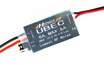

      I have purchased several PPM receivers of the "Henge" brand, which have the following characteristics:
      1. rp82l 8-channel double conversion integrated receiver is a receiver with free frequency conversion.
      2. automatic scanning and locking of the transmitter frequency can be achieved with "one button control".
      3. excellent reception performance, reception distance up to 1 mile.
      4. Dual tuned ceramic IF filters ensure accurate sensitivity and resist interference from adjacent channels.
      5. able to automatically identify and perfectly match the following transmitters: futaba, jr, WFLY.
      6. "DSP" filtering technology can intelligently filter noise to improve the receiver's anti-interference performance, more suitable for use in complex environments.
      7. loss of control protection can lose signal reception in the case of the predetermined position of the servo.
      Click image for larger version  Name:	TB2Hs4km_cCL1FjSZFPXXXZgpXa_!!140390113.jpg Views:	0 Size:	10.0 KB ID:	155811

          Yes, it is necessary to solder capacitors to the motor. But an additional BEC is also needed, not just to eliminate electromagnetic interference from the motor. Mr. Merriman's words in this link can better state the facts:Revell Gato 1/72 - Newbie no more Part duex - The Sub-drivers Forum (rc-sub.com)

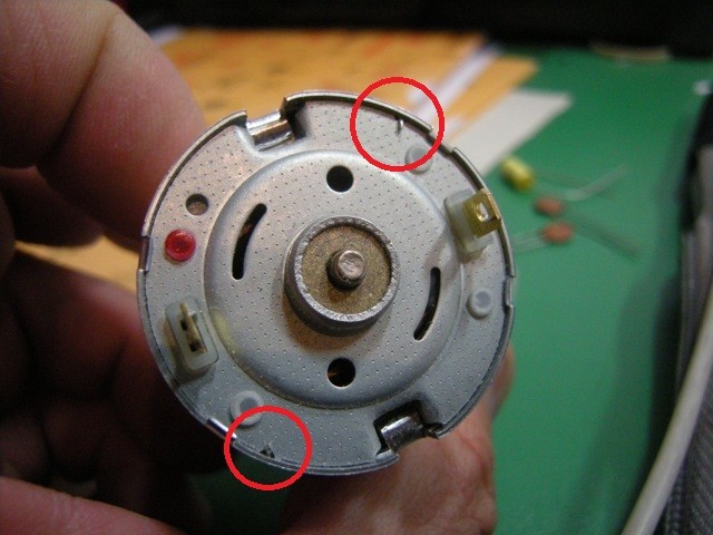

              Note: Many modern brushed motors already have capacitors -you sometimes can see them thru the vent holes or see the end of their wire sticking up thru where the backplate is crimped/pressed into the can.

                      To Gato's astute observation that some brushed motors come equipped with internal spark-suppression capacitors, I offer these examples. As he noted, the small wires projecting out from within the motors back-plate, wrapping around the external poles, is an indication of installed cap's. Such as these examples.
                      Looking at the inside of the motors back-plate you see one leg of each capacitor press-fit to a brush holder, the other leg projecting aft, outside, and wrapping externally around the lug that is part of the brush-holder. That's how current is sent to the switch-commutator. The parallel situated capacitor shunts spikes (an artifact of mechanical switching) to ground, the motor case itself.
                      During our early association with the Caswell Company Mike worked to get the Chinese manufacturer of the motors we used to build batches with installed capacitors, this move saved us from the labor of doing it ourselves and sped SubDriver production to a significant degree. There is profit in quantity buys -- just another good business lesson Mike passed on to us.
                      Keep it simple: Just two capacitors are needed to reduce the magnitude of the voltage spikes created by the sparking commutator-brush, no matter the motor size or number of poles.

                        Trouble is: most ESC BEC's don't have the ass (1.5A max) to drive the device heavy environment of a typical r/c submarine.
                        Your typical plane needs the BEC to power only three or four mini-servos that are lightly loaded.
                        A submarine has at least that many servos, that are heavily loaded as well as angle-keeper, LPB switch, fail-safe, magnetic switch, receiver, depth-keeper, and god knows what other whiz-bang-deep-sea-wonder device that have been installed to suck the life out of that poor little ESC BEC.
                        You Monsters! How dare you (hi there, Greta!).
                        No. As a matter of course, for any but the very small WTC's (2" and smaller diameter, because you can't fit all that crap into a tiny cylinder), you need a dedicated BEC good for at least a continuous 3Ampere output.
                        Hotel services are everything -- you fry the BEC, you stand a good chance of losing the boat! At the very best you have to paddle out to retrieve it.
                        Better too much BEC than too little!

                              Thanks David for the visual assist on factory internal noise suppression -here's one that is less obvious from post #6 -the pole connection is internal and the only indication (short of disassembly) is this can connection-There are many motors out there that also have owner unknowingly installed external caps...Probably not not a real issue other than being unnecessary work.
