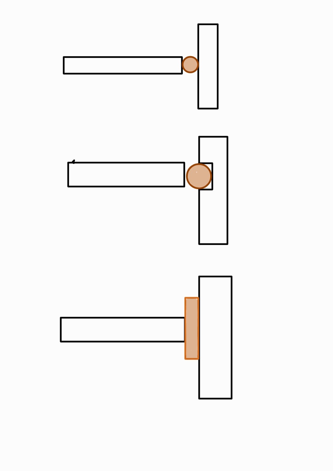

    How are the o-rings secured in OTW cylinders. Is it flat against the edge of the cylinder and face of the encap or does it sit in a recess?
    can one use a rubber mat as a sealing material instead of an o-ring? Click image for larger version

    Your illustration at the top is closest to reality. The o-rings are trapped and squeezed by the ends of the tubes, along the body section, and the end caps are exactly as you have depicted, but also have a shoulder to squeeze against in the inner diameter, which keeps things centered. It's very tough to do, but you could extrude the o-rings if you got really gorilla-fisted in tightening the thumb screws. Just pay attention to the process and tighten the crews evenly and you'll be golden!

        Bear in mind the drawbars/rods are only tapped into acrylic sheet.
          • 3466
          Regarding the rods, I'm assuming 3 in an equilateral triangle arrangement would be "the absolute minimum" number to ensure proper compression of the O-ring.
            • 2502
            Robbe managed with one. You need to be mindful of the o-ring hardness though.
              • 3466
              Thanks Andy.
