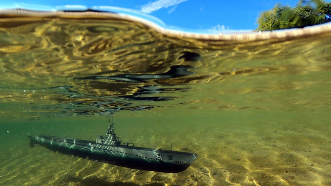

    I have not used brass detailing on my Gato, but as I understand it, you are removing enough of the plastic deck below the brass (if using the big PE sets) to offset the weight of the brass.
    Here is my build: https://forum.rc-sub.com/forum/build...vell-1-72-gato
    You want to build your own WTC, O.K., see what I have installed and create your own. We will help you as much as possible for information.
