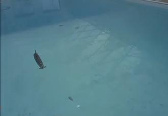

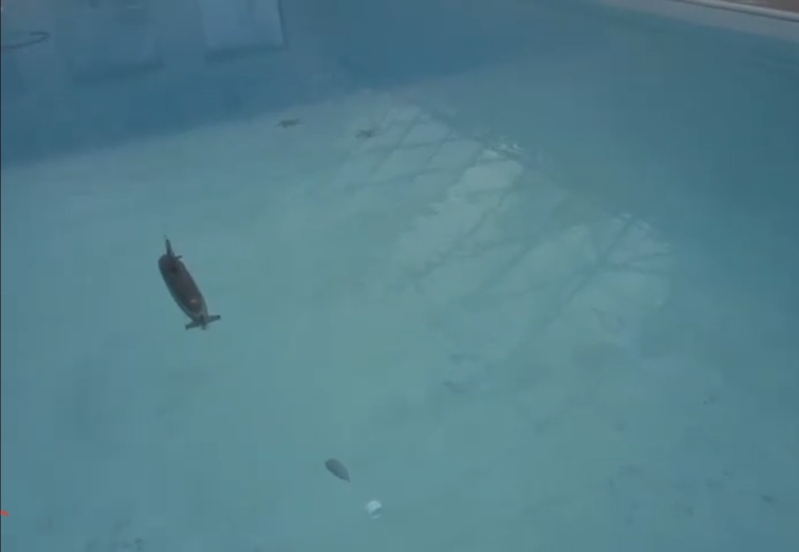

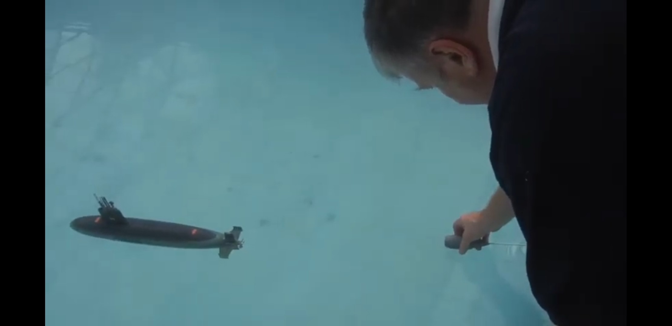

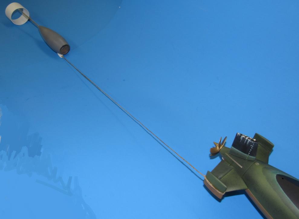

      David's 1/96 Blueback with towed 808 camera housing. Click image for larger version
ID:	150976Click image for larger version

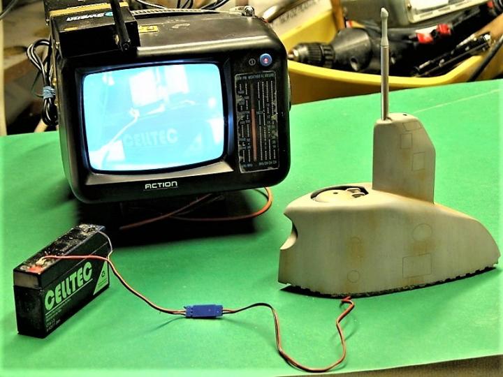

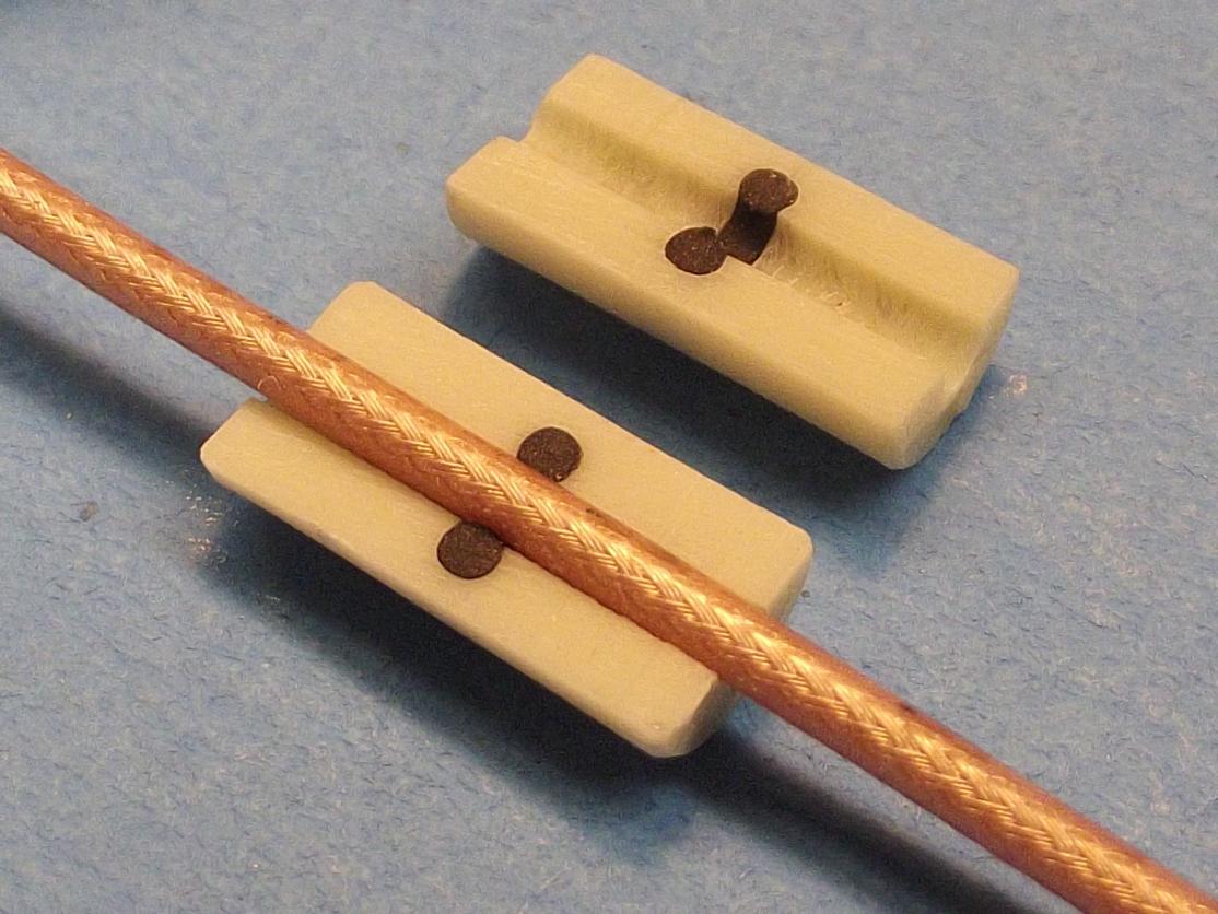

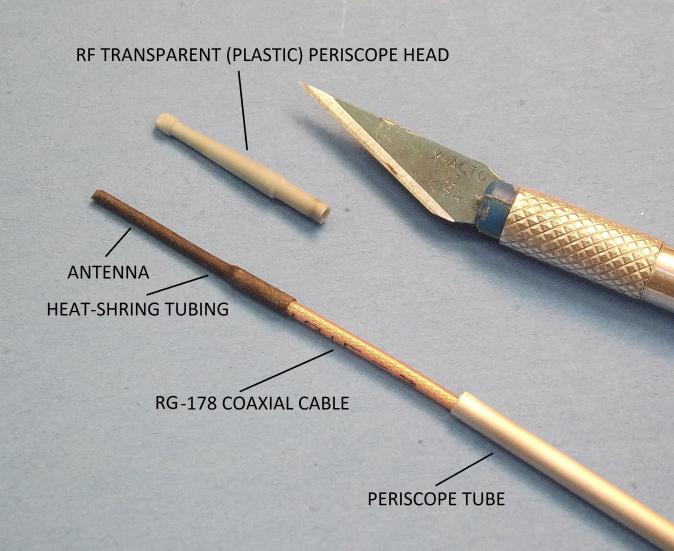

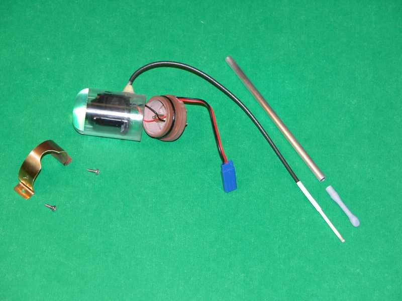

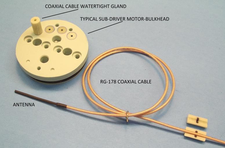

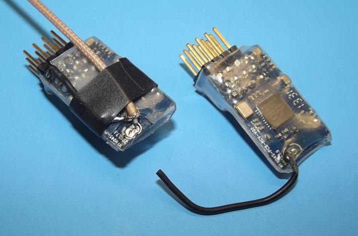

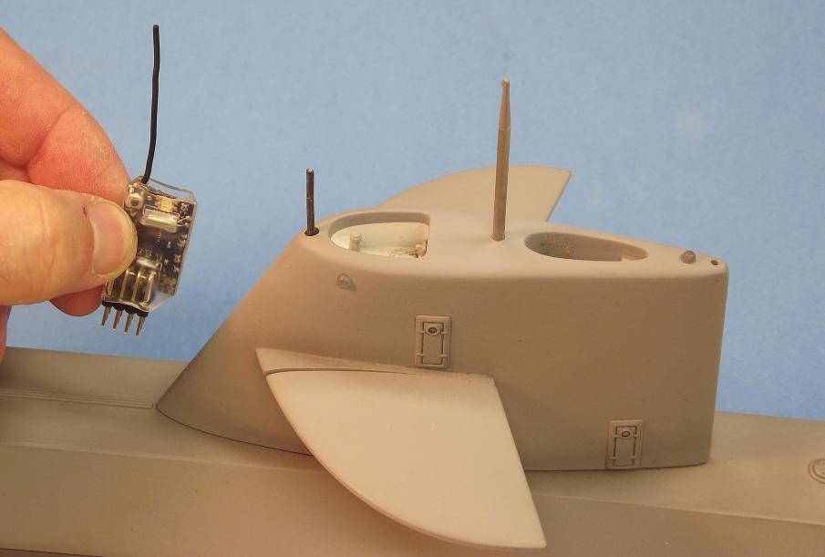

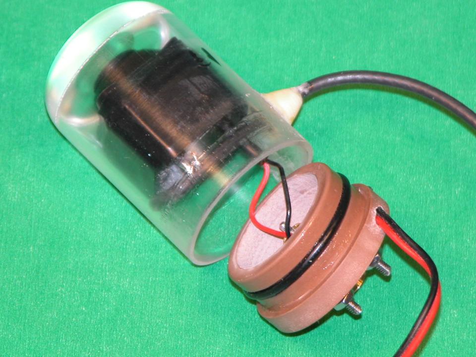

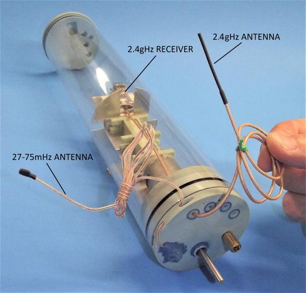

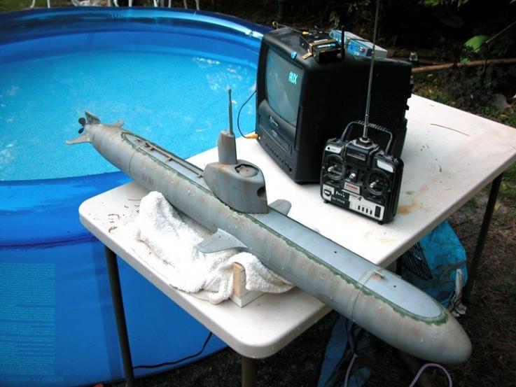

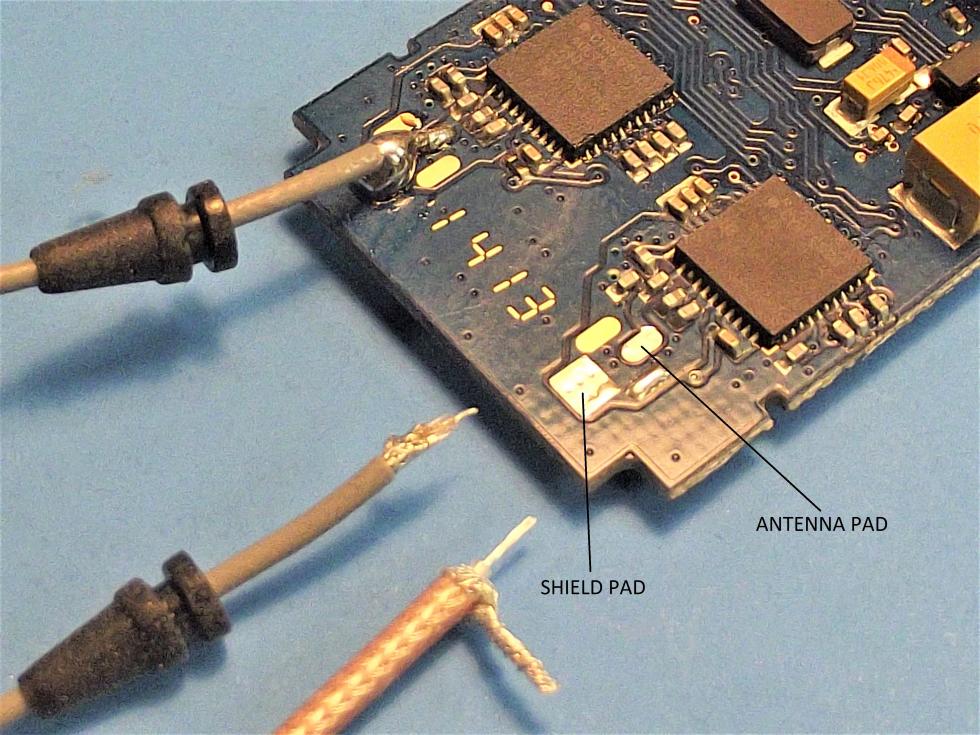

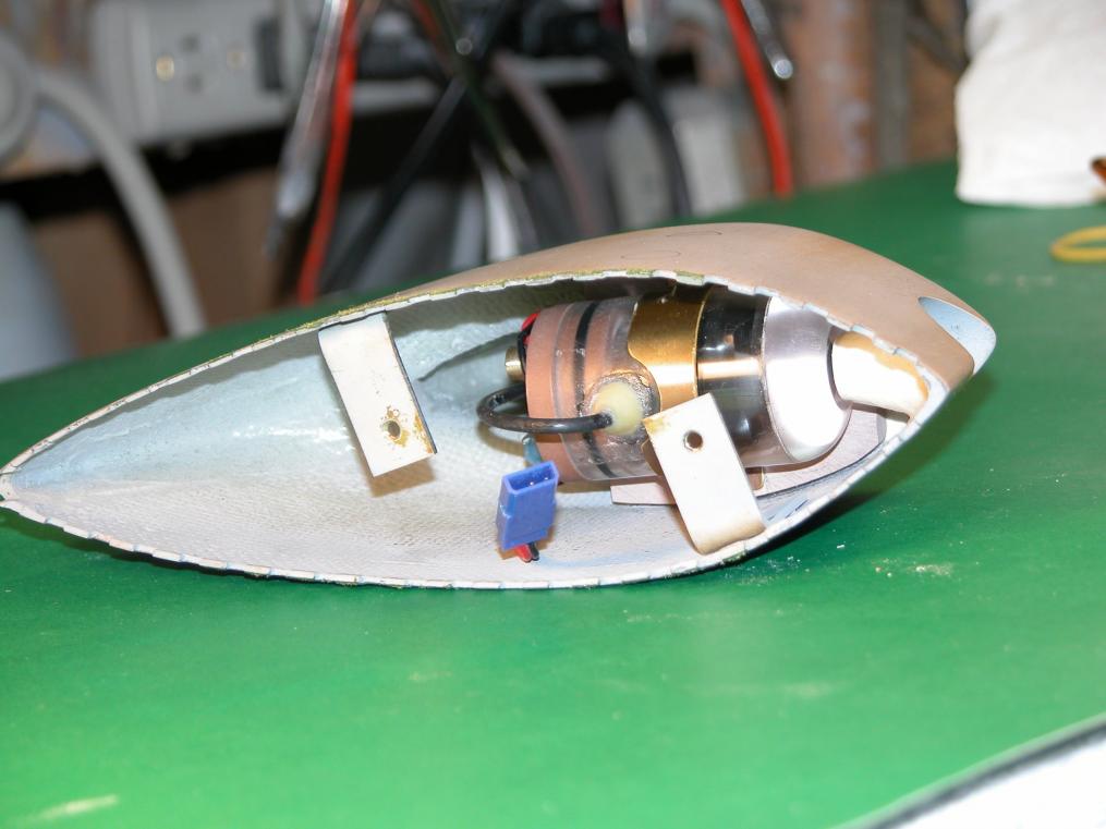

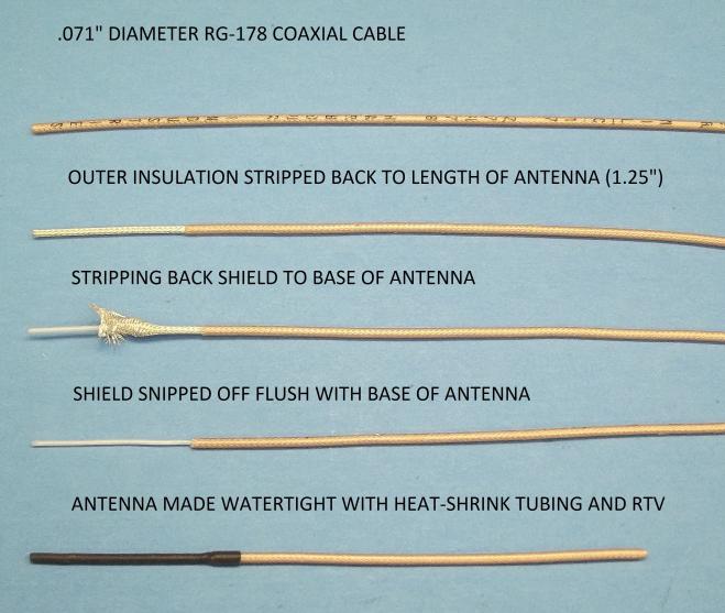

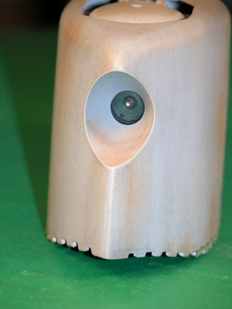

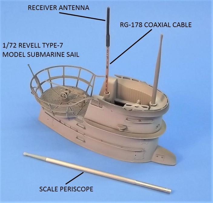

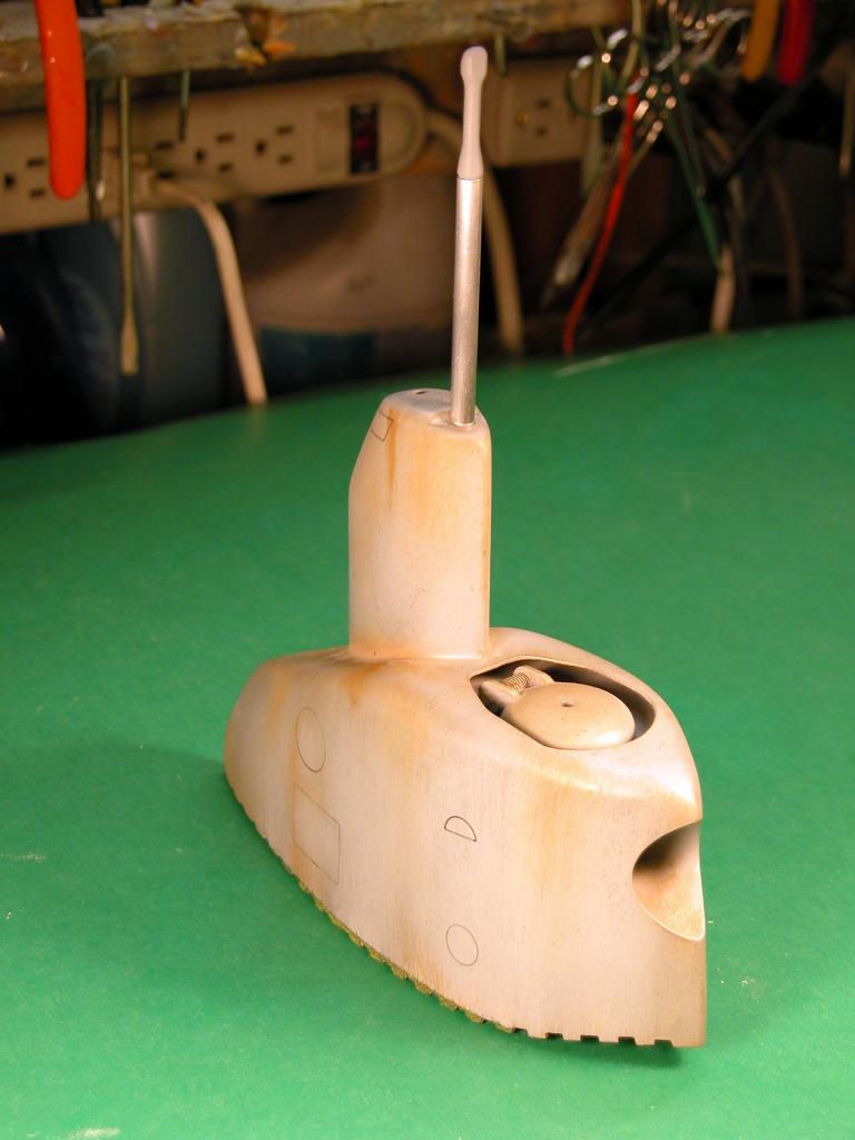

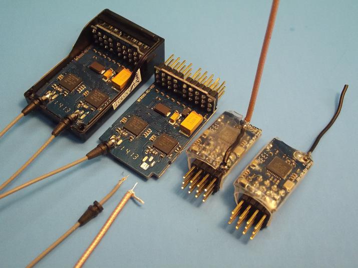

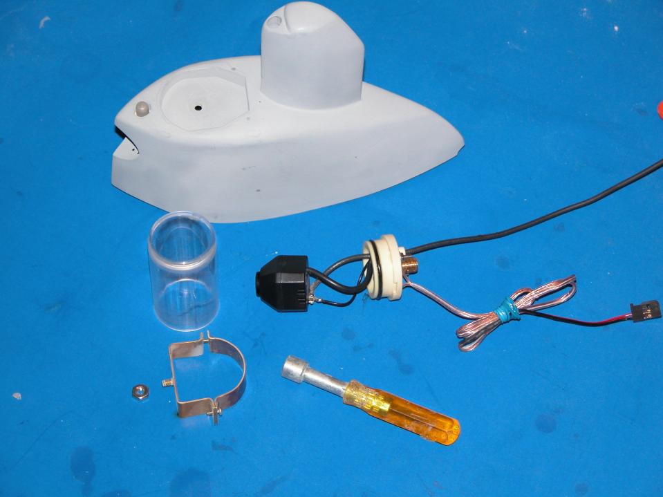

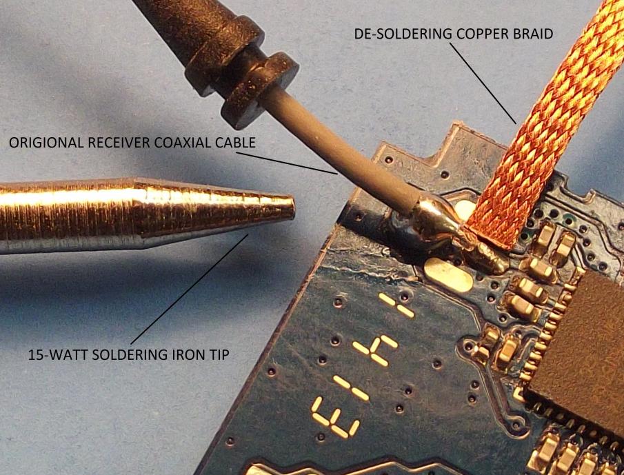

        It's an ugly, cumbersome, awkward, useless arrangement to get signal to/from your boat.
        If it ain't broke, DON'T FIX IT!!!
        God put masts atop the damned things sail for a very good reason. Use them! That's where your data-link antenna goes. Not on some loathsome, ugly fishing bobber trailing a nasty piece of coaxial cable!

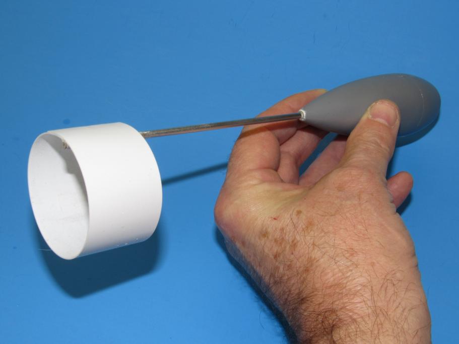

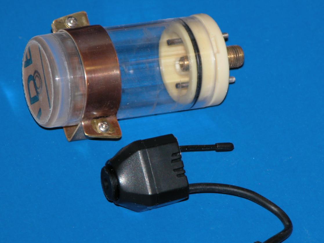

        The only tow I'll ever use is to get pretty pictures.

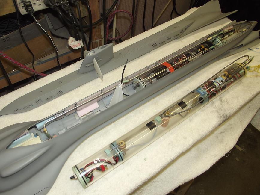

          Furthermore!!!
