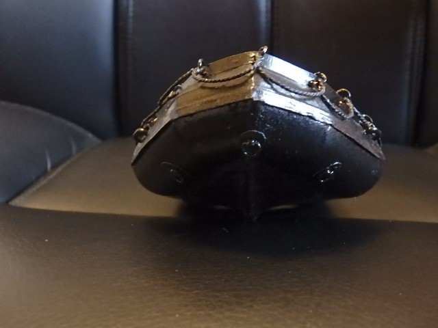

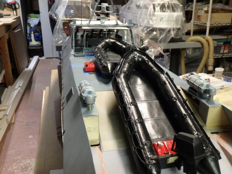

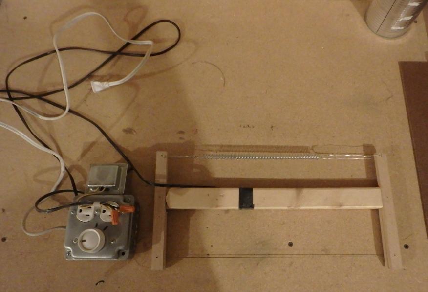

    I don't know if you can adapt this method to what you are trying to cut but I use aluminum building .005" flashing for forms to follow with a hotwire (easily made from a lighting dimmer and a doorbell transformer and some ss wire) If the forms don't work for you- you can freehand cut-clean and easy...these two pages show my making of two CRRCs for my Navy Seal SOC...I've made several masters for fiberglass hulls using this method-it not only cuts the foam -it cuts time!

      Click image for larger version  Name:	P2150044.jpg Views:	0 Size:	75.4 KB ID:	148361Click image for larger version  Name:	P2030031.jpg Views:	0 Size:	51.1 KB ID:	148362
