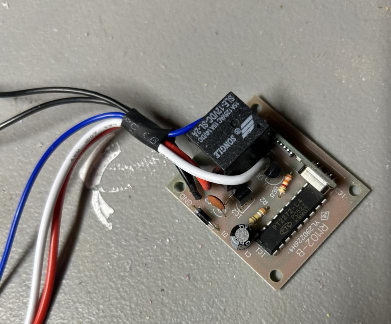

                          Not sure I want to install this 15A switch/ fob - but I would like to understand how it should be wired. Electronics is definitely my Achilles heel.
                          1) red and white go directly to the battery connectors
                          2) the two black wires are labeled as ground - I expected them to be positive and negative wires carrying current to the sub components - how can I determine there correct connection?
                          3) can antenna be coiled up to save space - I assume it cannot be shortened.
                          Thank you in advance for any assistance.

                            Black wires are common ground. Hook one up to battery negative and the other to boat negative. Red is positive in. White is positive out. Easy as can be.
                            Don't mess with blue wire length. Coil as you see fit
