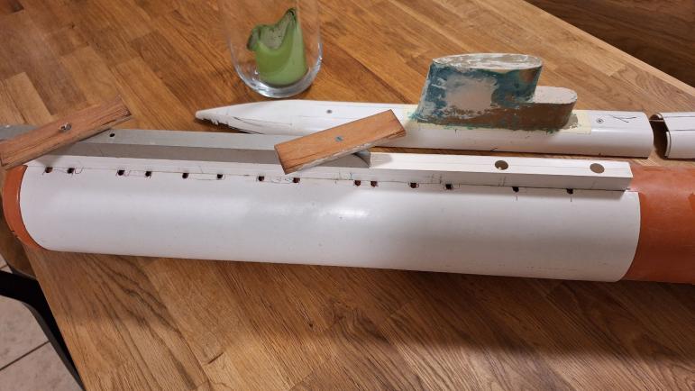

    Greetings! It has been some time since my last post as the construction of our garage=lack of workshop and cold temperatures in our attic prevented me from model building. Yet there is some progress with the SSK: Deck installation done, diveplanes&rudder are installed, residual tape marks removed, drive shaft under construction, engine mount done, major filling done.

      There are so many different materials employed on the hull. This thing will crack like an egg as it cycles through hot and cold environments.
        • 1096
        Haha, it is supposed to have a "used" look.Its weld-glued pvc on pvc. Its resing and glass on resin and glass. I guess only place with possible cracking to be the bow sphere. That thing is held together with screws and bolts and rivets.
        But yes, there are several materials involved, however there was no cracking in between minus 10 degrees and plus 30 degrees that i had outside during night and out in the sun.
        We'll see. Thats a test ship, not a centerfold;-)
