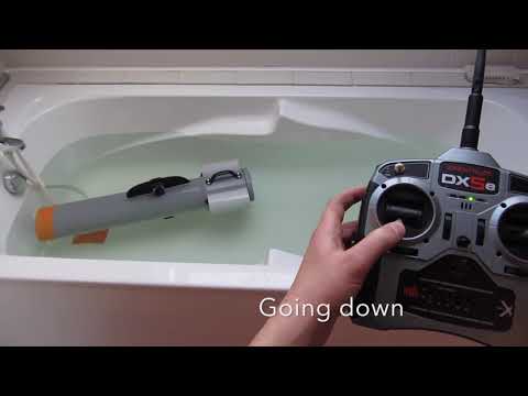

        Hi, I'm not sure I want to "blow your skirt " but my work is my first, and a modest simple RC sub, functional. At present, it works, and that is good enough for me, although it is not meant to be stylish (it looks like no historical sub, it is just functional). At the moment it is almost finished. Here is a video to show you the final result. I will post videos on youtube progressively, up to the testing of it, and using it in canals, lacs... Best William

          Hi, that very kind of you thanks. I have actually "almost" finished the sub, and have filmed many stages of its making. I will be posting them progressively but might need help, it will be welcome, thanks to offer. I am happy to share my little experience, and will be happy to learn too, Best, William
            Well, I'll be darned. It goes up, down, forward and back! That's further than most get. Well done! Very interested in seeing how you tackled the technical implementation of ballast and control. I assume the two thrusters provide yaw force by applying thrust in opposite directions?

              It works. You achieved your objectives. And did so with innovative application of devices. Well done, sir. For what it's worth, I'm impressed.
                thanks, for thrust I use 2 brushless motors (meant to go underwater), and no (sadly) they don't work separately, but together back and forth. I have 2 servos that connect to the 2 fines I made (homemade, greased axis with water bottles tops to make it watertight). (all DIY and cheap). Ballast is achieved with a large 300ml syringe that fills up and empties with a water pump I control with an ESC and the antenna receiver...Happy to see it catches attention. I will therefore try and post my videos sooner rather than later for all explanations...
                  the Humbled
                  Thanks, all DIY not very pretty but functional, a good start for me.

                    A very good start indeed. You have a good set of hands.

                      I am always cautious when someone says I am building an RC submarine from scratch. Like David and others, there are so many started, but few finish. I am impressed with what you have done. I will be curious to see it in the real world (running outdoors). It looks like you are using a 2.4GHz radio and maybe in a tub 2 feet away it works, but if it works in the wild, I will be really impressed as it flies in the advice I have been told. Congratulations and loo forward to seeing what you have done.

                        Hi, and yes you are right, I was wondering if a 2,4Ghz Radio would work underwater. My ambitions are 2 meters deep max, no more. I will test it in real soon. Can you tell me theoretically does 2,4 Ghz normally work under water? What do you use normally for underwater radio control? Still learning, it's all good fun, Best,

                          You're going to need to swap out the GHz radio. Sorry. It won't work at all for more than a couple of inches of depth at best, particularly once you get some distance between yourself and your boat. Here in North America, the frequency needed is 75mhz. 72mhz works, but is technically illegal for surface craft.

                            Well that is annoying, but I should have done more research first. I had actually and someone said it could work (less fare) but It could. Anyway thanks for your suggestion. Is their any way of "converting" my RC receive and transmitter to 72-75MHZ? Just hopping... but not very convinced... Thanks in advance!

                              Bob sells a nice 75MHz radio, it would be cheaper (and legal) to just buy one.
