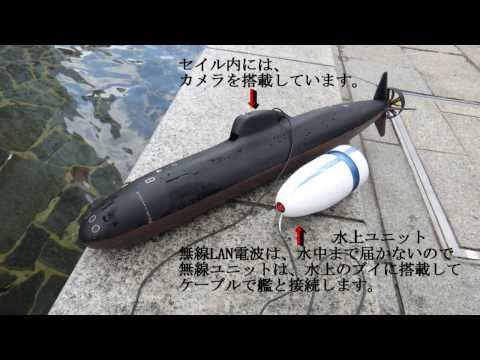

                      Sorry batter late then never.
                      all in Japanese but you get the idea.
                      I see you are using meter and a "," not '.' , so some where in Europe, switch to a used 40 MHz system, just to make things easier.
