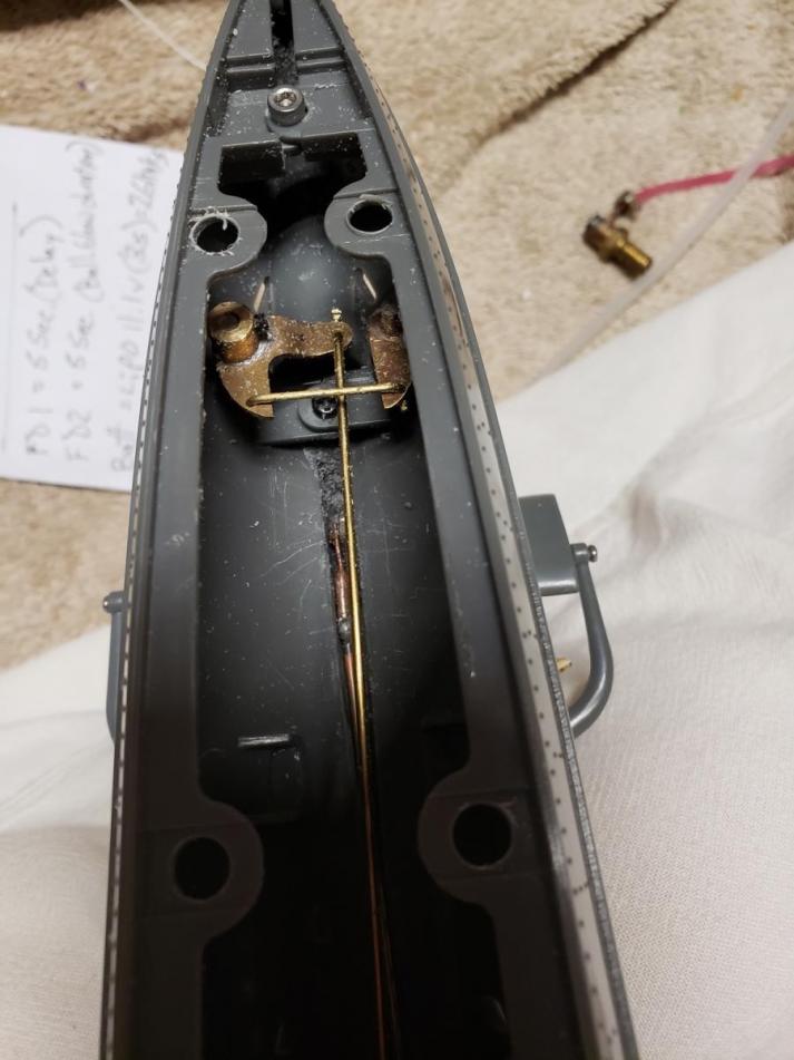

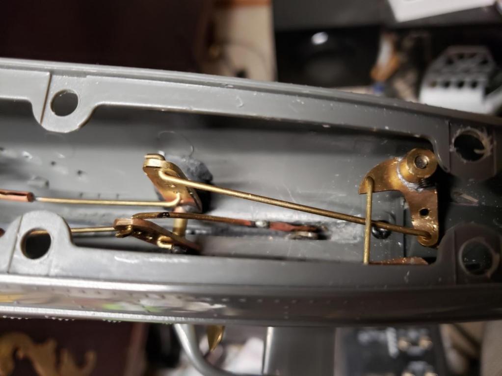

steering arm for the Arkmodel type VII 1/48th

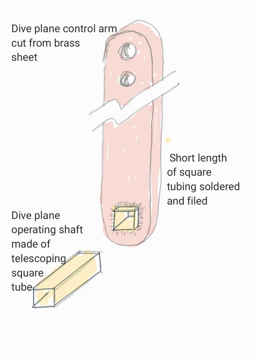

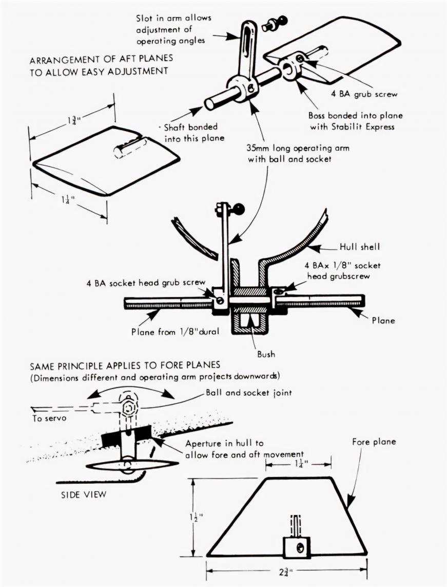

    Idea I have for diving plane control horn for 1/72 Type IX. Copied from David's cast fittings kit.
    A 3/32" square brass tubing soldered to the end of the control arm accepts a telescoping 1/16" square tube. Dive planes will be RTVed onto the 1/16" tube.
    this permits installation even if the skeg is already glued together.

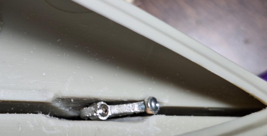

    or you could go external control horn.
    Click image for larger version  Name:	20240620_144222.jpg Views:	0 Size:	98.8 KB ID:	180913

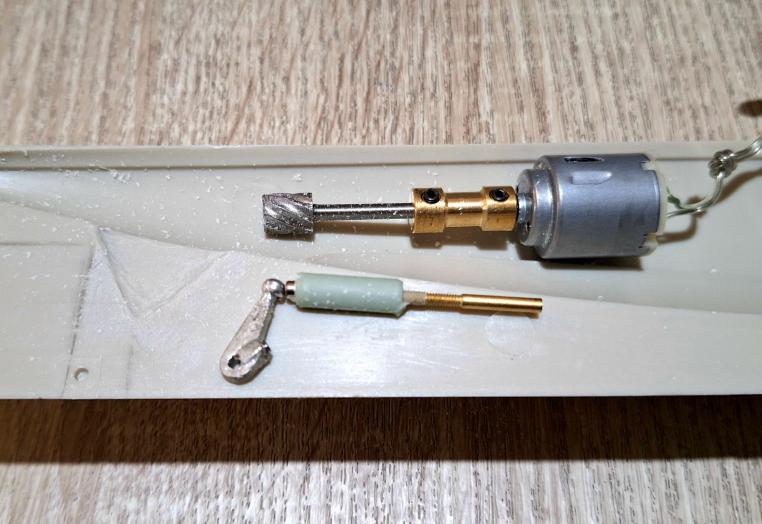

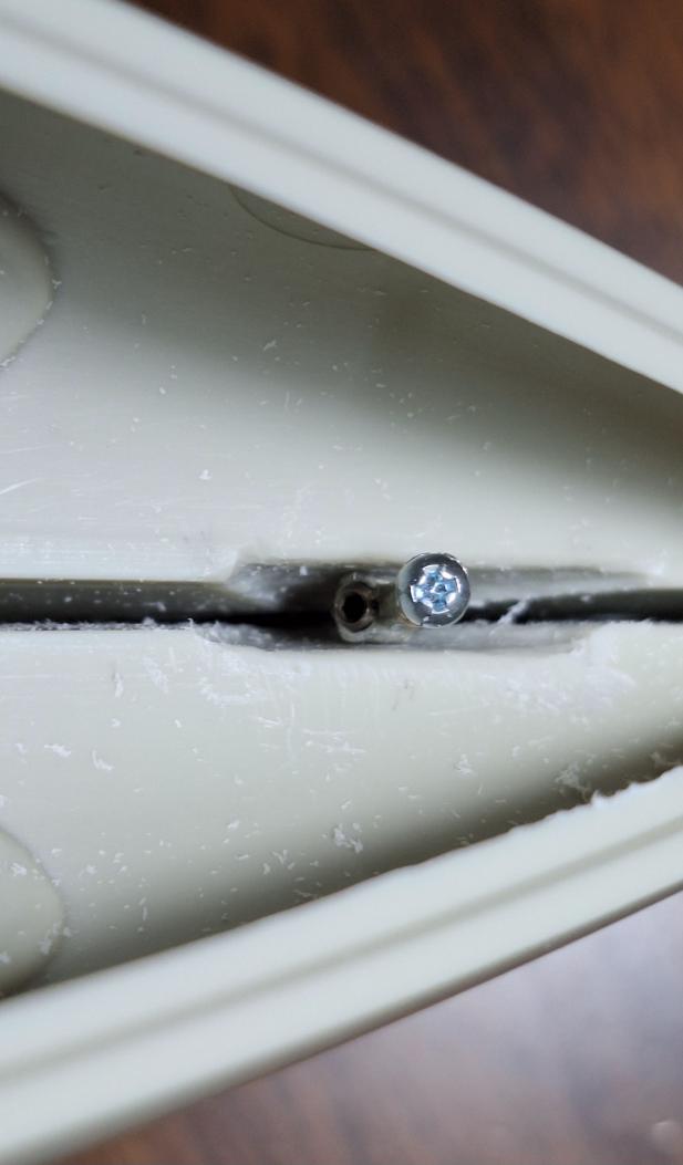

      I don't know if this is applicable to the Arkmodel kit as it's already designed to be RC sometimes if not always you need to grind out the skeg to fit in the control arm. This is what I did to my Moebius Seaview skeg. I was to lazy to bring my rotary tool out so I improvized one. Click image for larger version  Name:	20231109_105150.jpg Views:	0 Size:	56.5 KB ID:	180922 Click image for larger version  Name:	20231109_110158.jpg Views:	0 Size:	39.8 KB ID:	180921 Click image for larger version  Name:	20231109_110104.jpg Views:	0 Size:	42.0 KB ID:	180920

        I was actually thinking of this!
        I just have to pick up some telescoping tubing.
        I though I had some readily available, but I was wrong!
