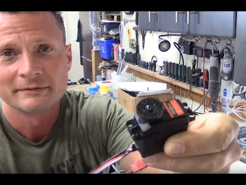

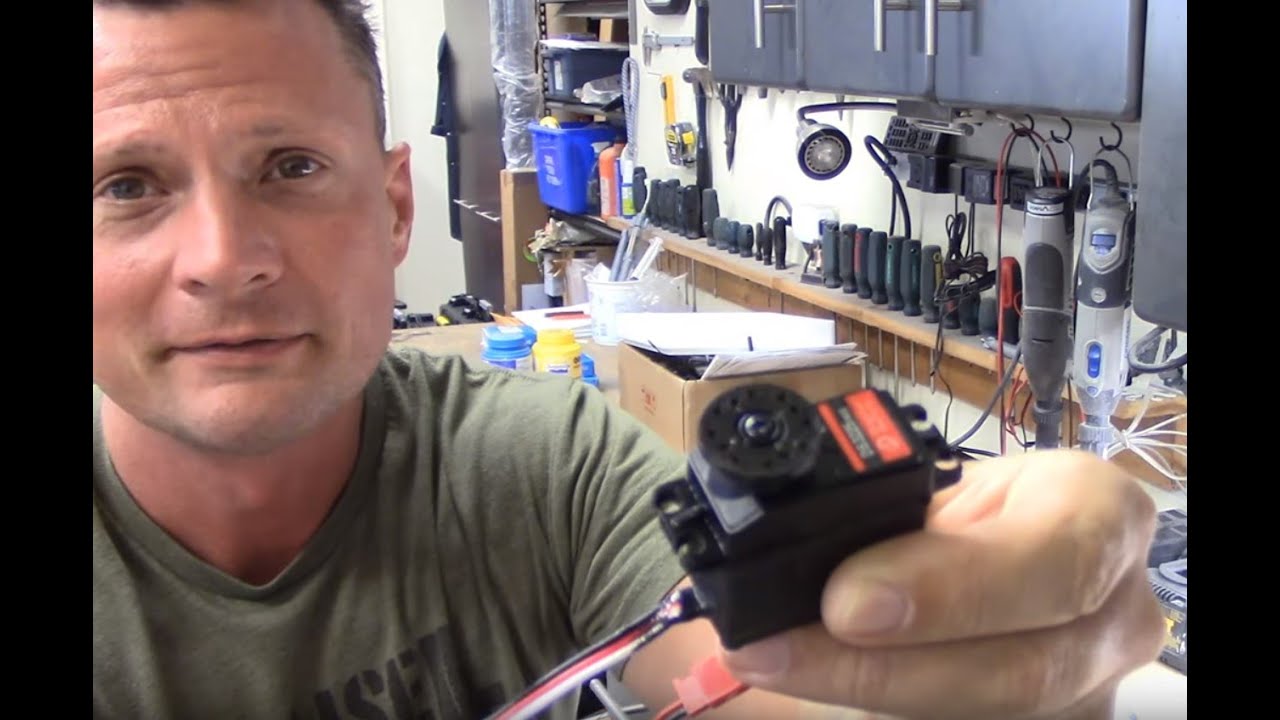

      I do it on most of my boats.
        Check out Bob's video on how to make a waterproof servo.

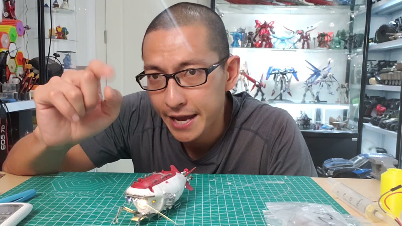

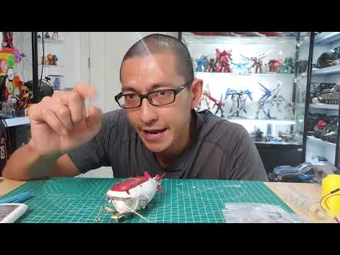

          How to waterproof your electronics.
            This guy doesn't even use a WTC. He just seals his electronics with nail polish.
              • 13988
              Stunning work!
