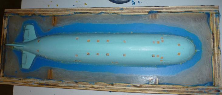

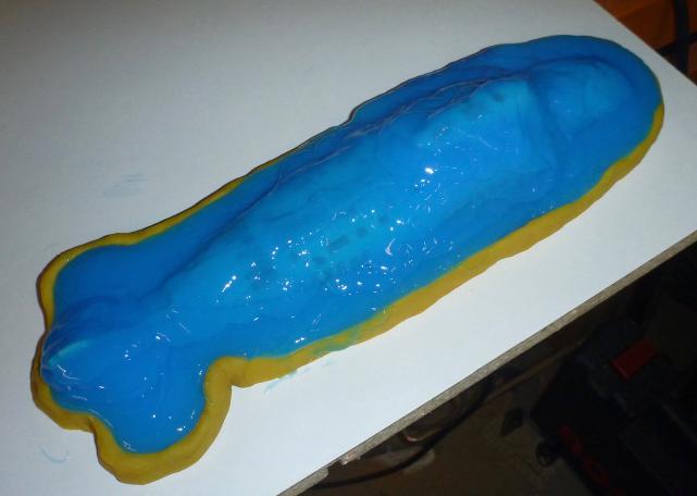

    This is the completed upper mold. Silicon inner and rigid fiberglass outer. The next step is to gloop it to form the lower silicon mold. We gloop it here, we gloop it there, we gloop it everywhere (to make sure that its really thick so that it doesn't tear when in useClick image for larger version

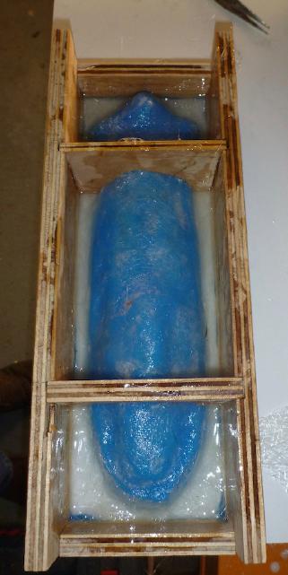

    Its epoxy resin with chopped strand, then two layers of medium weight cloth.

    Looking at the bow of the last picture, it looks like a cloth is used, is it? Did you pour something in the squares of the frame?

    This is the upper mold. I'm using DavidH's bracing method. Should be super rigid.

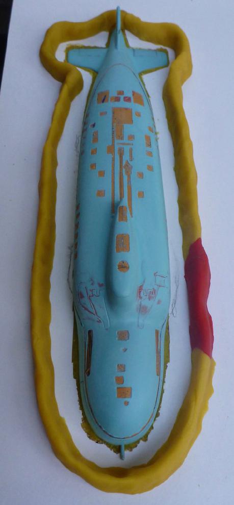

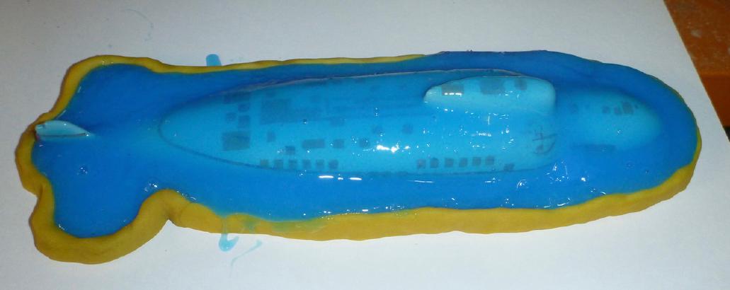

    Onward with the gloop monster. This is pre-thickened silicon molding rubber - and its just a bit too runny, hence the play dough dam around the Piranha. Once this goes off I'll give it a second coat to ensure that the rubber is nice and thick.

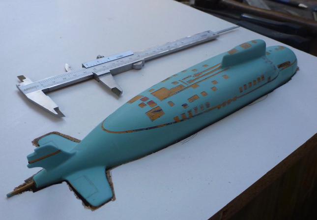

    Moving on to your sub, it came out really nice. The hatches and storage on the deck, are you planning to put inserts in there or brass etchings? I guess I am asking, what are your plans to finish the deck?
    I'm teaching myself to photo etch brass, so the plan is to inlay gratings and hatch covers. I went that way because my ability to etch is woeful and I figured that if I inlay in brass the bits will at least be square and sharp.
