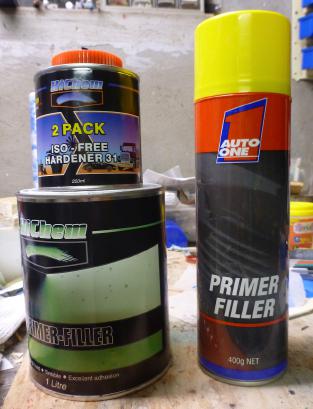

    replied
ID:	114345There are single pack spray primers which will build up the outer surface of the model slightly. The can on the right is a single pack filler/primer. On the left is a two pack primer. The base primer requires the addition of a catalyst to set it. This produces a much thicker layer of cured paint which is what I'm looking for. Once the paint cures I will remove the masking tape to reveal all of the detail of the vents and hatches. Later on I'll drill out the centres of the vents and glue brass gratings into the recesses left by the masking.
    Leave a comment:
    replied

  • zhuravlik
    replied
    HardRock, I'm very interested in this high build primer. How does it works?

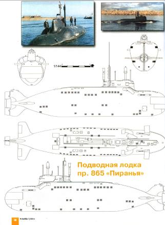

    Piranha drawing. This the best drawing that I've found so far.Click image for larger version

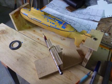

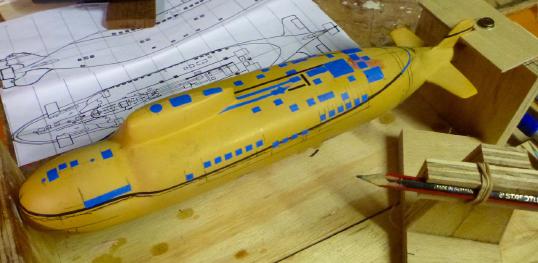

    replied
    More little blue squares. Once I've got all of them on I'll spray a high build primer over the model and let it sit for a while. Once dry the marsking is removed, revealing a slightly indented area which indicates where the holes and hatches go on the finished model. This simple wodden jig keeps everything streight and level - I hope.

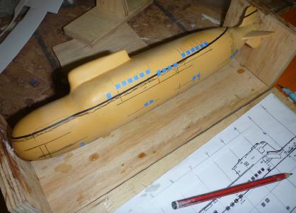

    replied
    Slowly, slowly, catchie corn doggie!

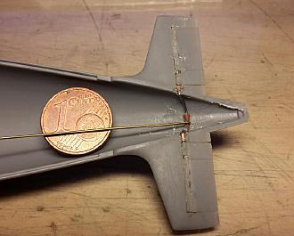

  • zhuravlik
    replied
    Beautiful subject, HardRock.
    Fast and good work too!
    Redboat, your links are precious.
    But no stern cone is too narrow. Click image for larger version

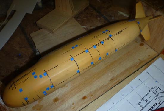

    Getting on with marking the casing flood holes.
ID:	114309Click image for larger version
