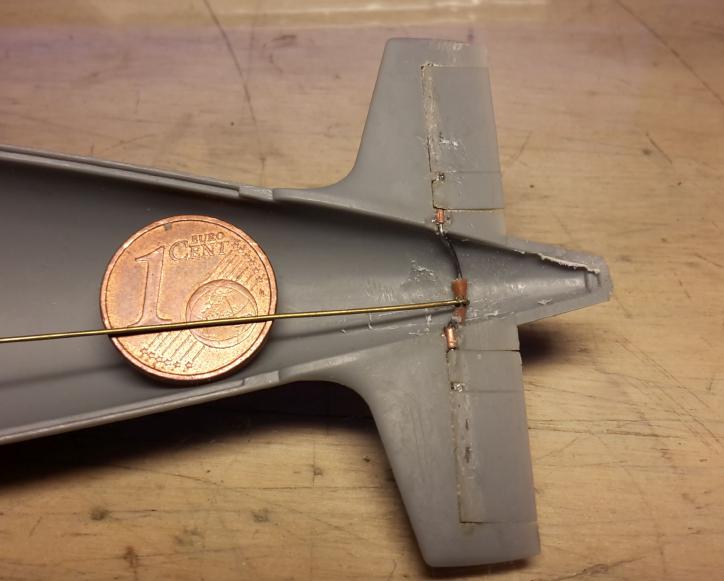

      But no stern cone is too narrow. Click image for larger version

                HardRock, I'm very interested in this high build primer. How does it works?
                That's the stern cone of a 1/350 hobby boss Yasen.
                My Kilo gone MIA in 2010.. :(
