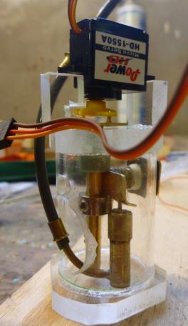

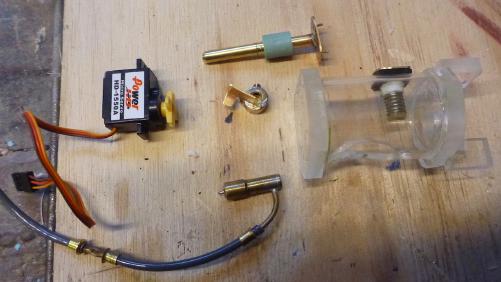

        This is the test ballast tank. There isn't enough room to use the leaver action vent valve so I've made a rotary version. As the servo rotates the shaft counter-clockwise, the cam opens the valve on the top of the tank; when it rotates colkwise it depresses the valve stem on the gas valve. The shaft runs through a waterproof seal and a bearing and there is a small detent in the rear tank wall that engages the shaft end to prevent the shaft deflecting. And it all works! Now I just have to stuff it into the submarine.

          Wow! 2 thumbs up.
          How many blows are you getting out of that tiny gas cylinder?
          That is easily convertible to snort set up.
