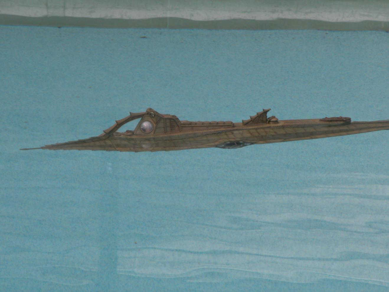

        Just got back from the local dive-shop training pool -- first 'open water' trials of the NAUTILUS. By and large, I'm very happy with the performance. Though 'collision speed' will always elude this model, depth control -- always the big issue with the Goff design -- was assured and quick. The turning radius sucked, but was acceptable. The model, surfaced and submerged, could cut a twenty-foot circle. The water was crystal clear and being an indoor pool was glass smooth. I'll bring the cameras tomorrow for the customer check-out session there and will share that here.
        The model looks simply beautiful underwater going along at a fair clip without need of any practical horizontal control surfaces. It's official now: the two-axis gimbaled propeller makes it possible to operate a Goff NAUTILUS above and below the waves.

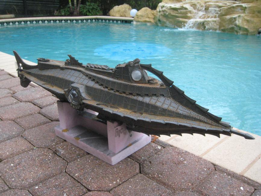

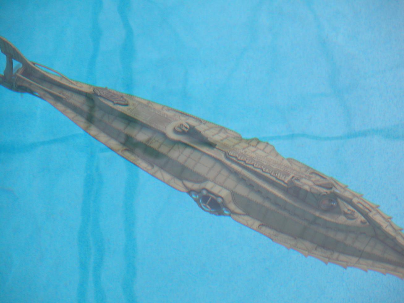

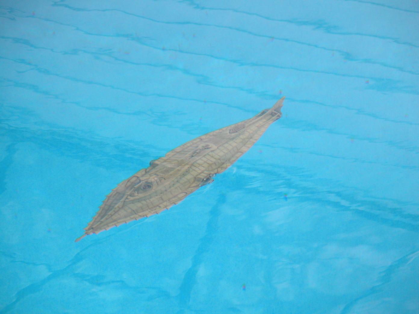

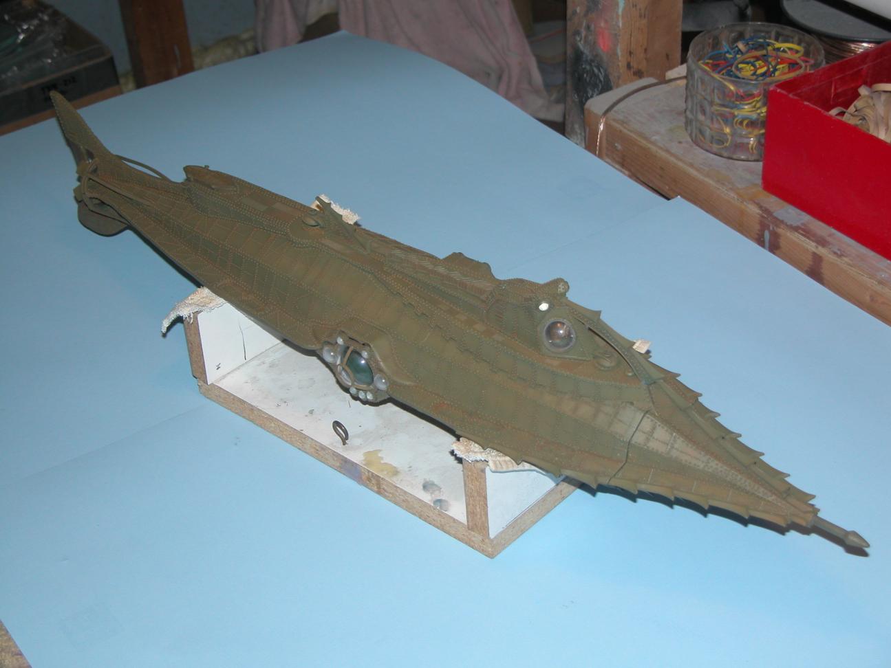

                  OK, lets see if this works. By the way, if these come out ... you're looking at my last chance to play with the little 31" Disney NAUTILUS before it was handed over to the client. These were taken this morning

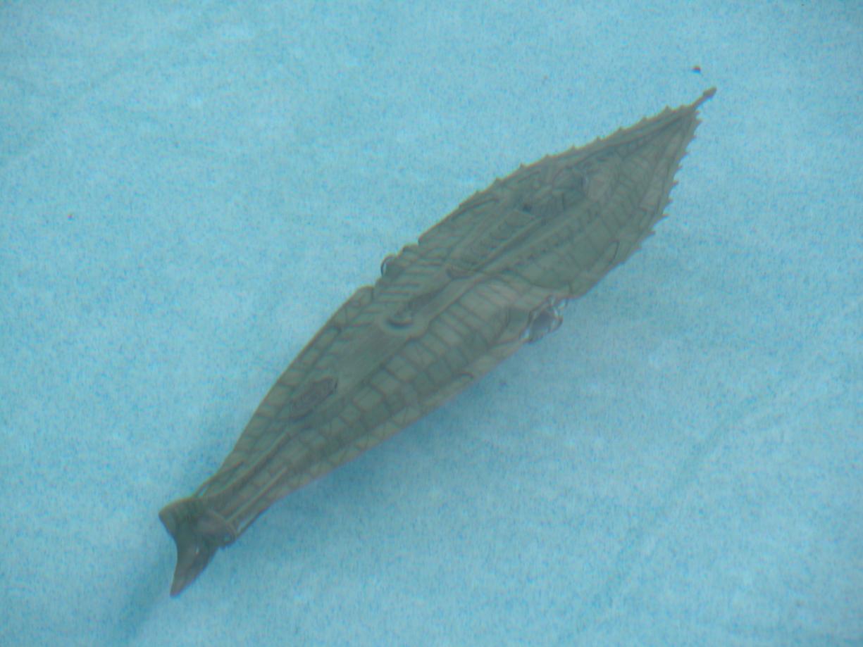

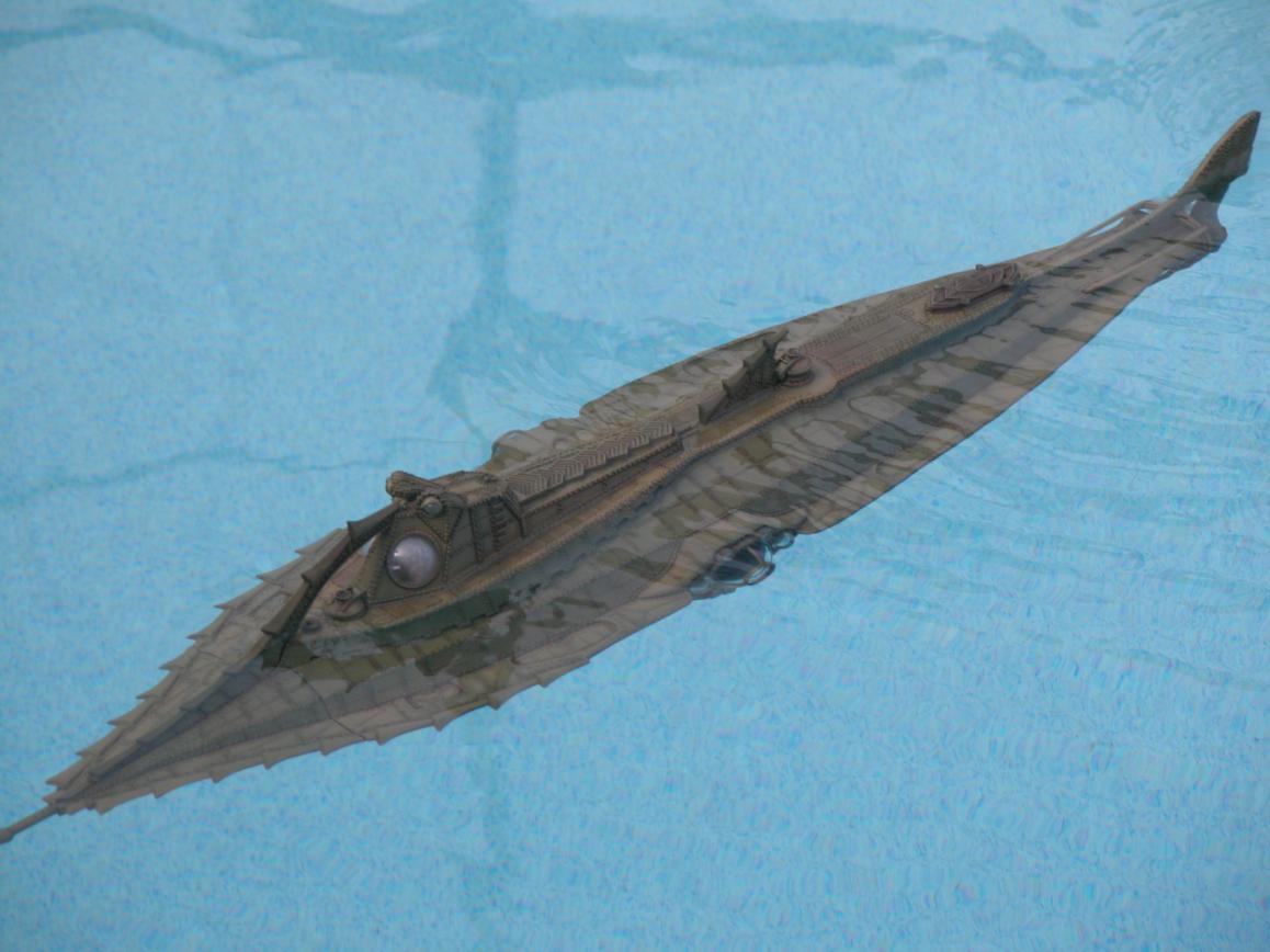

                    More filthy pictures.

                              Damn! Dave, I just got around to checking the forums here for the first time in a long time and look what I've missed! Jeez.
                              I don't want to steal your show, but I had some comments:

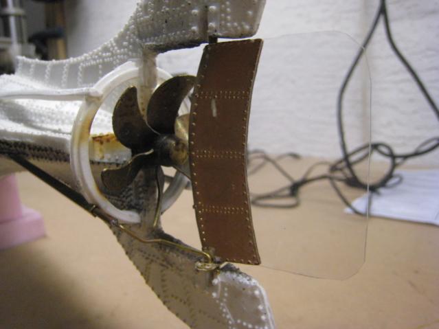

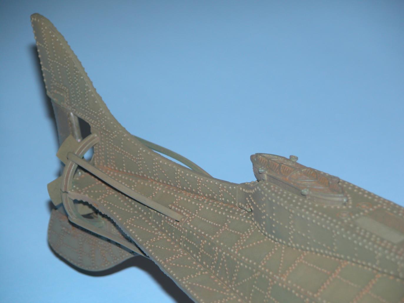

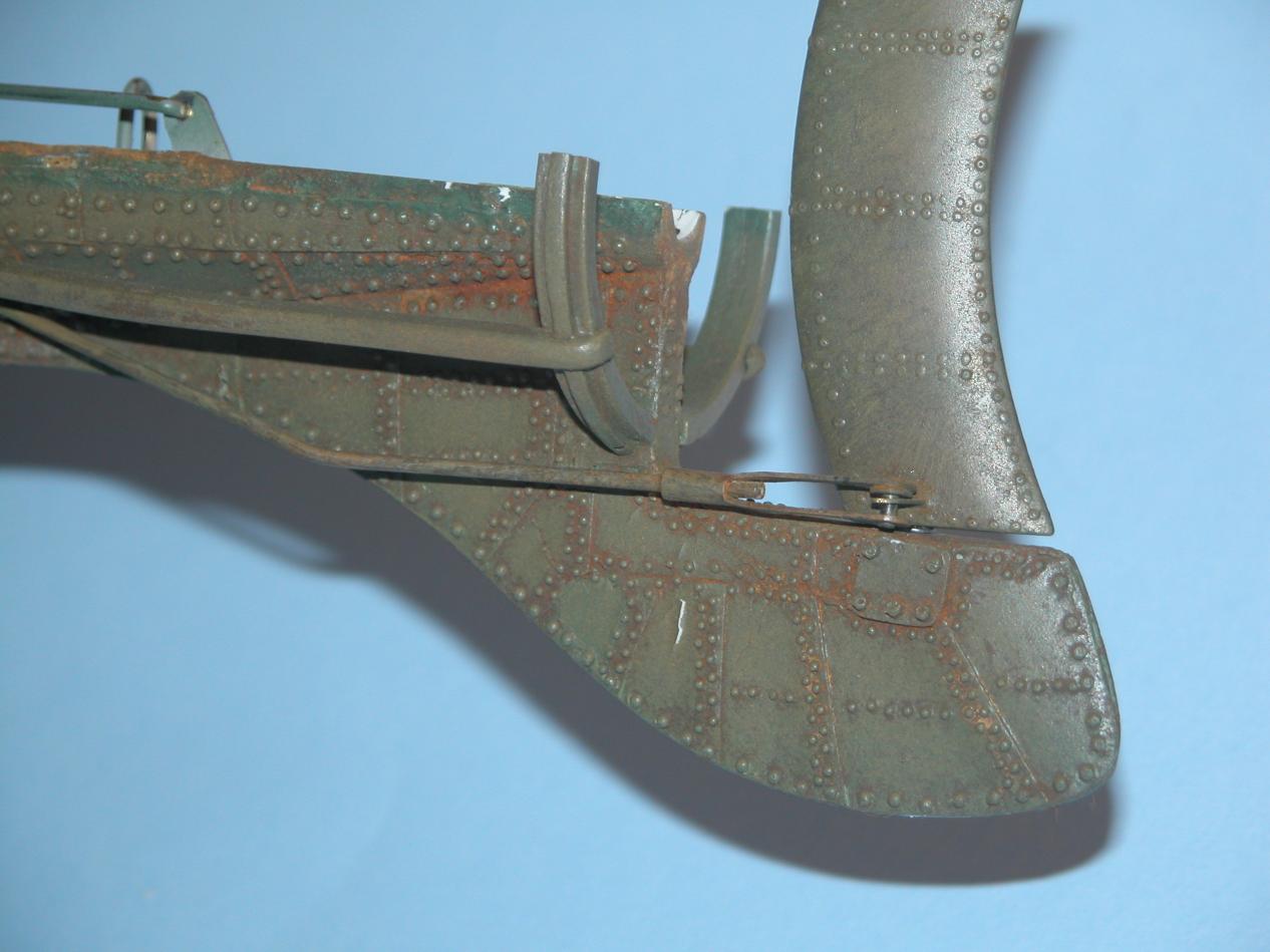

                              If and when you tackle this again, I came up with a neat routing for the rudder linkages (see attached). You just use a replacement prop shroud support to run the linkage arm in. This hides the rod from casual observation quite nicely and just clears the outer edge of the prop.
                              I also used a razor saw to score the back edge of the stock rudder and press-fit a piece of clear plastic in there. I would estimate that the turning radius went from the aforementioned 25' down to about 7' (I was able to turn her in my 12' wide pool with room to spare). If it goes on display, you can easily just pull out the plastic and set it aside for pool operations.
                              I also found the best split was a single cut just forward of the prop shroud support arms. I used a tab in the rear and then used the ram to secure the front. No visible screws at all.
