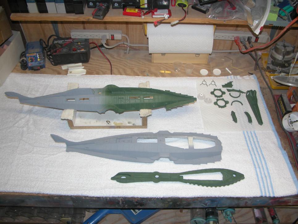

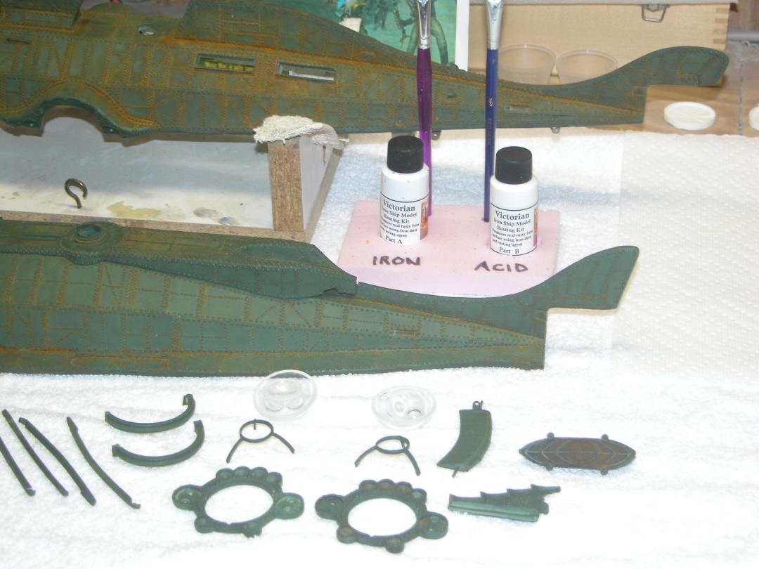

    Finishing up a turnkey job, the TI 31" Disney NAUTILUS.
    • 2642
    Different colour scheme.
      • 13997
      Not done yet, Andy.

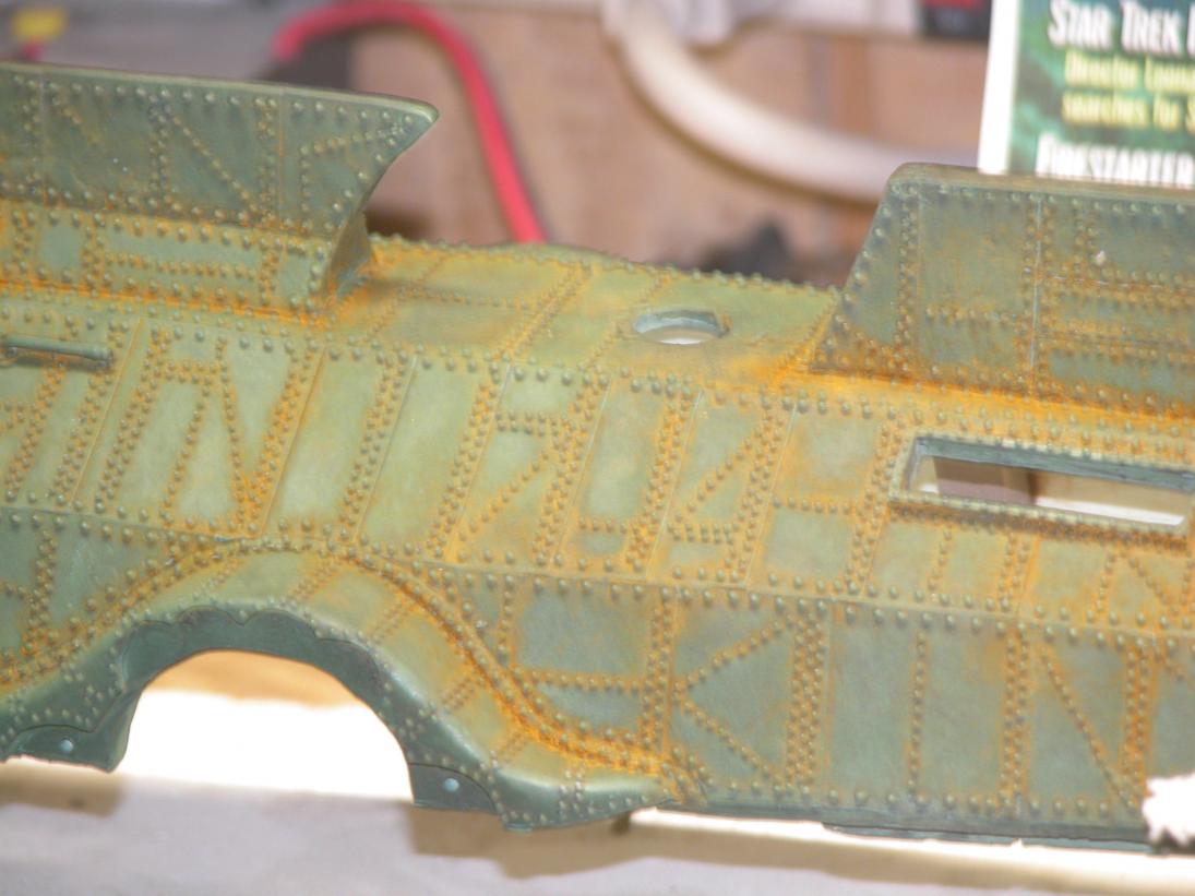

      After the primer gray I laid down the green. Just enough of the green will be left when finished to suggest verdigris. The rust and green will tone way done after I apply the 'dark bronze' final color. Then a very flat clear coat to protect the paint and stop the oxidization of the rust wash, and I'm done with it.

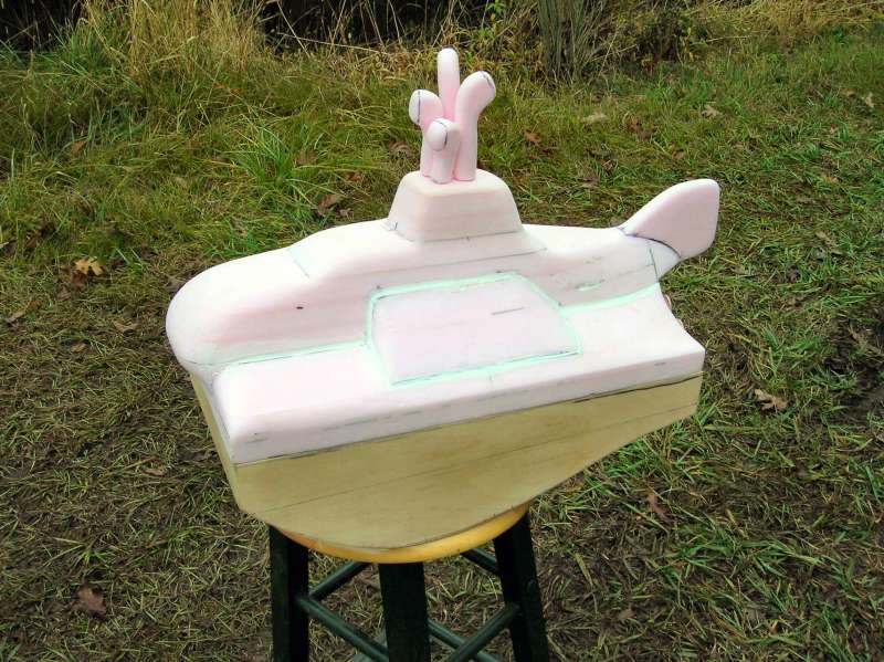

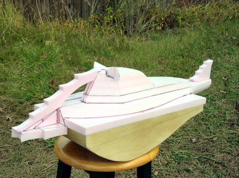

                      At any rate, this is what I've been up to...
                      As my intro to RC boats, I'm building a Springer tug, which is a simple generic hull that will accept a variety of superstructures. In addition to the typical tugboat-top, I'm making two other tops for it, using 'glas and the lost-foam technique...

                        Now that is neat stuff! It looks like someone is going to beat Andy to the punch getting the Beatles Sub into the water.
                        Your character of the Disney NAUTILUS looks to be a fun little thing too.
                        And ... all original work. Bonus points, Bill.

                            It looks like someone is going to beat Andy to the punch getting the Beatles Sub into the water...
                            Nah, this will be a shell of a surface-runner, Andy'll be into the water by a longshot. I've got two boats in line ahead of it. I'd been toying with the idea of an operational YellowSub and came across a photo if Andy's hull (or plug). Exchanged a couple of eMails, and the idea went from "Hmmm" to "Do-able". It'll be interesitng to see how this turns out-- we're using different sources for our respective "One And True" Yellow Sub.
