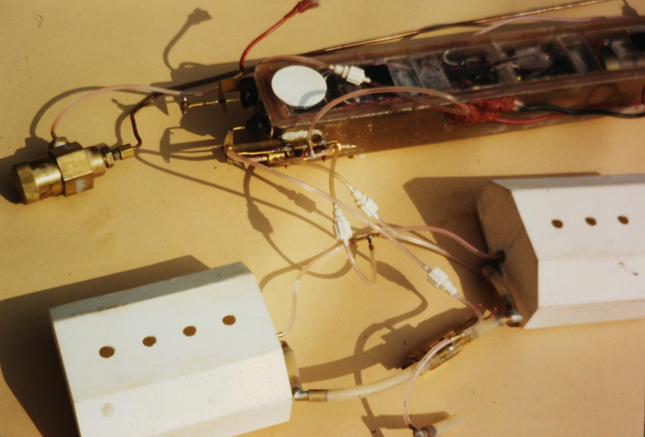

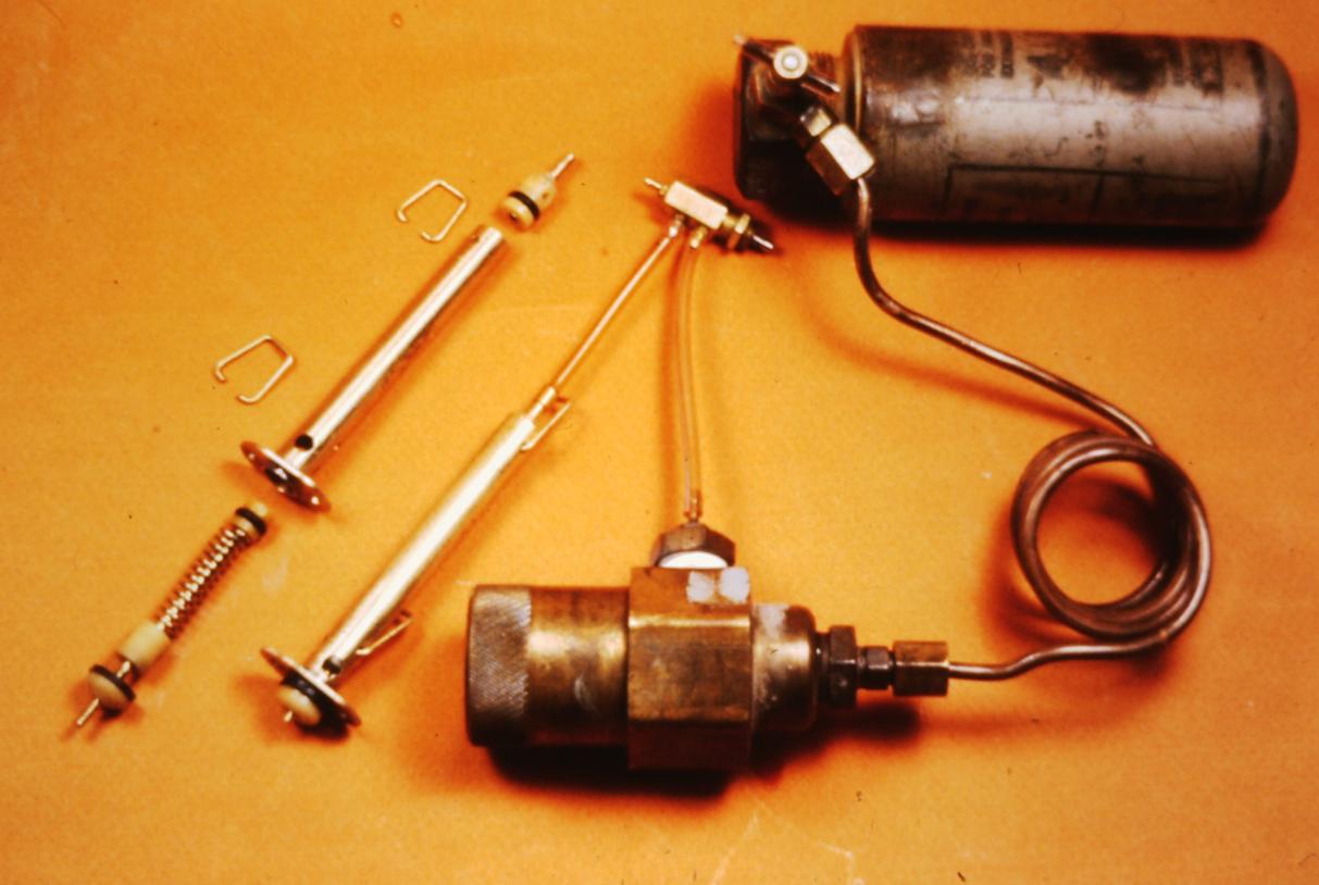

          I was wrong as to the date of my first r/c submarine. It was shortly after I got out of the Navy, which was in 1988. Looking at the dates on the slides I took at the time, puts my first r/c submarine being built in the early 90's. I was building a lot of static display pieces in the mid-80's (plank-owner models for sub crews and defense clients), the source of my confusion no doubt.
          Simon and Sheila Smith were innovators and hard workers. Their vacuformed 1/32 Type-23 introduced many people to the r/c submarine world. For what it was, it was the door-opener to many who wanted to get into the game. Innovative stuff: vacuforming, resin casting, and the most rational gas type ballast sub-system produced at the time. Yes, Freon-12 was the liquid/gas of choice back then.

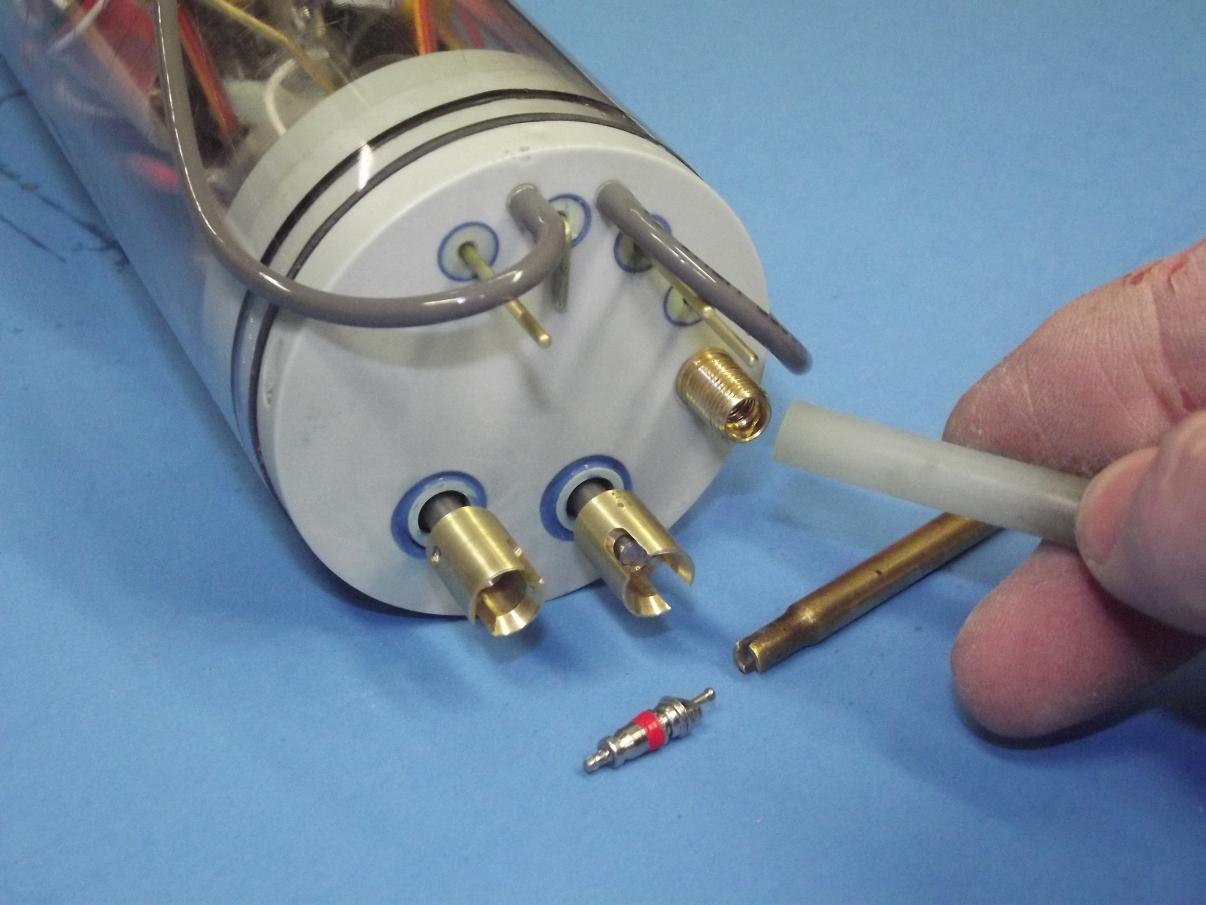

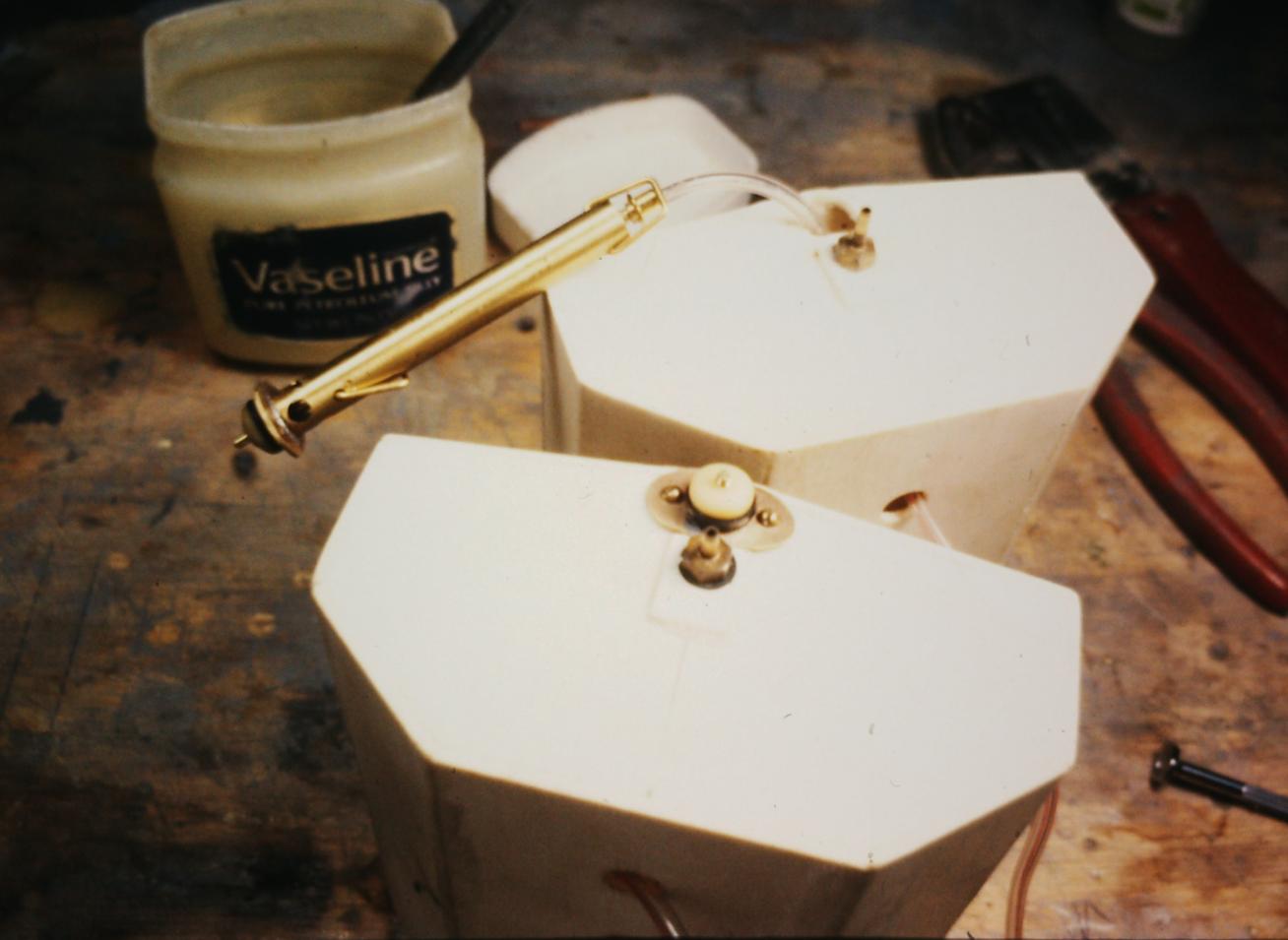

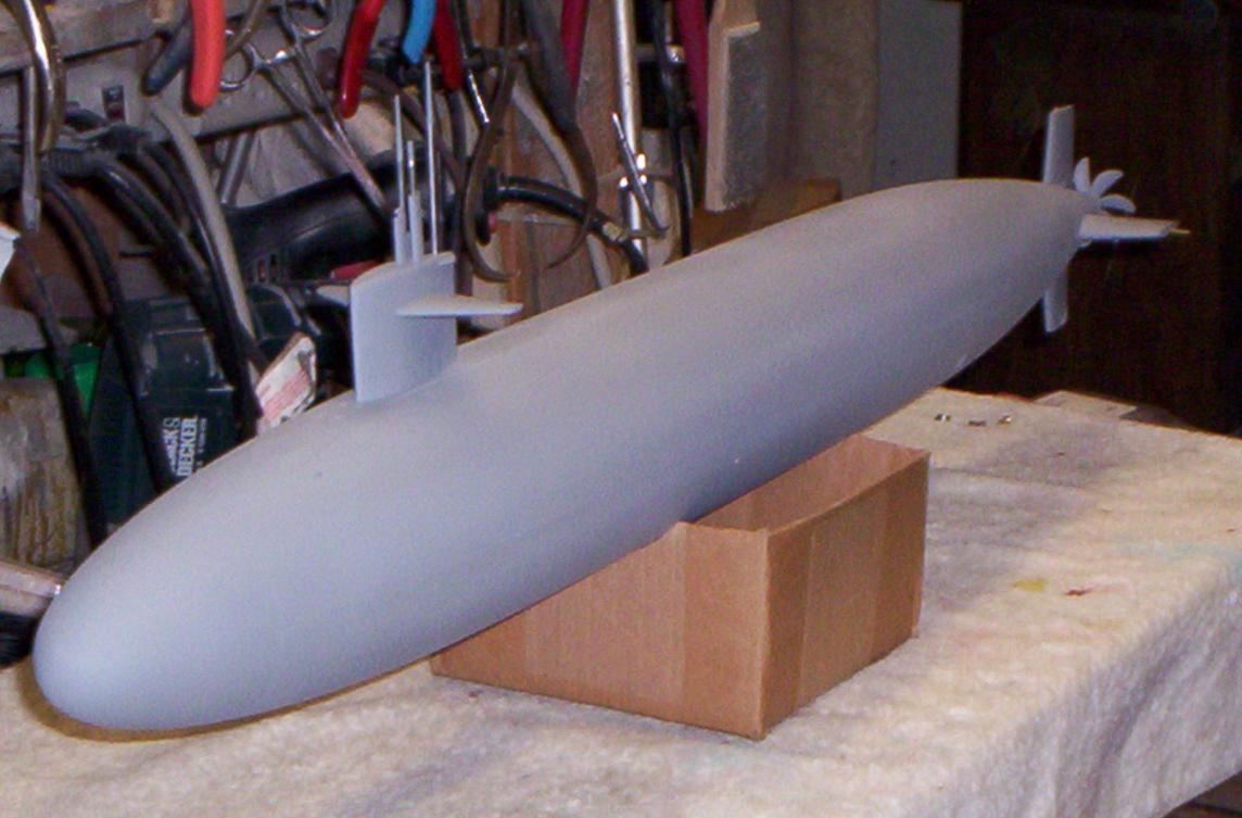

          The first WTC arrangement for the AKULA employed Freon to blow ballast water.
ID:	93155 Click image for larger version

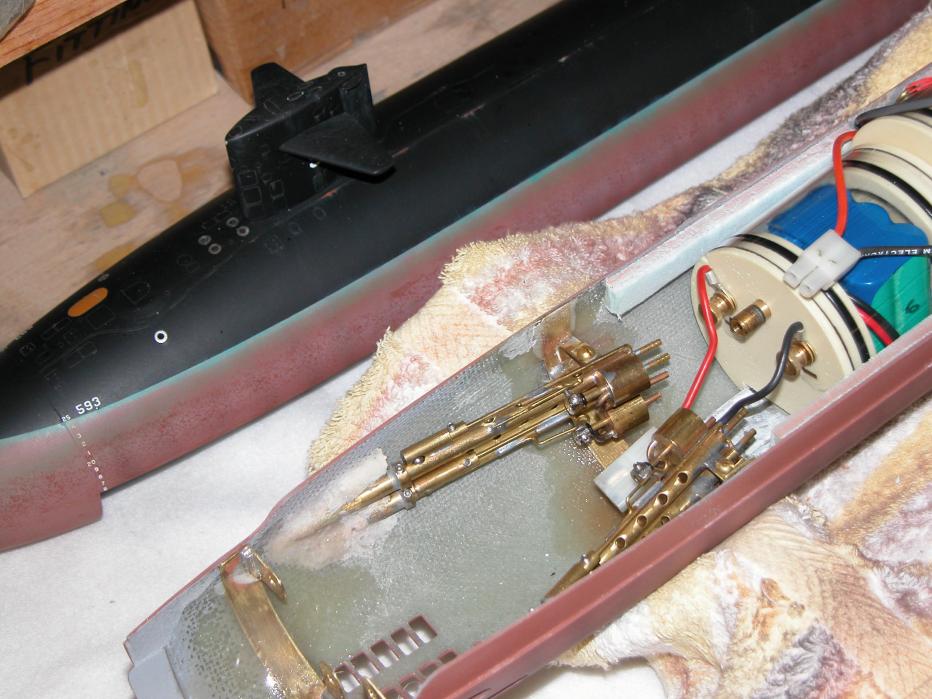

ID:	93156 The second WTC arrangement, which employed a single WTC box, made use of CO2, the medium-pressure gas reduced through a Williams regulator to a more manageable 40 psi.
ID:	93157 Click image for larger version

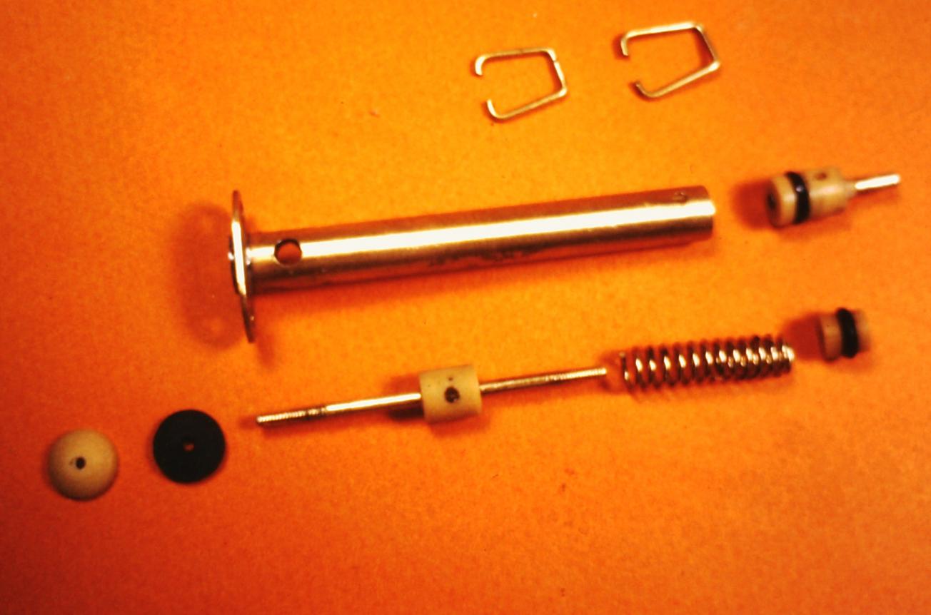

ID:	93158 I also used CO2 gas to actuate the two vent-vent actuators, one in each of the two ballast tanks.

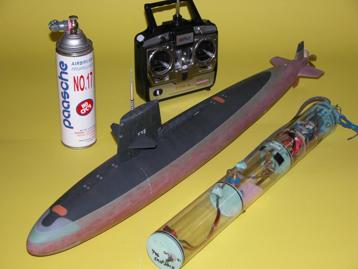

            Can you post their good points?

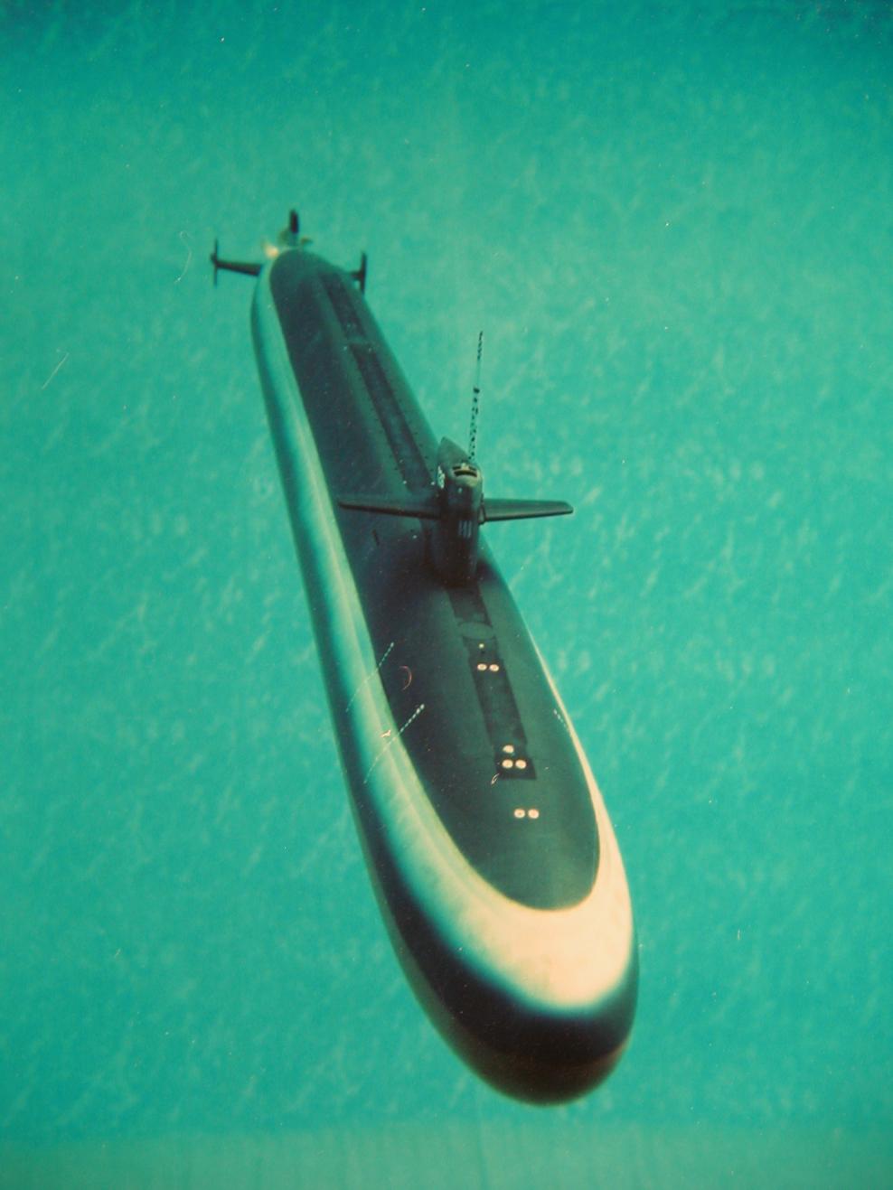

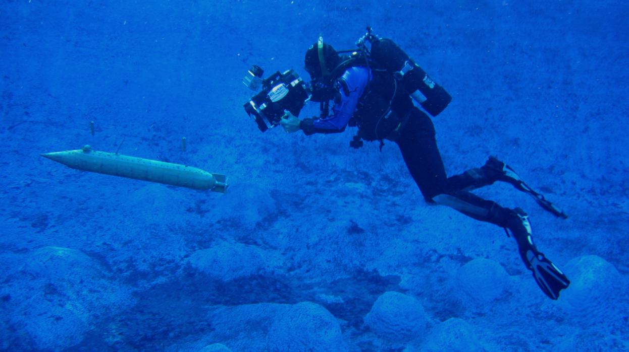

            The sweetest running r/c submarine on this planet is the 1/96 Thor STURGEON. Turns tight, is fast, and is easy to transport and maintain. Rock solid depth control, even without an active set of sail planes. Hands off operation. The perfect 'beginners' ride.
            Both the 1/96 and 1/72 SKIPACKS's turn on a dime, are scary fast, stable, and ... did I mention it yet ... FAST! And the best looking model at the lake!
ID:	93159 Click image for larger version
ID:	93160 The 1/96 Thor THRESHER is a good turning boat, reasonably easy to control in depth, and reasonably fast. A very distinctive look if you stay with the original THRESHER and PERMIT look. The long-hull with the stretched sails look awful!
            The Manta Subs 1/72 STURGEON is another great runner -- and large enough to house all sorts of 'toys'.

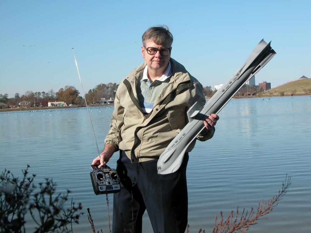

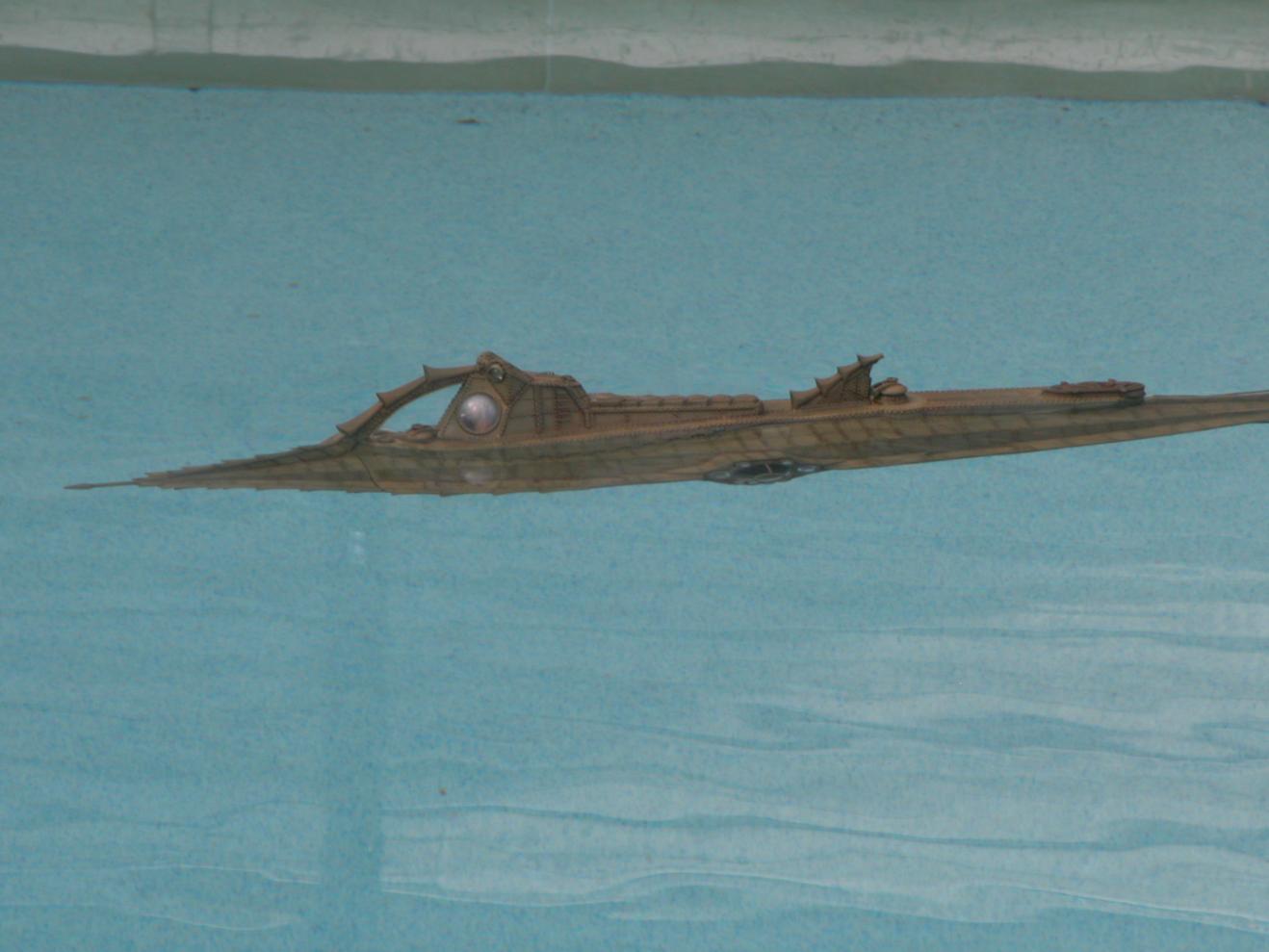

            The Teskey 24" Flying-Submarine is a fun boat. Thrusters forward and astern can turn the boat about it's vertical axis when dead in the water. Turns like a pig if any way is on, but the boat is fast and assured about the pitch axis. Lots of fun, but a lot of pre and post mission tasks make this more than a casual-run-at-the lake toy. No... it does not fly! Idiot.

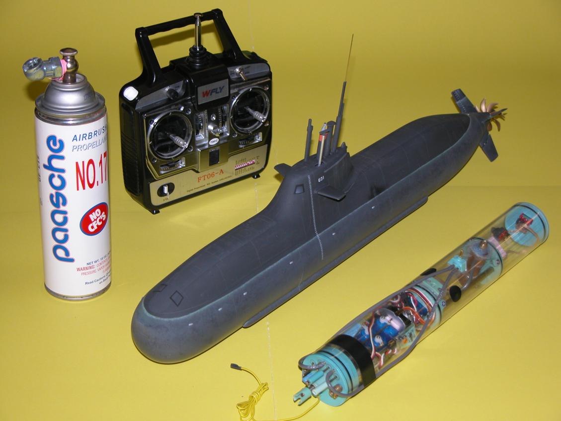

ID:	93164 The Copeland 1/96 OHIO runs very well above and below the surface. And with the right motor, very fast too. Depth control is OK, but you are always fighting the suction created between surface and big flat missile-deck when trying to maintain periscope depth. Just like the real thing.
            The 1/100 OTW VANGUARD is a surprisingly well turning boat both submerged and surfaced. Not typical with boats employing a pump-jet. Depth control is excellent, and the big size makes for a very stately boat at the pool or lake. I love bow planes on a boomer.
ID:	93161 Click image for larger version
ID:	93162 Click image for larger version

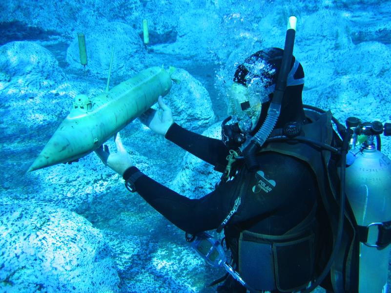

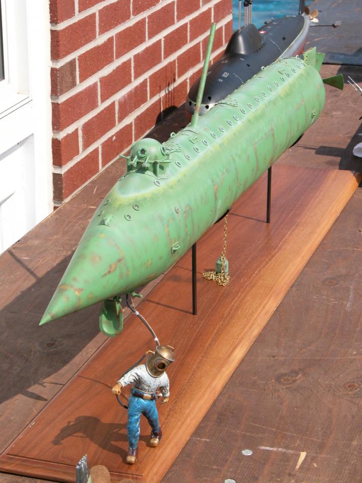

ID:	93163 Though commissioned and used as a practical effects miniatures, the 1/12 ALLIGATOR was found to be surprisingly easy to control in depth -- and this without the aid of ANY horizontal control surfaces. Like the HUNLEY, if you distribute the weight well down and work in a high center-of-buoyancy, static stability will keep the boat on an even keel when under way -- just as long as you keep the the boat below the critical speed. Above that speed and hydrodynamic unsymmetrical forces become greater than the static stabilizing force and you loose depth-control. Turned well, and never flubbed a rehearsal run or take for lack of control. We were able to hit the mark on cue each time. Got all our shots in within two days -- filming was at various water bodies at the David Taylor facility. It can be seen on the Discovery Science Channel every now and then.
            The 1/144 Trumpeter KILO is SMALL! Easy to transport. And a very nice kit, I love that they make the upper and lower hull portions separate equatorially at the waterline. Neat! Turns pretty good underwater, a total pig on the surface. Depth control is a joy for such a small critter. Very easy to maintain.

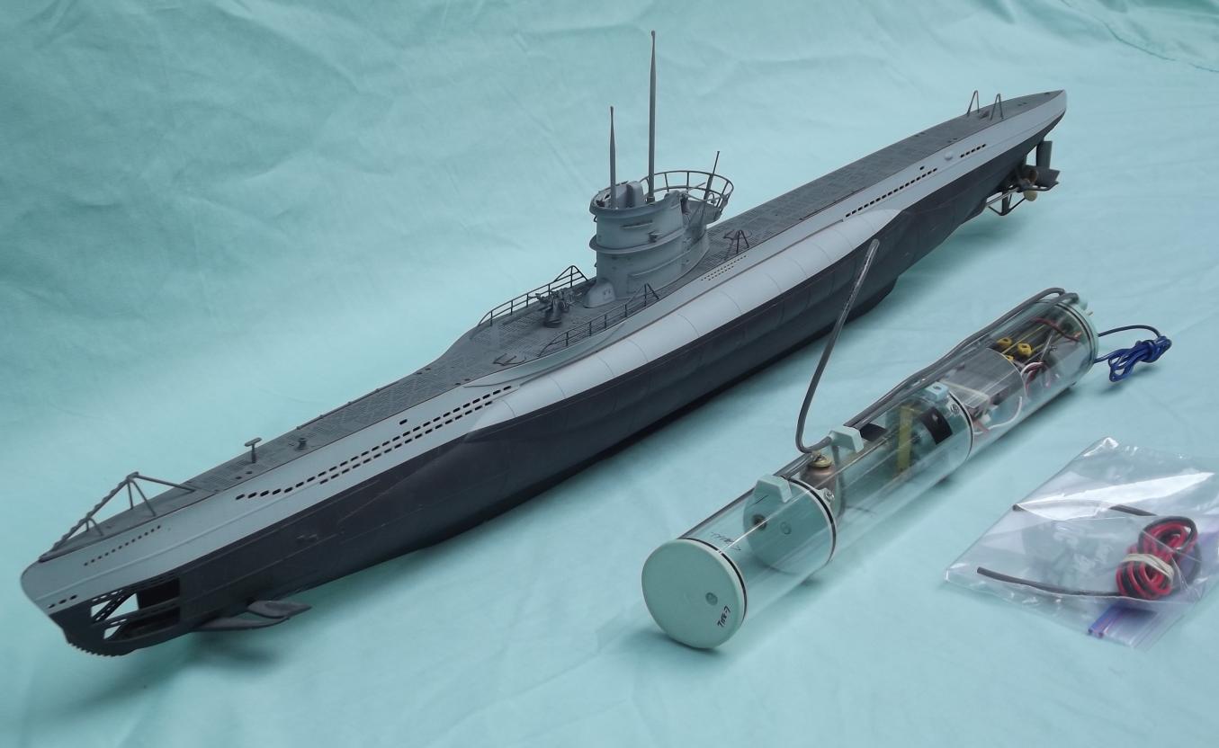

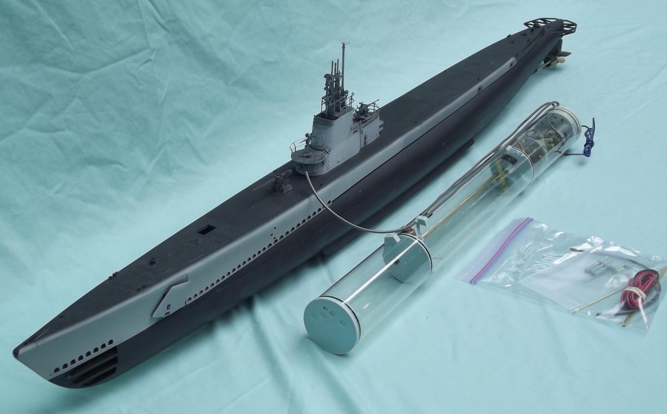

            The excellent Revell 1/72 GATO kit assembles quickly and is a fast turning, quick diving, easy to control scale model submarine. And nothing looks more sexy on the surface pulling a flank bell than an American diesel boat! A head-turner too. I love this thing! Plenty of room for torpedo tubes.

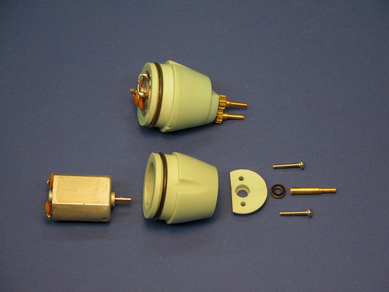

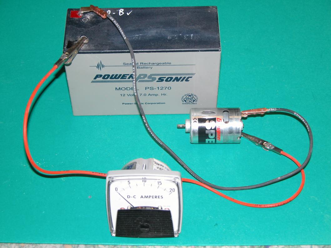

                  Your old wtc incorporated reduction gearing now all are mostly direct drive. Why the shift?
                  No. All our SD's are not mostly direct drive.
                  Only the SD's that power smaller r/c submarine models are direct drive. An old rule of thumb, put out by the German's, and I've found useful: if the propeller diameter is equal to or less than the motor can diameter, then it's OK to go direct drive. Through decades of practice I've found this to be true. And that's pretty much what drives my choice when I engineer a motor-bulkhead: will the motor can diameter be equal to, or exceed the diameter of the propeller/rotor its intended to drive? If so, I go direct drive. If not, I incorporate a 3:1 drive train.

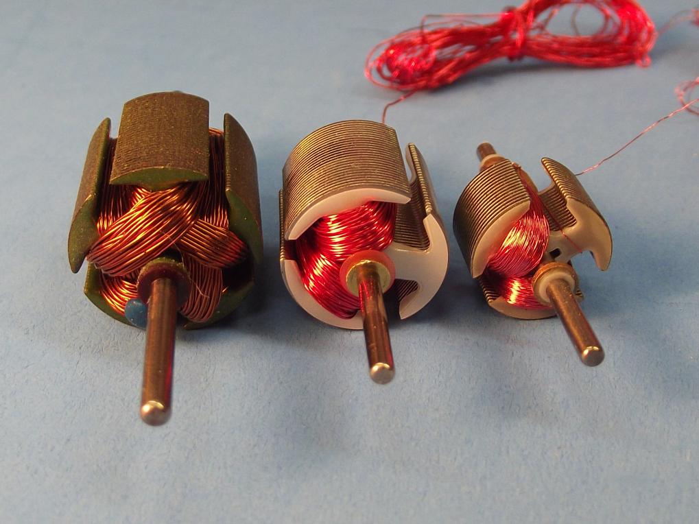

ID:	93178 I employ a bio-dynamometer to determine the torque of a candidate motor for a specific application: I simply hook the damned thing to a power supply putting out the correct voltage, slip on a pair of leather work gloves, and grab the shaft. If it burns my fingers, it's good for direct drive. If it don't, I need to gear it down to match the prop/rotor I want to spin. I measure the current draw at maximum load (usually I can get to a complete stall), nice to know stuff when later working out recommended battery capacity for a specific SD.

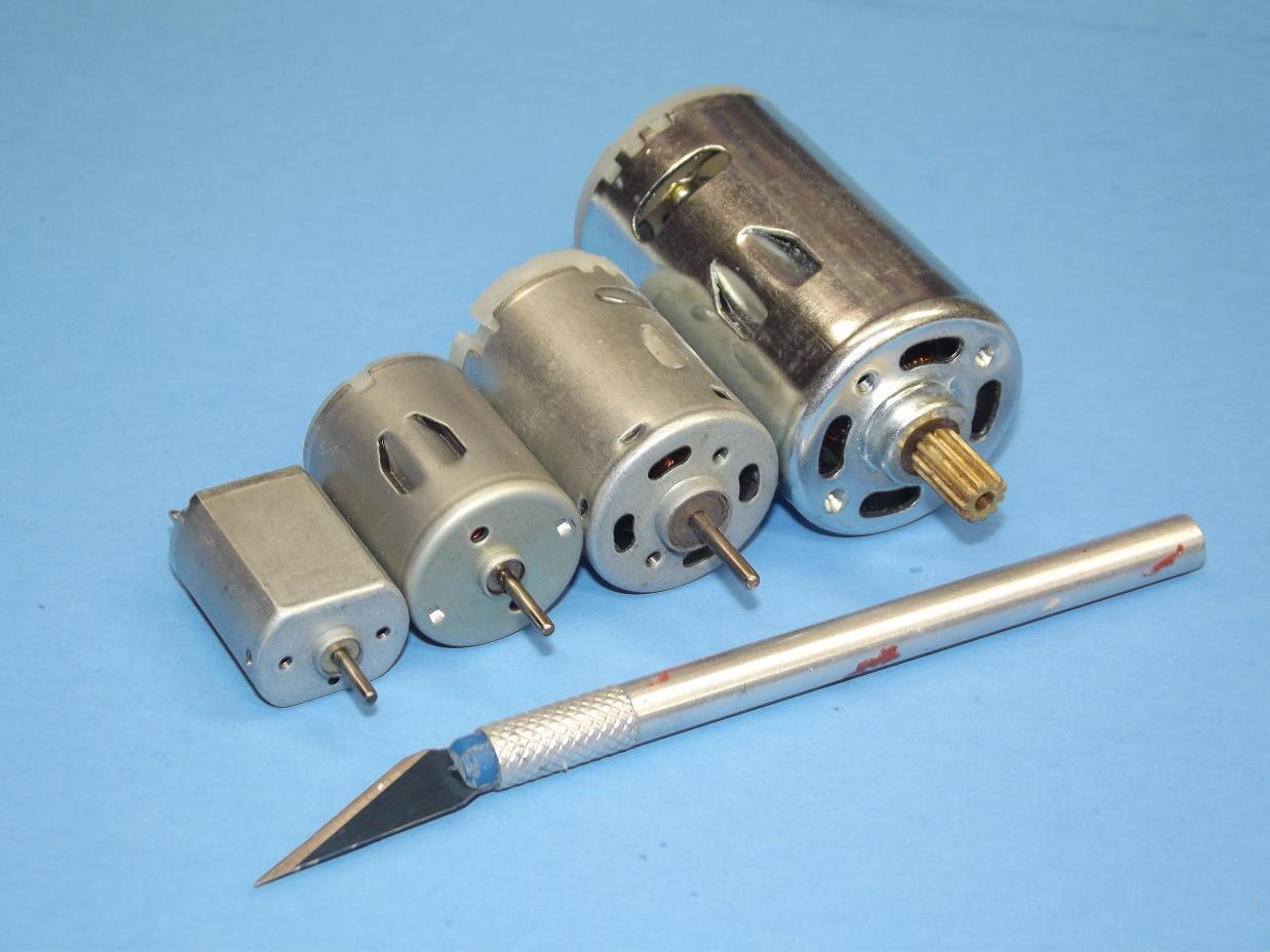

ID:	93179 The motors used in our line of SD's are pictured here. From left-to-right: 130, 6-volt, 265 turns; 280, 6-volt, 85 turns; 385, 12-volt, 40 turns; 550, 12-volt, 25 turns. All but the 550 are cheap-ass three-pole types. The kick-ass 550 has five-poles.

ID:	93180 Before Mike bought our motors (in bulk, to get significant price breaks) we were first presented with a wide selection of candidate motors by our Chinese source. Each size motor came in different flavors of turns and poles. After I performed the above 'test' to the candidate motors, and made my selection, I took 'em apart to work out number of poles, and number of turns per pole. Nice to know stuff. I then informed Mike of the choices, and he made the buys. A little inside-baseball for you, sports-fans!

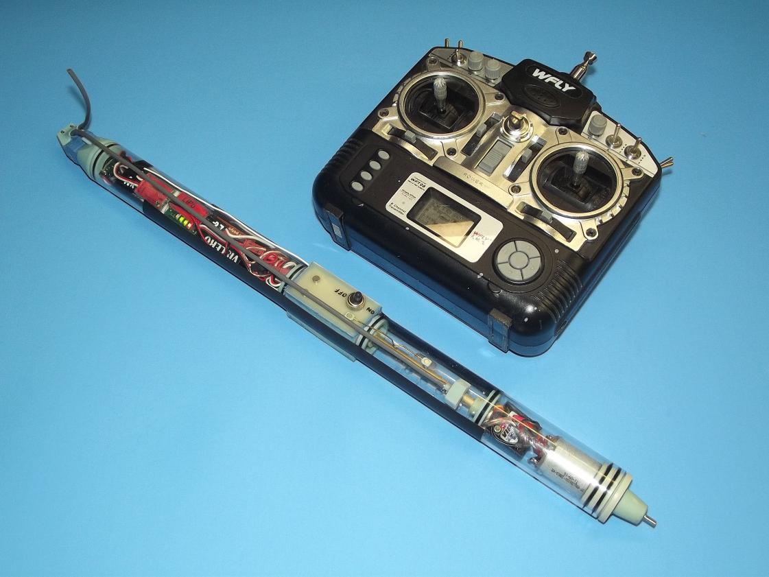

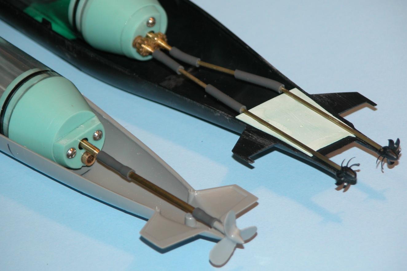

ID:	93183 Depending on the load the little 1.25" SD's either get the puny 130 or the substantial 280. As the cylinder is too small for anything but a planetary gear-train, these things are all direct-drive.

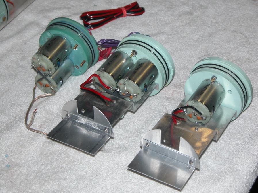

ID:	93186 Our slightly larger in diameter 2" SD's can take two 280 size motors, side by side. These direct drive power plants are fine for the 1/72 Type-7, and Moebius SEAVIEW models.

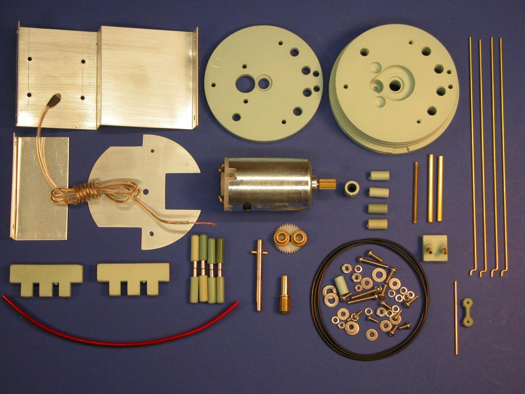

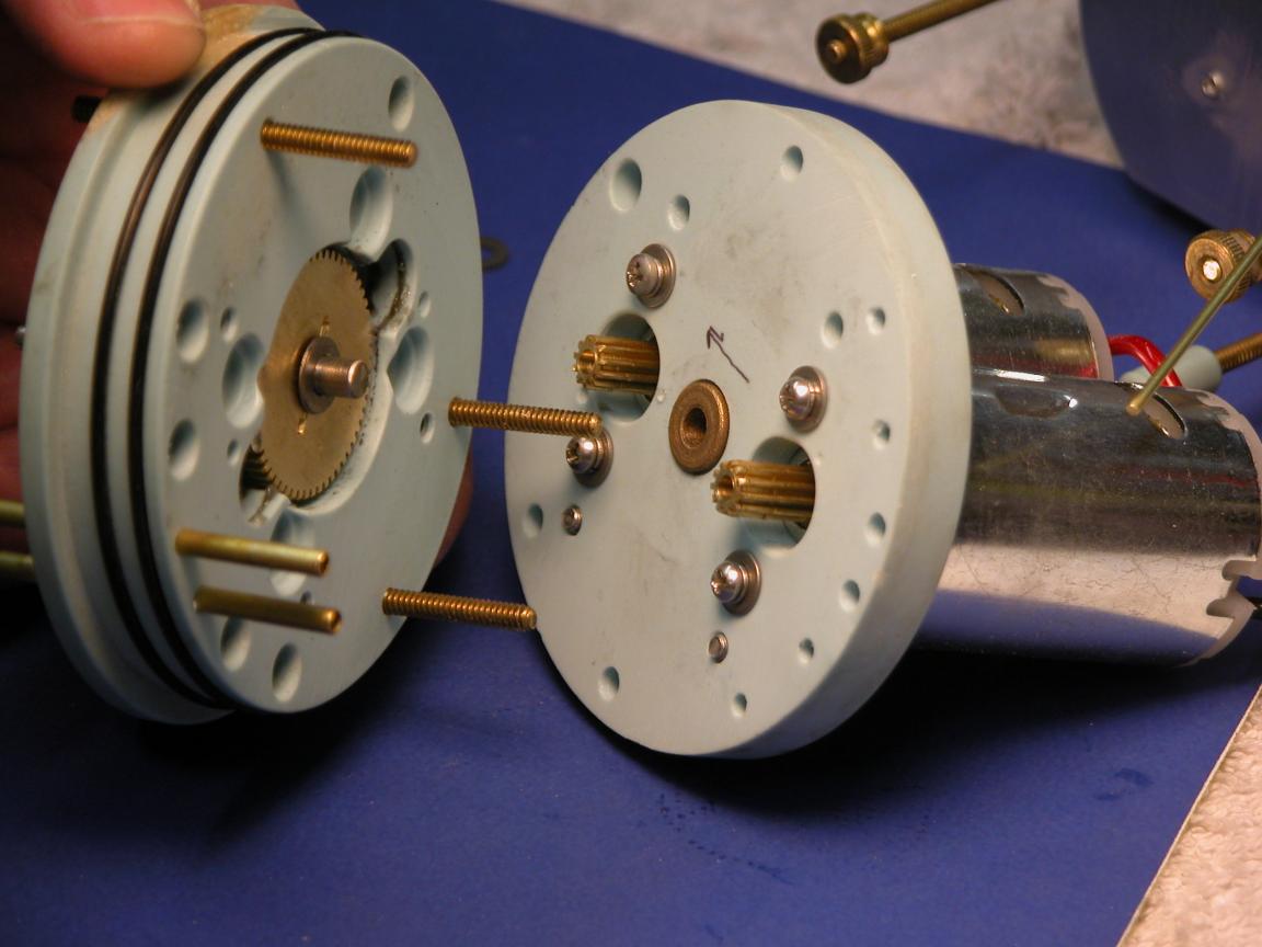

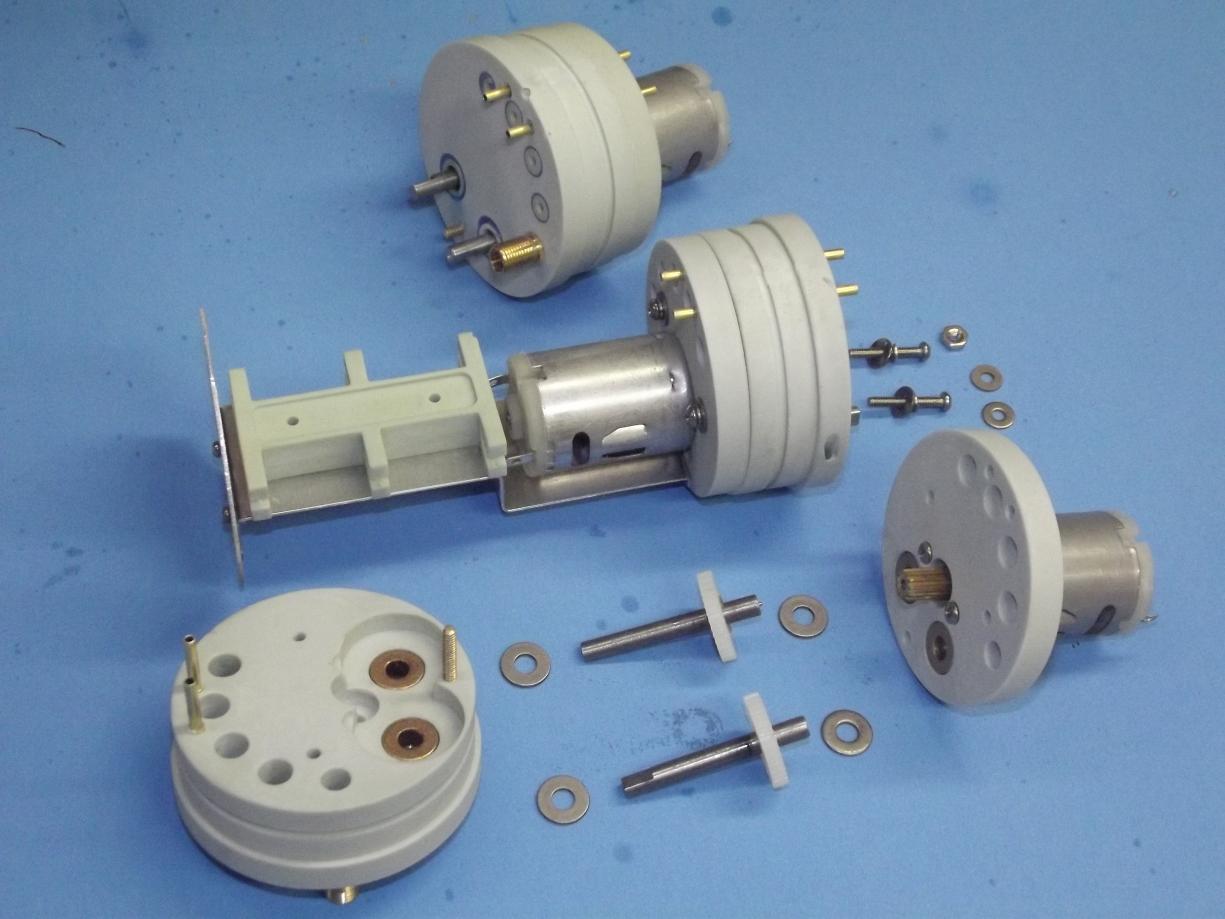

ID:	93188 There is just enough room in the 2" SD to incorporate a 3:1 gear train with one motor -- this unit recommended for the 33" Brodeen Disney NAUTILUS, but was designed for the SD intended to operate our 1/96 Type-212.
ID:	93189 Click image for larger version
ID:	93190 Almost all our 2.5" diameter SD's feature geared motors. The motor of choice here is the 385.

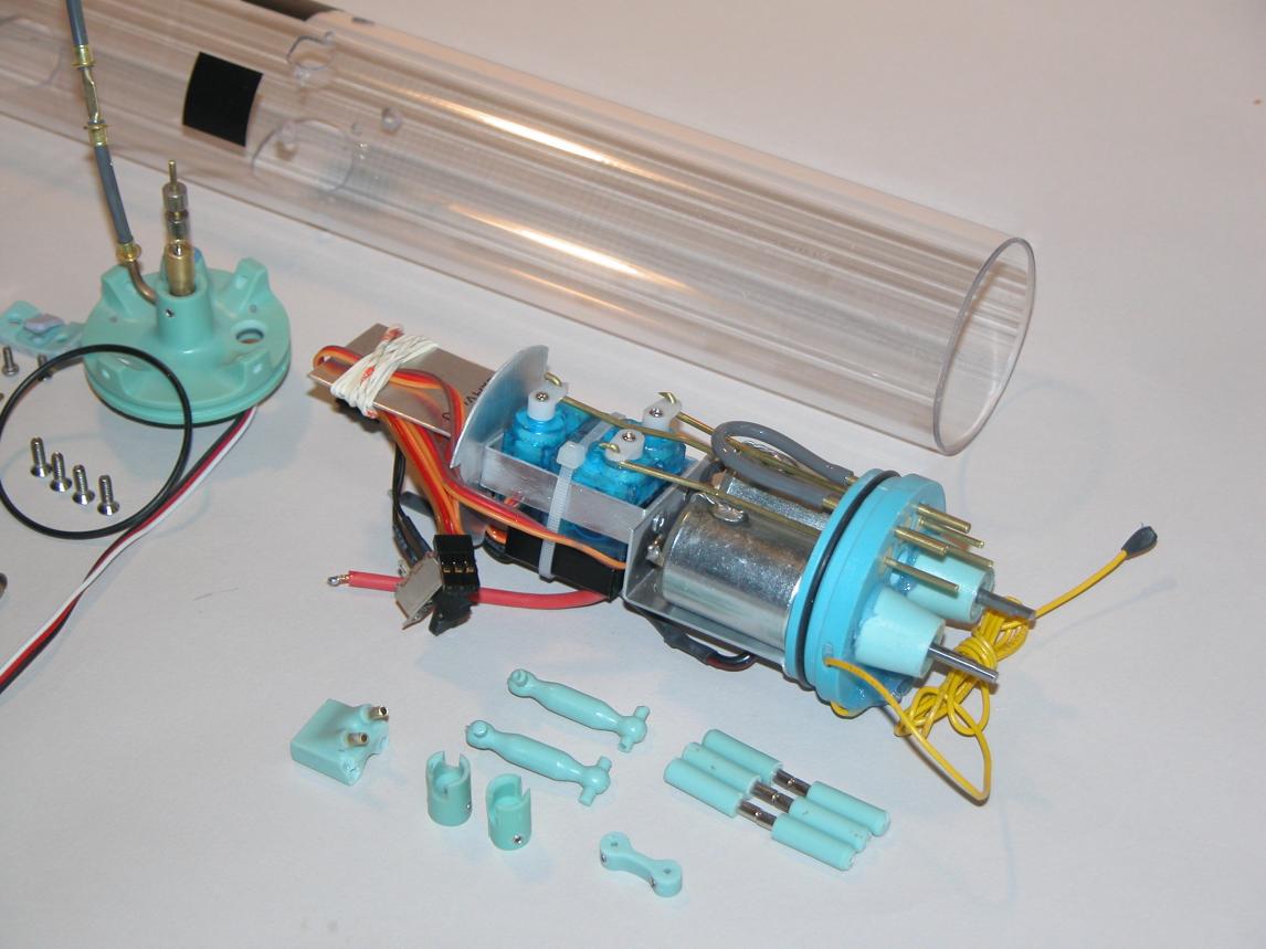

ID:	93192 One new development is using a single 380, geared 3:1 to two shafts -- this specifically for our new 2.5" diameter SD designed to drive the Revell 1/72 Type-9 kit.
ID:	93193 Click image for larger version
ID:	93194 Click image for larger version
ID:	93195 All our 3.5" diameter SD's make use of the kick-ass 550, geared 3:1.

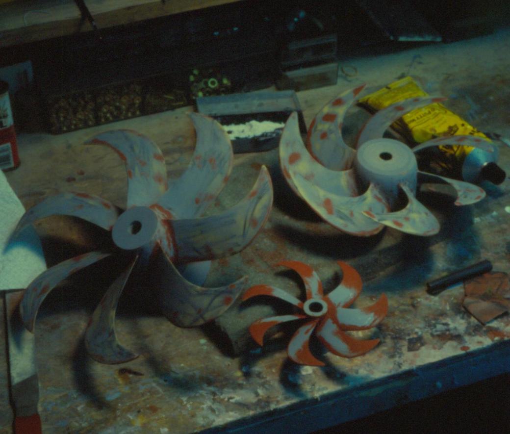

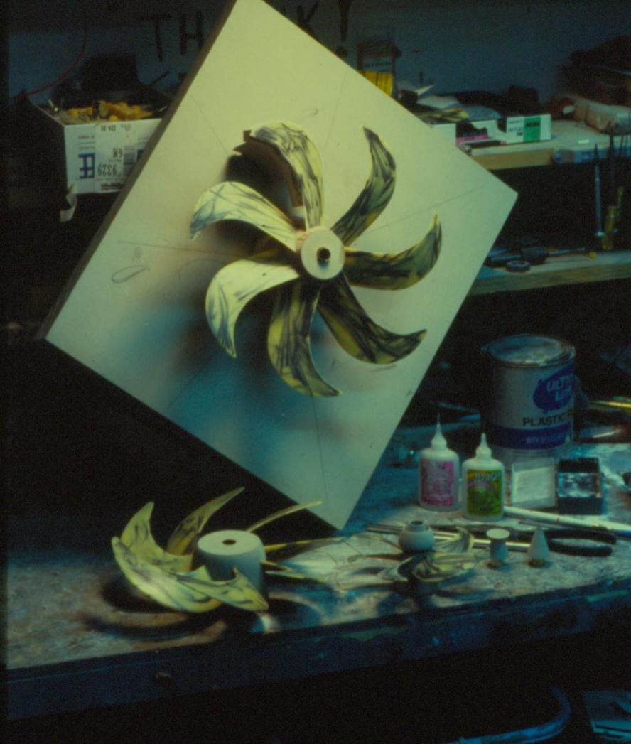

Name:	sf talk041.jpg
ID:	93196 Click image for larger version
Name:	sf talk042.jpg
ID:	93197 Yup, fixed them up with my drawings (updated from the initial r/c submarine effort). And I built masters for all the effects miniature submarine propellers. And design of the weapons, some insights on how the AKULA shutter doors worked, and some advice on submarine choreography.
                      I worked up some fictitious (BS) vortex attenuators for the OHIO class boat -- gotta keep the faith with my fellow bubble-heads. I think the Art-Director went with the bulbous one.
                      If you review the u/w shots of the OHIO class boat, sometimes the propeller is spinning clockwise, sometimes counter-clockwise when going ahead?!!! Lazy bastereds simply flopped the negative during the editing to maintain continuiety during a scene. Yikes!
