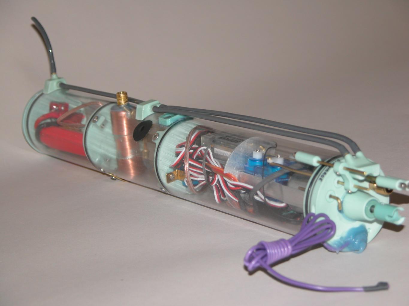

    As I posted before I acquired an unbuilt 1st generation RCABS wtc designed for the Revell 1/72 Type VII. It's composed of 2 6" length x 2" dia. clear tubing and a 3" length of 2.75" dia. section. The 2 6" sections are connected by a double ended endcap with a central cutout for the wires and tubings. My plan is to convert it into a gas/snort system. Want the scale waterline trim look.
    Can you please post photos of the Type vii wtc so i can get an idea how to fit everything inside the 6" sectio.

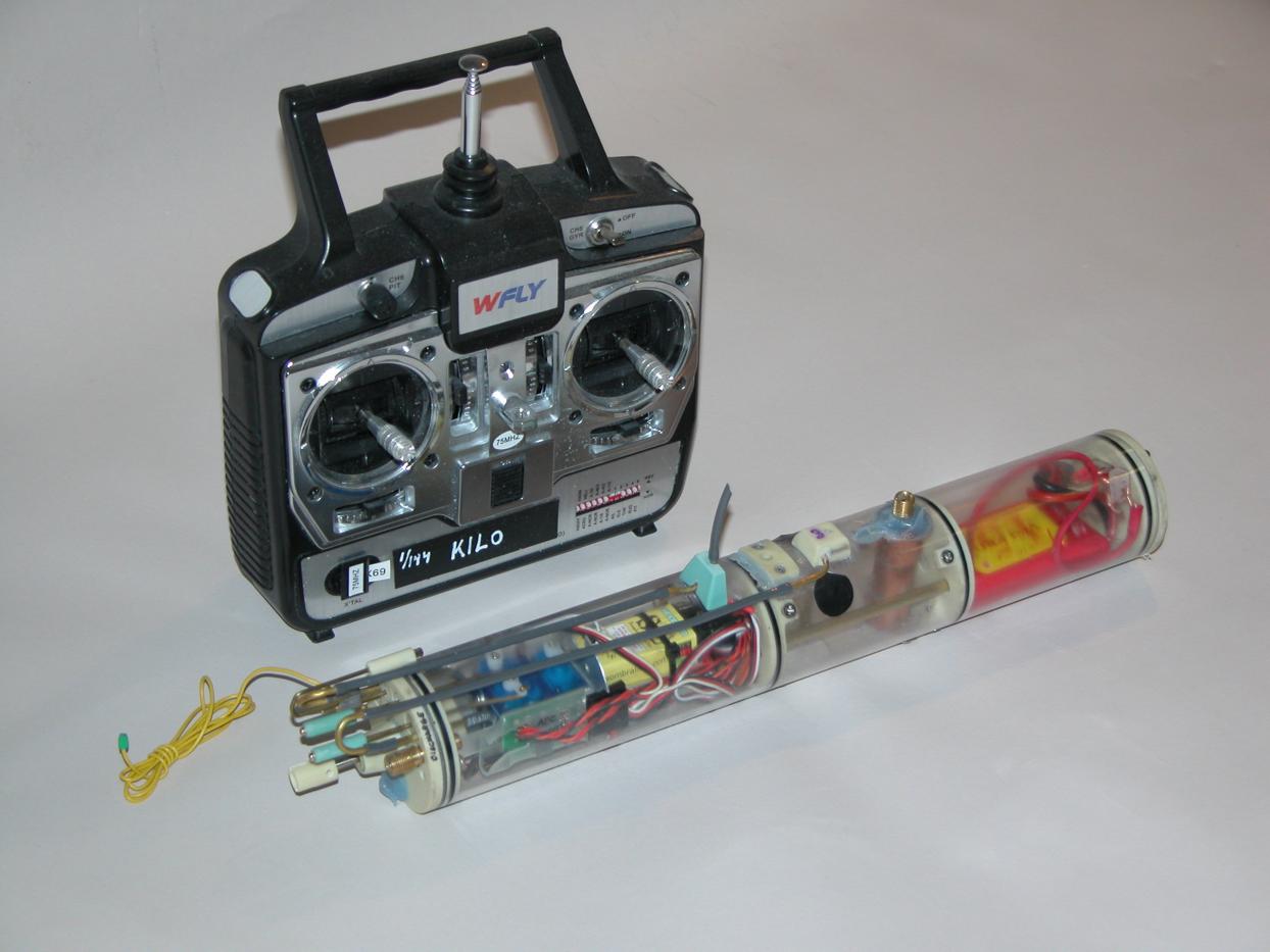

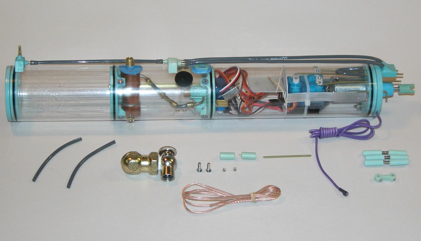

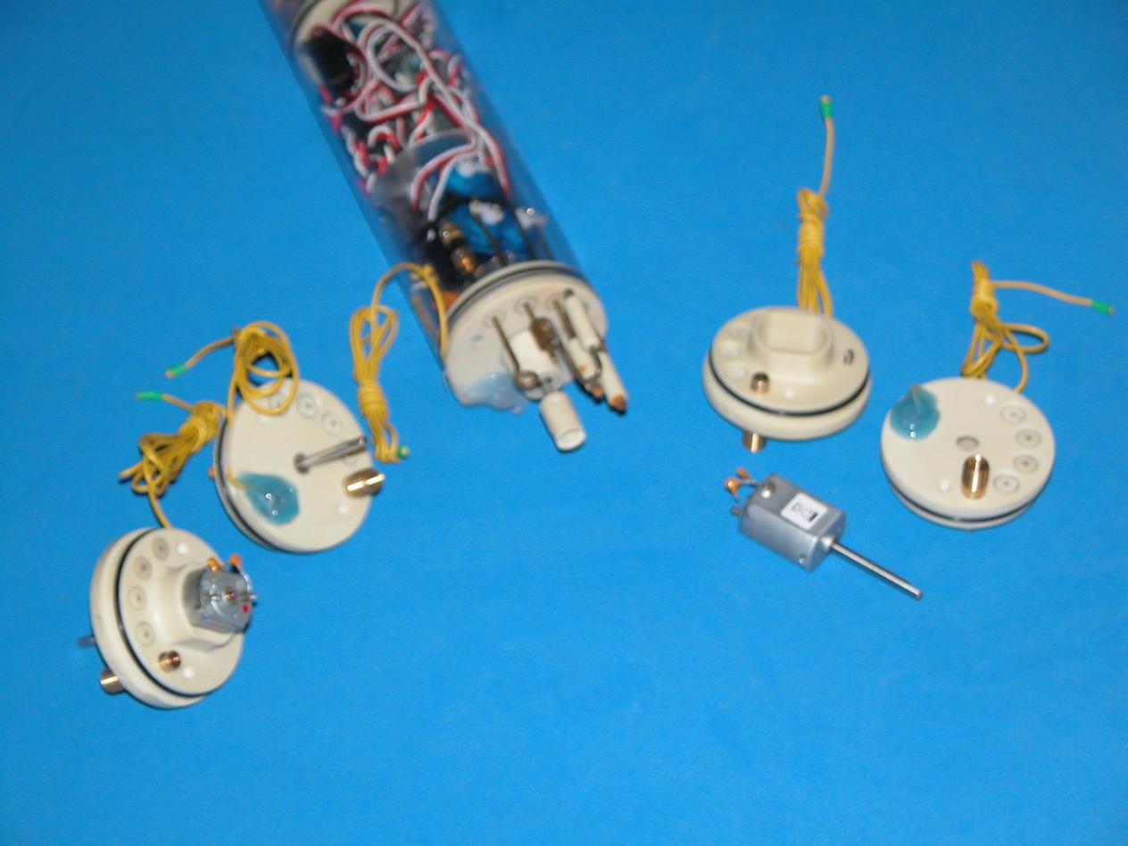

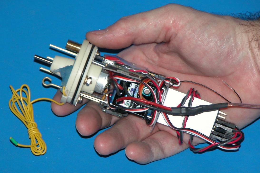

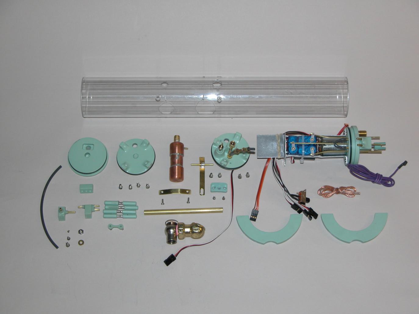

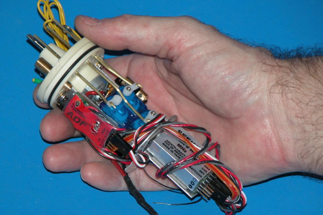

    So.... let me get this straight: you bought one of those POS 'experimenter's kit' WTC's from a competitor? And you want me to bail you out with instructions??
    BWAHAHAHA!!!!
    OK, I'm OK now.

    Wiping tears of laughter from my eyes.
    Next time, don't play it cheap. Play it smart.
      Think of it as consulting the great oracle...

            Geez!! That is one "kickass" SD!!
            Is that bad boy for the 1/144 Kilo?? (Which'll be my next build!)
            CG
              • 14014

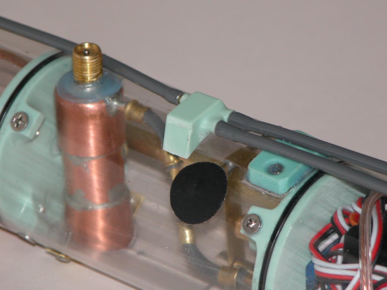

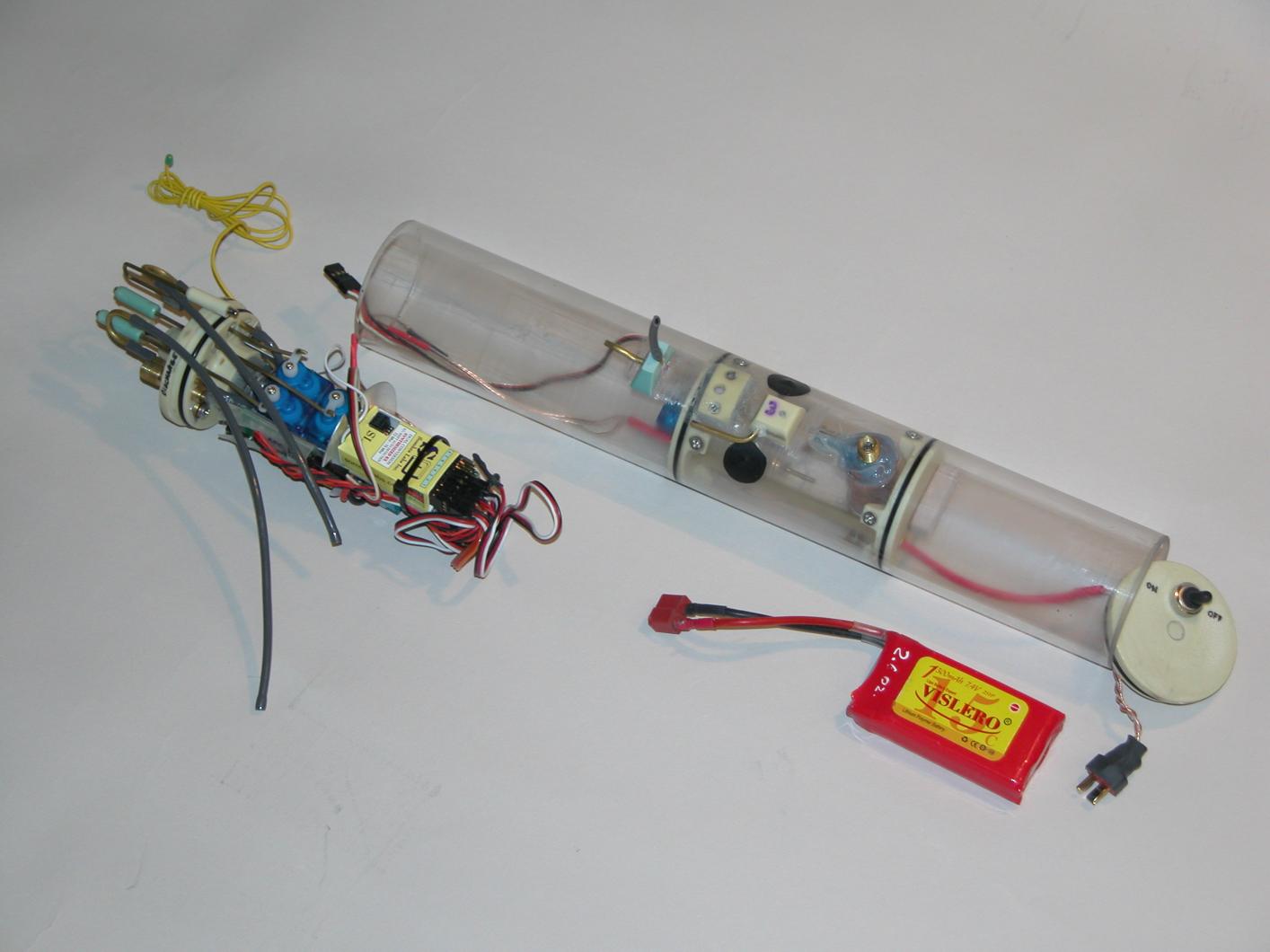

              What I presented were 1/144 SEAWOLF and 1/144 KILO 2" SD's. Only real difference between them is cylinder length, ballast tank volume, and motor size -- other than that they both are representative of typical device layout for that diameter cylinder.
              All SD's with the exception of the 1.25's and KILO's are SAS equipped.
