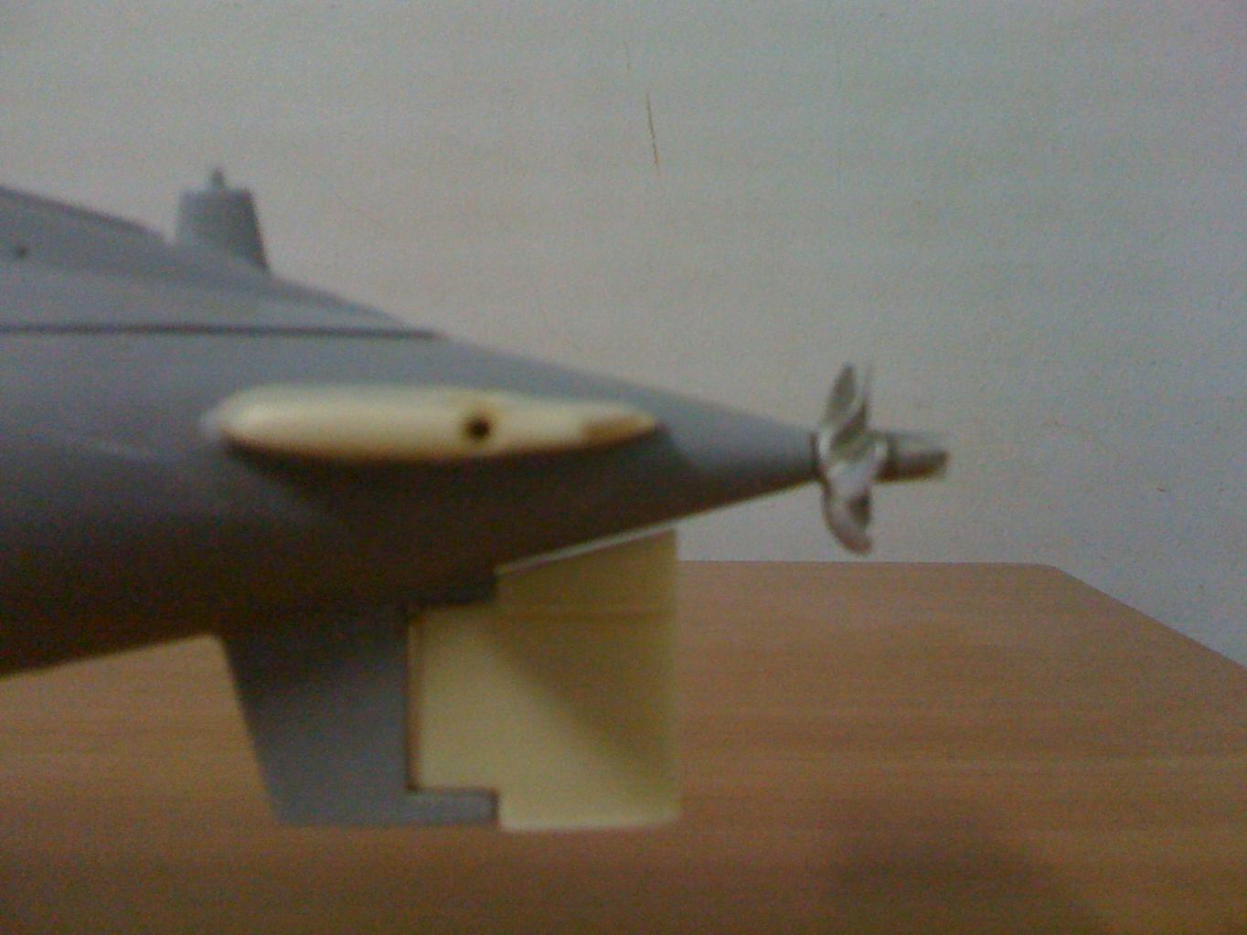

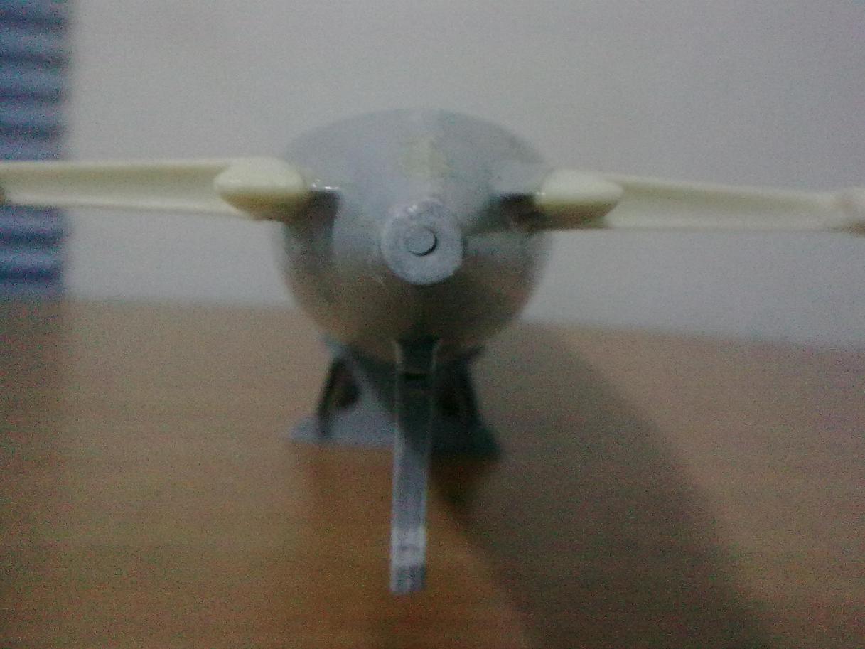

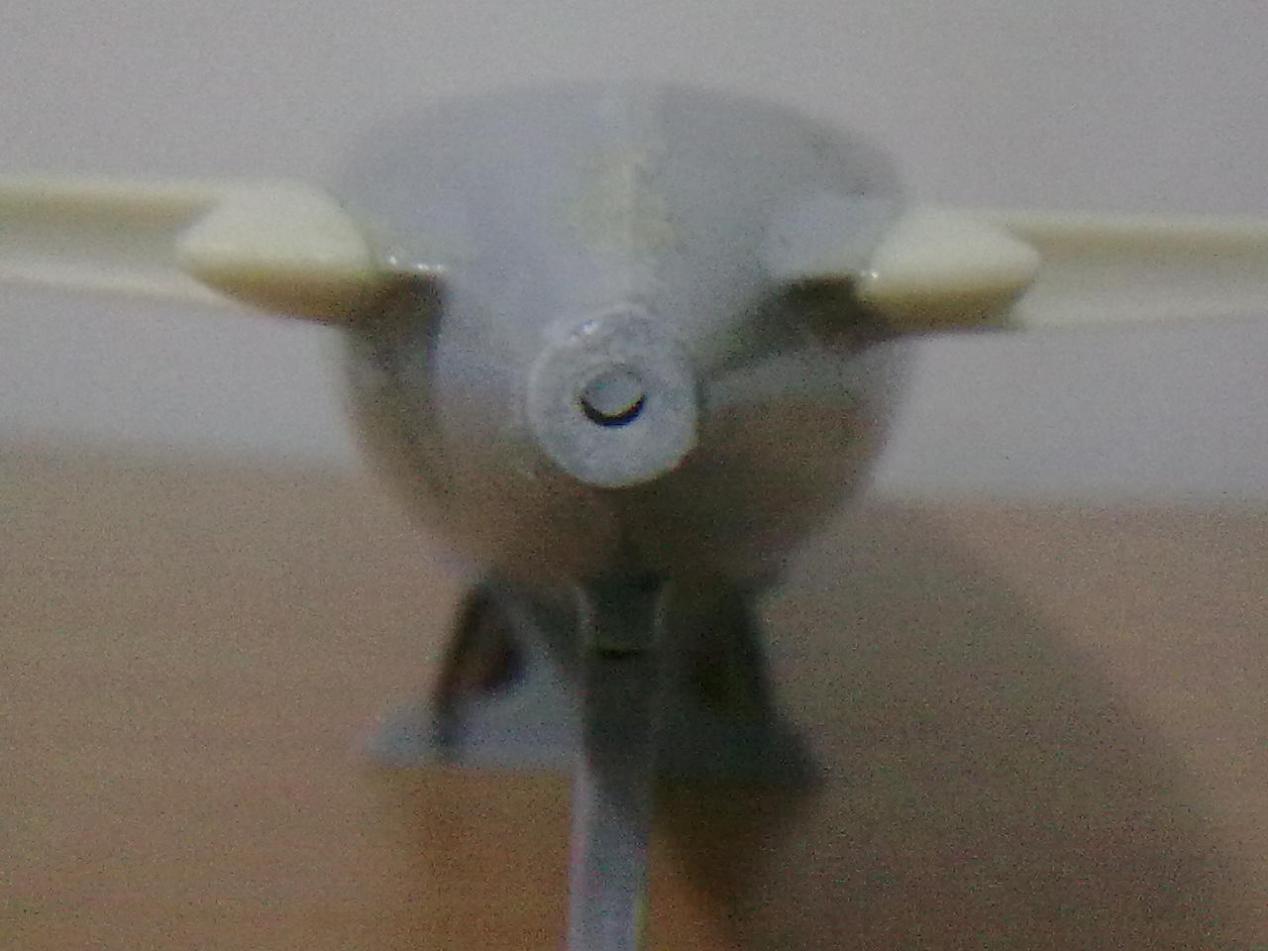

                There is one useful thing David forgot to include in his cabal report. It's about the stern cone. You'll need to cut off about 3mm from the tip (or you could just eyeball it to match the diameter of the propeller hub.) Next you plug the end with tape, stand the sub on it's tail and fill the inside with baking soda and CA to create a plug. You then drill it out using a 1/16" drill bit to accept your shaft.

                  Please excuse my ignorance but could you explain the 1/16" drill bit for the prop shaft? I didn`t know that there was a 1/16" prop shaft on the market for the kilo? Don`t you use a bearing in the end of the submarine for the prop shaft? How do you make sure the hole is centered there?
                  Thanks for the help.
                  George
                    The 1/16" shaft comes with the fittings kit for the kilo. Without the bearing/bushing the prop shaft has the tendency to wobble in the stern cone.
                    About making the hole centered I just eyeballed it. You could always replug it with Ca and redrill.
