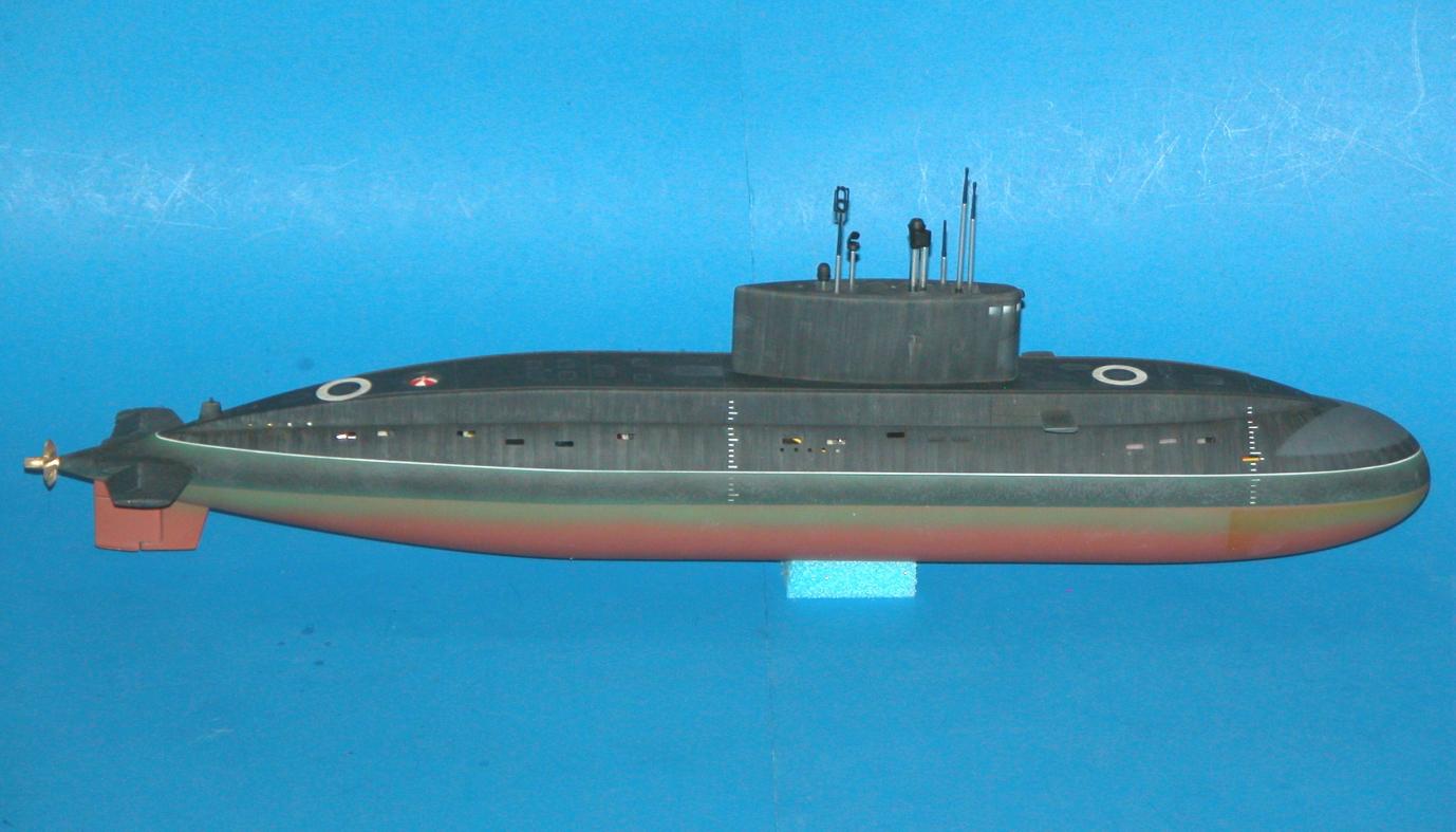

    I have a trumpeter 1/144 Kilo submarine that I want to turn into a static diving R.C submarine. My question, is there anyone out there who has a template / pattern of where to cut out the flood holes on this submarine, their location and size?
    Even pictures of one already done and working, from All sides, would help, as well as the flood hole sizes.

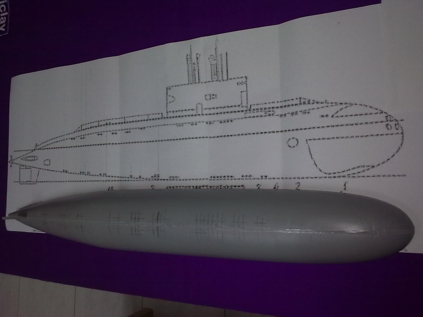

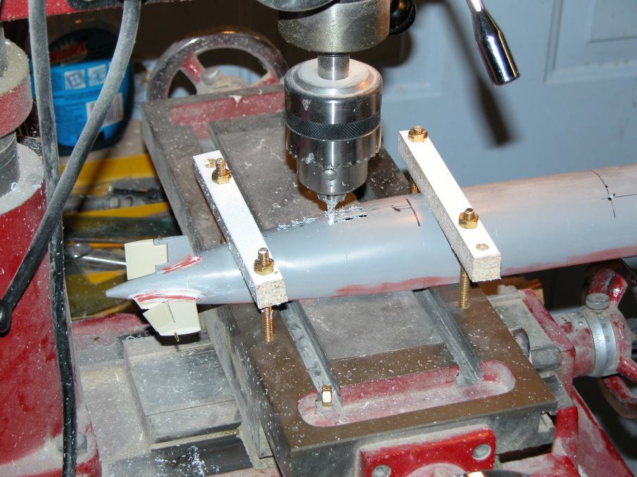

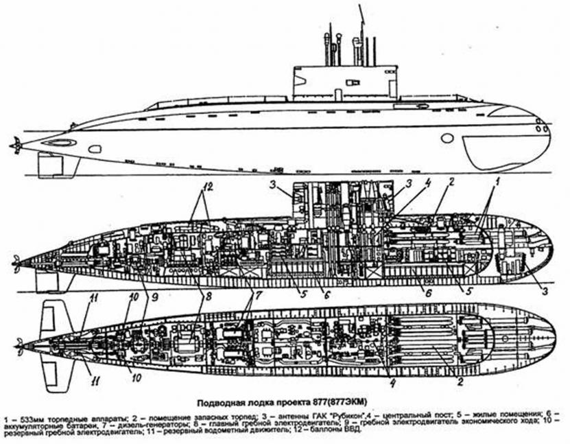

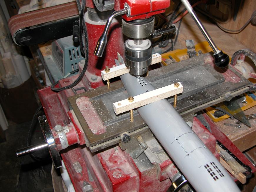

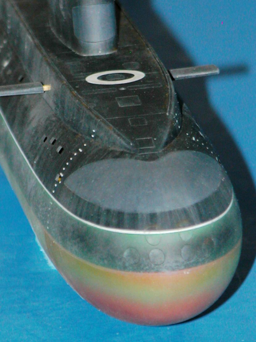

      I used a drawing of the Kilo I got from another site. Click image for larger version
Name:	Kilo Plans.jpg
      Printed it and had it enlarged to the same size as the model. Click image for larger version
Name:	Flood holes location.jpg

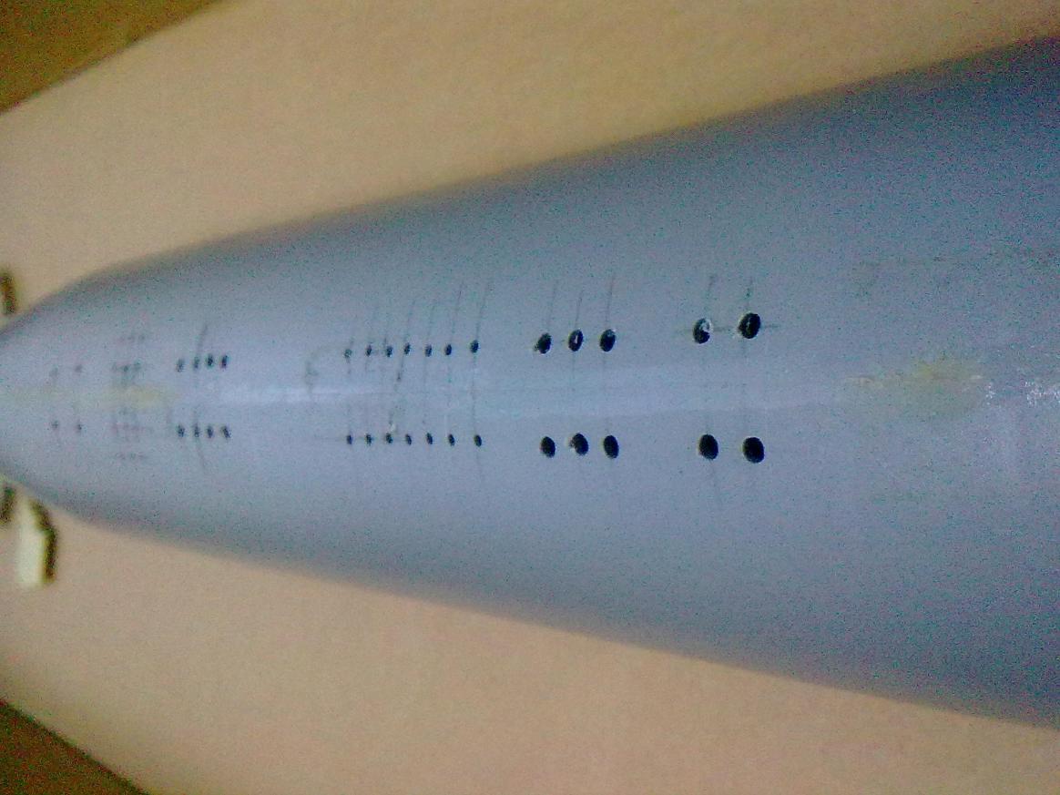

      I then aligned the hull with the drawing and marked out the locations of the flood holes. Click image for larger version
Name:	Flood Holes Drilled.jpg
      You may want to place your further out from the centerline.

        Thank you for your help. Can you tell me after you printed out the first plan, what enlargement Percentage did you use to get it to be the same size as the Kilo? If I understood your post, first just print out the plan you posted then enlarge it at a print shop???
        Please confirm and explain for "slow" person like me.
        Thanks
        George
          Yes print it out and have it enlarged by 206%.
