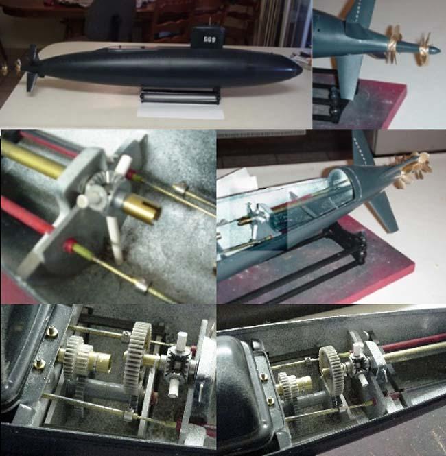

      Mark Greenman has contra-rotating props in his Albacore. Check out his build here http://forum.sub-driver.com/showthre...core-continued
      Or contact him.
        Is this it David?
Name:	Contra Rotating Prop A.JPG
          • 3758
          That is very cool Romel. Amazing work there David!
            • 13983
            Is this it David?
            [ATTACH=CONFIG]19934[/ATTACH]
            My propellers, not my transmittsion.

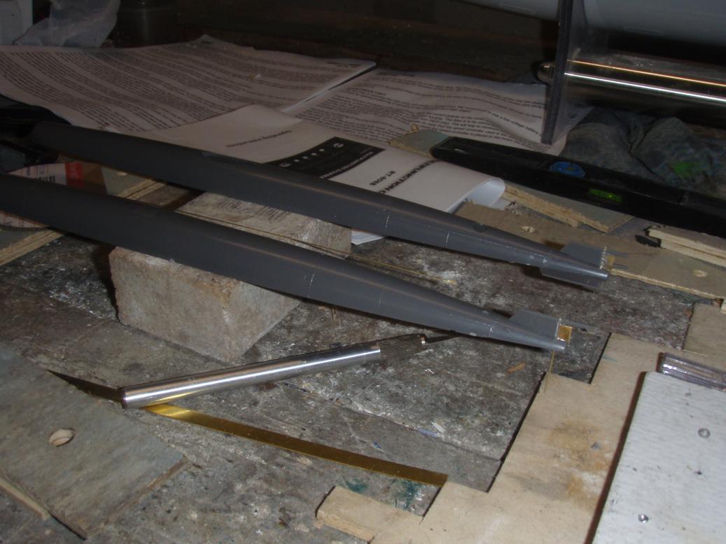

                Upper and lower hull with new rudders fitted. Working on the gearbox and thinking about WTC.

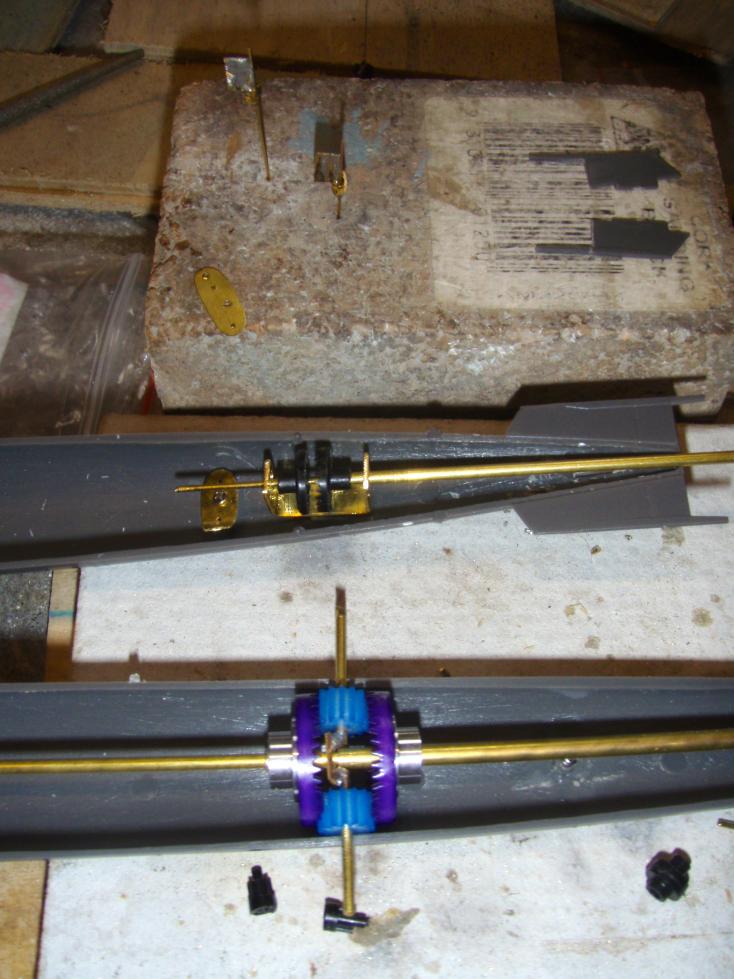

                    Yes I have. This guy has nailed the gearbox. I've been out today scouring the local shops for crown and pinion gears - found some really nice things in a slot car salon and some AFX bits and pieces. Having spent the day drilling .5 mm holes and such, I'm knackered. Photos tomorrow.
                      Gearbox options thus far. They both work, although the larger one takes up far too much room. Its the mighty midget for me!
                        I reckon this will be free running skimmer?
                          At the moment its a pile of junk on the work bench! I'm thinking of running three channels in it. Rudder, ESC and ballast but its very early yet and I only have a limited number of fingers to bash with the hammer. With any luck there will be enough space to fit in some sort of rudimentary syringe system that will allow it to ballast down to periscope depth and back up to normal surface trim.

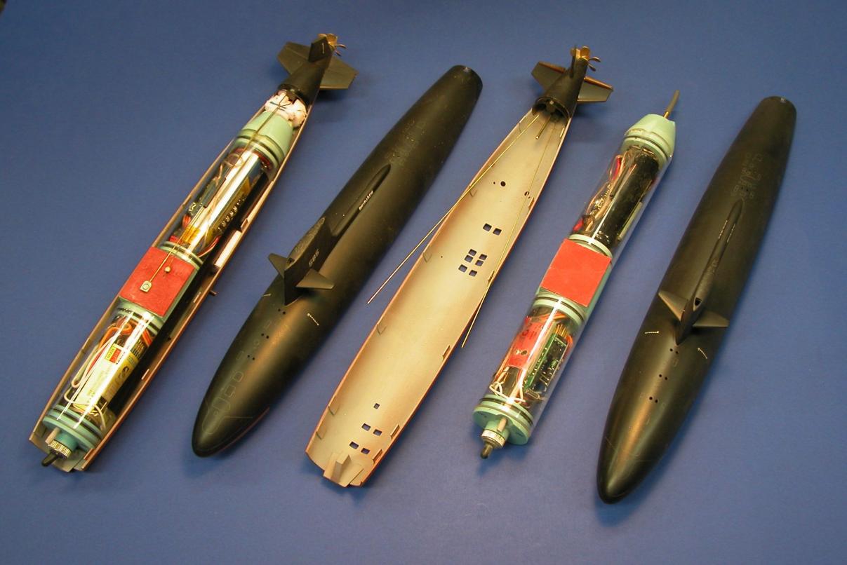

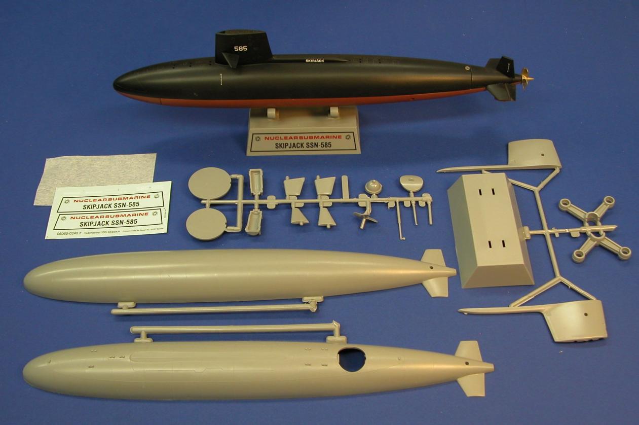

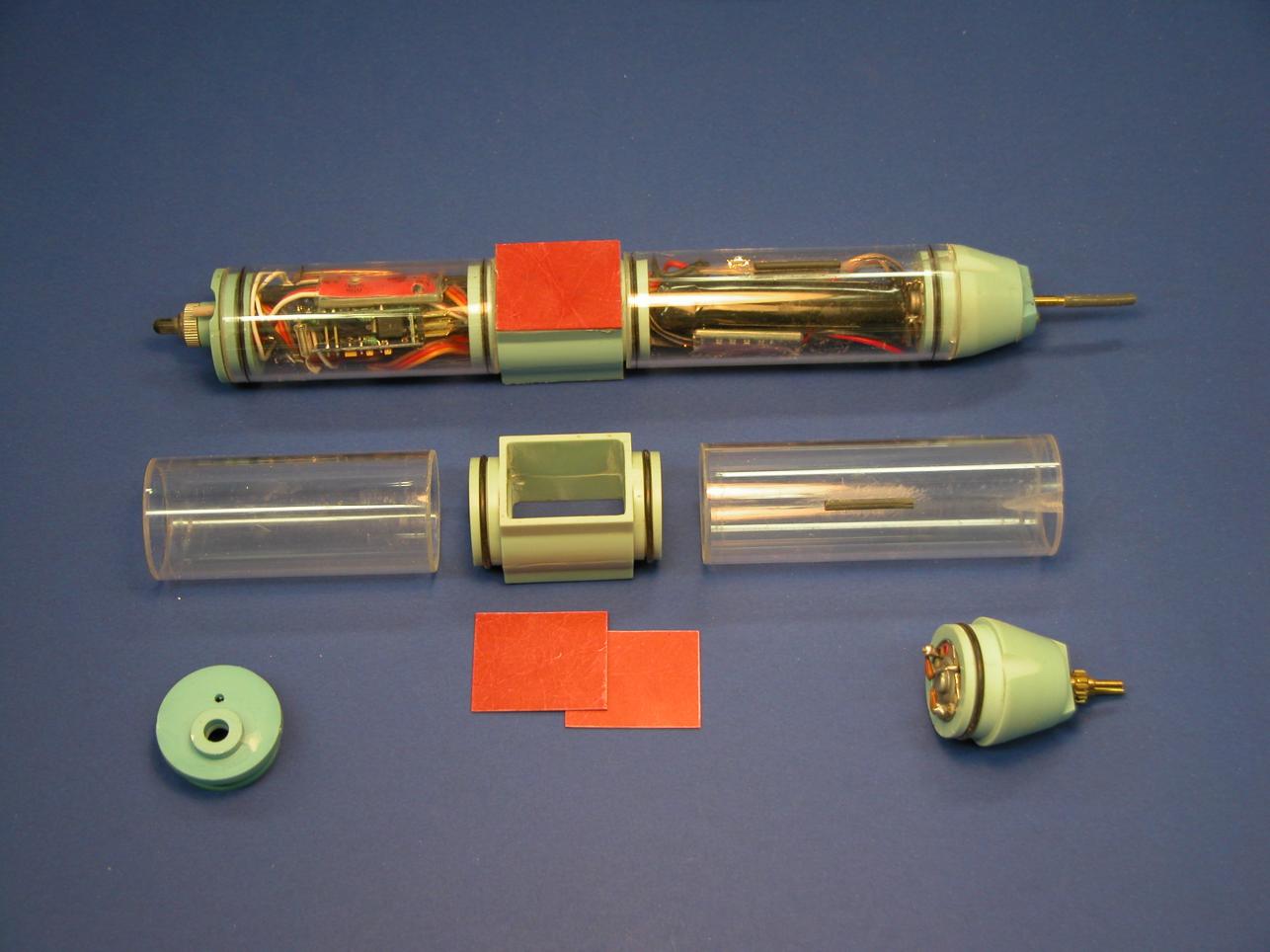

                            • 13983

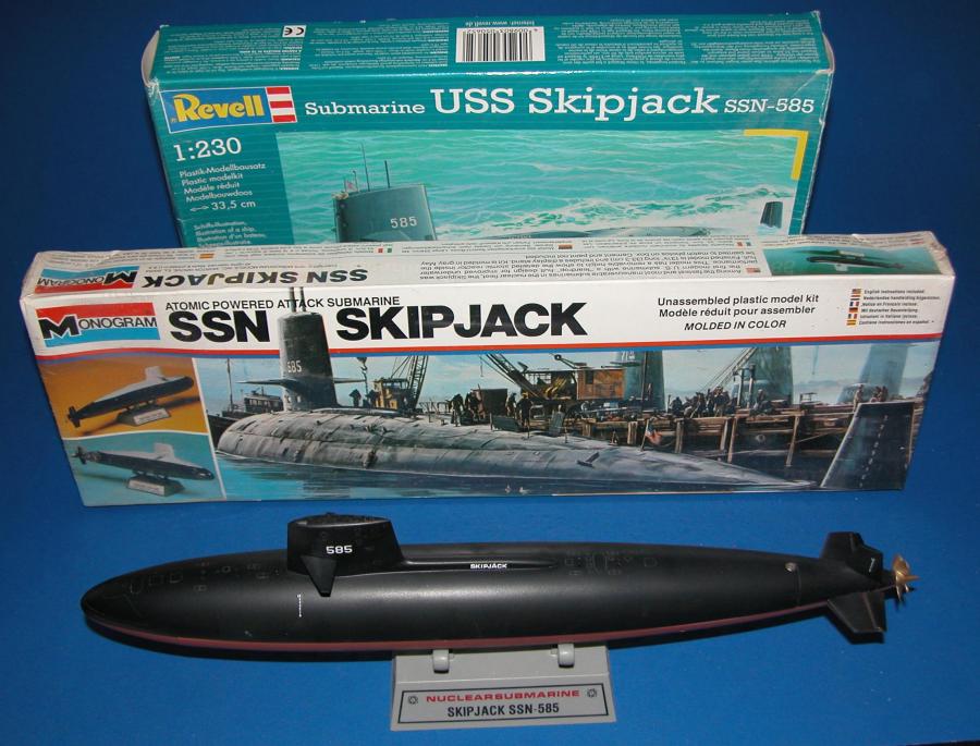

                            Use the three channels this way: ch-1, rudder; ch-2, stern planes; and ch-3, throttle. Trim the boat so that just the tip of the sail sticks into the air. Drive it dynamically in depth.
                            That's how I've configured the very successful 13" long Revell 1/230 SKIPJACK.
