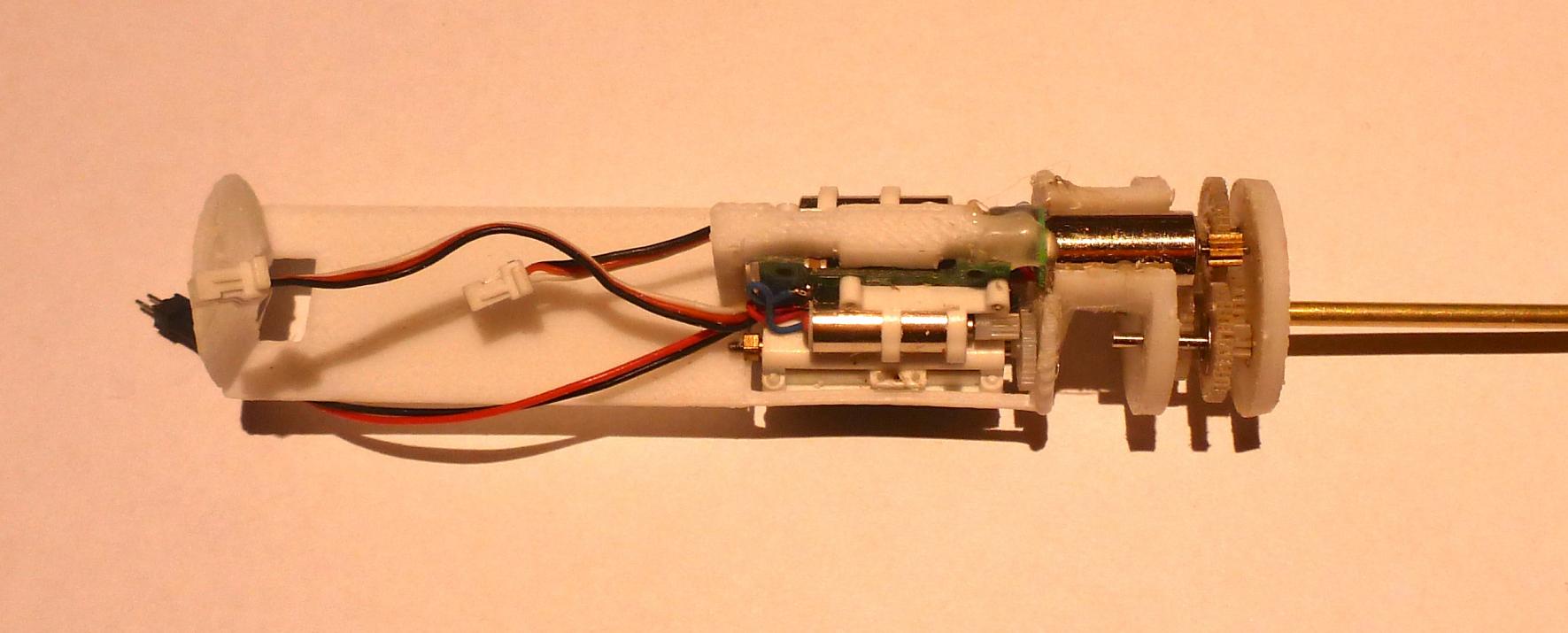

    New, more compact version of the contra rotating box. The original one worked quite well but it took up too much space. The new one uses an old set of servo gears and a pager motor and seems to be quite OK. Its mated to a small equipment tray that also mounts the two linear servos and will (eventually) have the receiver on top and the sped controller underneath.Click image for larger version

      Very, very slick work there. Keep at it!
