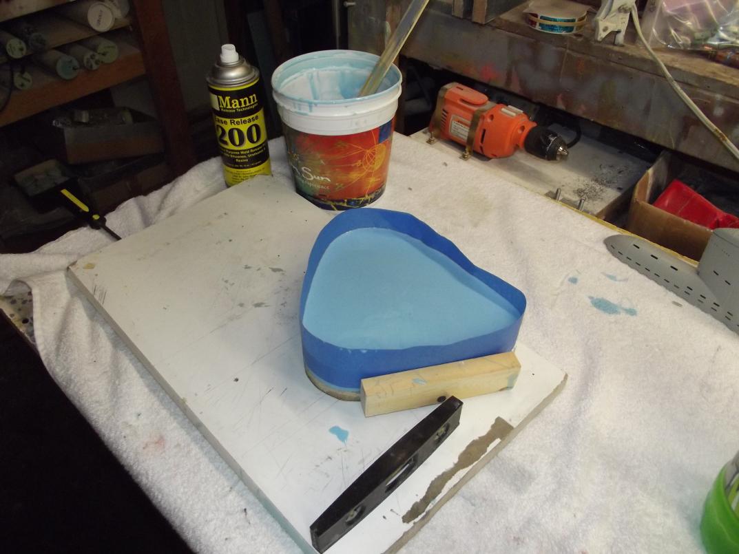

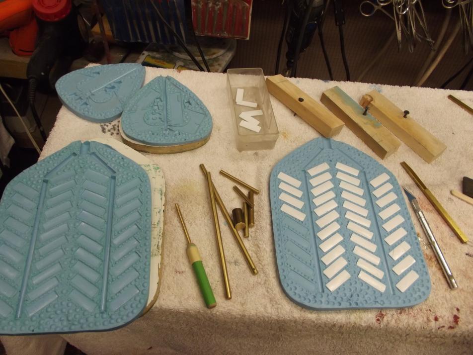

I'm getting desperate to wrap this epic job up! Got a few of the production tools done the last few days. These are formed from the harder mold making rubber -- this to insure accuracy as I cast up a set of production masters from each. The production masters, or copy masters, will be used to make multiple copies of the production tools. Time is everything in the shop, so if I can achieve three complete sets of parts per pour, then that's a money maker. More on the tooling later. This is as far as I got as of last Tuesday:

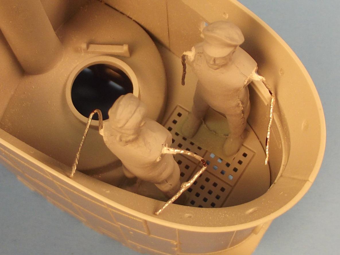

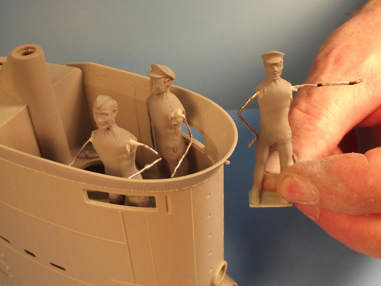

Four solid days of work on the figures and I can definitely say: I hate those ****ing NAZI's!!!!! Tomorrow should wrap up work on the three guys who go up into the bridge. "ALAAAAARM!!!!!!"

It's my sincerest hope that most of the Reich's navy were simply good German soldiers doing their National duty; and were not the goose-stepping idiots who knew of and/or practiced genocide. Yes, I know that's a conceit but I cling to it whenever the model work gets me up so close and personal with the subjects history as to force me to think of just what it is I'm representing here in model form. So: no Party salutes on my bridge. Ever. Nor will that battle ensign fly from the portable flag staff.
What my figures will depict are three guys in submarine cover-all's. One enlisted guy with his garrison cap, the CO with his dirty-white 'soft' peaked cap, and another officer with a dress peaked cap. The head-gear appropriate for a boat either returning or leaving port for operations.
Wish I had time for a deck-hand with heaving-line in hand, but I'm rushed to put this fittings kit to bed.

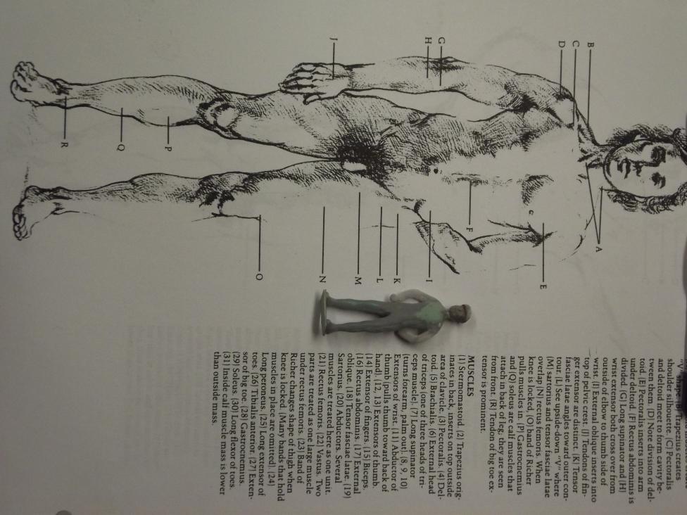

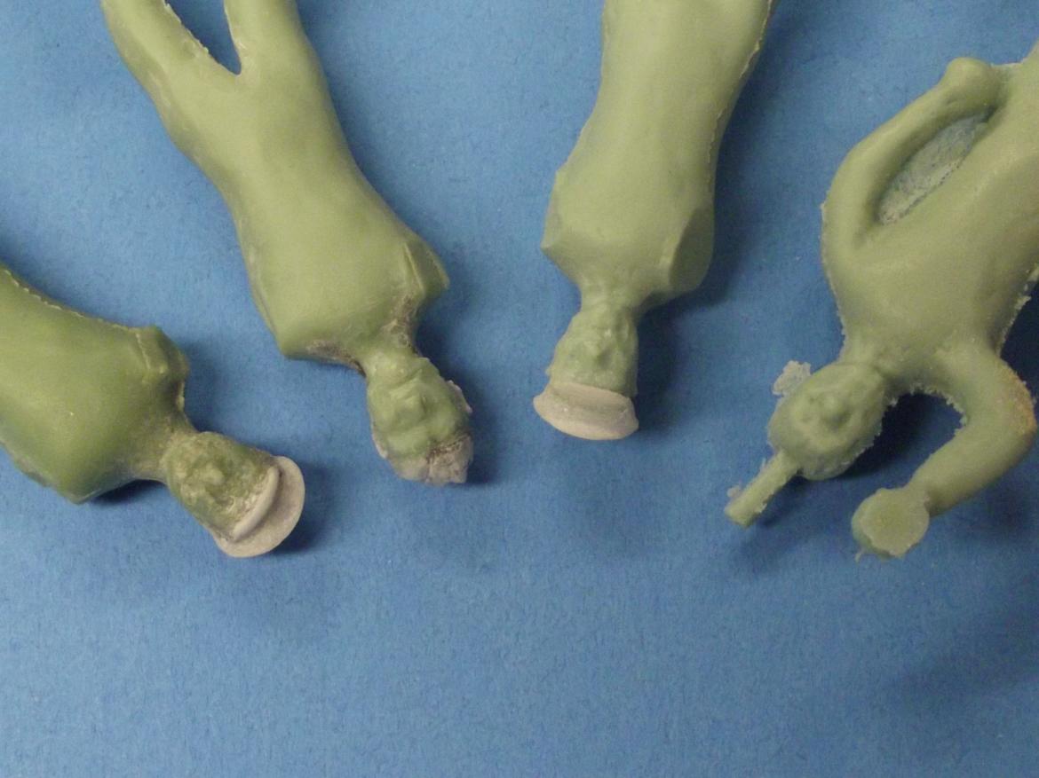

Nazi's! ... don't you just hate them. Especially me, after six hours on my butt working out the three bridge watch-standers -- masters from which I will make a tool to produce parts for the soon to be released Bronco 1/35 Type-23 fittings kit.
I cast up a bunch of blank 1/35 figures, selected three of them and chopped them up, gave them covers, and am finishing up posing them into realistic postures -- achieving a look like three guys up there who actually have things to do.

I see the propeller is coming along.. These white-metal props will need to be strong to withstand the months of rigorous patrol duty that my boats will eventually undergo. Remember to shape the "dunce-caps" using the "God Hub" images as a guide. The final motivation wheel part of this boat will be a masterpiece of craftmanship! The thrust performance it will provide shall be legendary.. After all, this is a fittings kit that is fit for a God, is it not?Though the BJB TC-5040 silicon mold-making rubber is not advertised for high-temperature work, I find, in a pinch (when I run out of TC-5050), that it will work fine with white-metal work. This evening I made some test shots with the tools, and they are holding up just fine.
Now to make some holding fixtures for the bell-cranks so I can drill and tap their set-screw holes. Time permitting I'll shape the propeller dunce-caps, bore and tap the set-screw holes, and work out how the production propeller shaft and bearings will go. Another long night/early morning ahead of me ...

In the past I would insert a stud of appropriate thread-cut in the tool to form the required bore, but that was too much work. With a holding fixture (designed to hold up to four pieces at a time) the work goes very quickly.Last edited by He Who Shall Not Be Named; 04-05-2013, 12:52 PM.Leave a comment:
